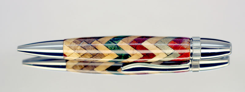

Does anyone have a process to make a pen like this? What is this even called? I really want to make this for the bottom half of an Indian blanket. I appreciate any help or guidance anyone can offer.

I believe there is a tutorial in the library on making a "herringbone" blank. That's about what your photo looks like. Then cut in half or fourths and alternate the pieces. Does that make sense?
actually I don't think that's a herringbone...
My thought: segment thin stock to look similar to the colorgrain type blanks at an angle, slice it into 4 parts and alternate the way they slant and glue that up. That should get you something like that blank.
Glue up 3/4 x 1/8th in strips 10-12 inches long. Shorter may work until you have a 10x5-6 inch block. set your miter gage on your saw to 15 degrees or what ever you like. That will cut the block on an angle. Decide on how many panels you want and divide that number into 360. Set your saw blade angle at that answer. Cut off the end waste, flip it end for end, front to back after each pass. Not left to right. glue up the wedges.
Right! Just as simple as that! :hypnotized: LOL
You could get pretty close to that pattern with a router....
I've done loads of zigzag designs with a small router in my toolpost and using the lathe as the indexer.
I reckon that the main tool used here was a decent tablesaw though.
I must admit that that actual pen does look pretty cool!! Any idea if it was someone here that made it? I'd like to see more of his/her work.

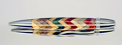

This is a 360 Herringbone.
It was a major pain to create the blank and scary to turn the pen because I had a few other blowouts.

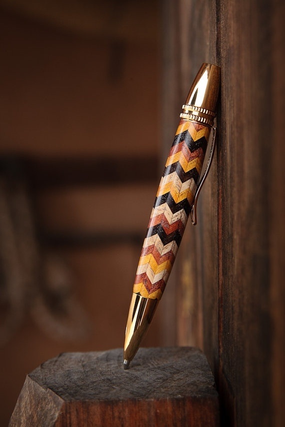

How do you usually do zig zags? I'm also trying to figure out how to make something along the lines of this.

Larry that's a great looking pen! I've looked into the herringbone but quickly looked out of it due to the difficulty and risks.
Do you have a method for doing that which doesn't involve those awesome tools that we wish we had? Using a band saw miter saw table saw etc...
Killer pen blank though.
Matt -- that appears to be 12 piece stave construction - a pretty standard segmented turning construction technique. The design is probably table saw based, but could have been done with a sliding miter saw. Some of the better segmented turners use the Festool sliding saw because of its tight tolerance. The thickness could have been quite a bit thicker to facilitate handling and gluing the staves, and would have been turned away. Could have been cut with a Byrnes precision saw too.
The strips are very well matched for thickness and the glueup is excellent. The meeting of the points is dependent on precision in the thickness and tight control of the glueup.
Tibbett's Book on segmented woodturning is a good starting point for staved segmentation.
