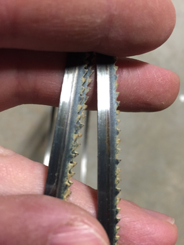

Most look and feel pretty good. Like this.

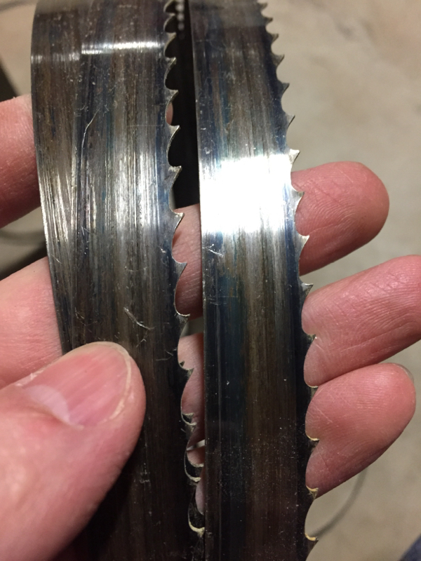

There are some like this second one that just look ok but have several similar size in good shape.

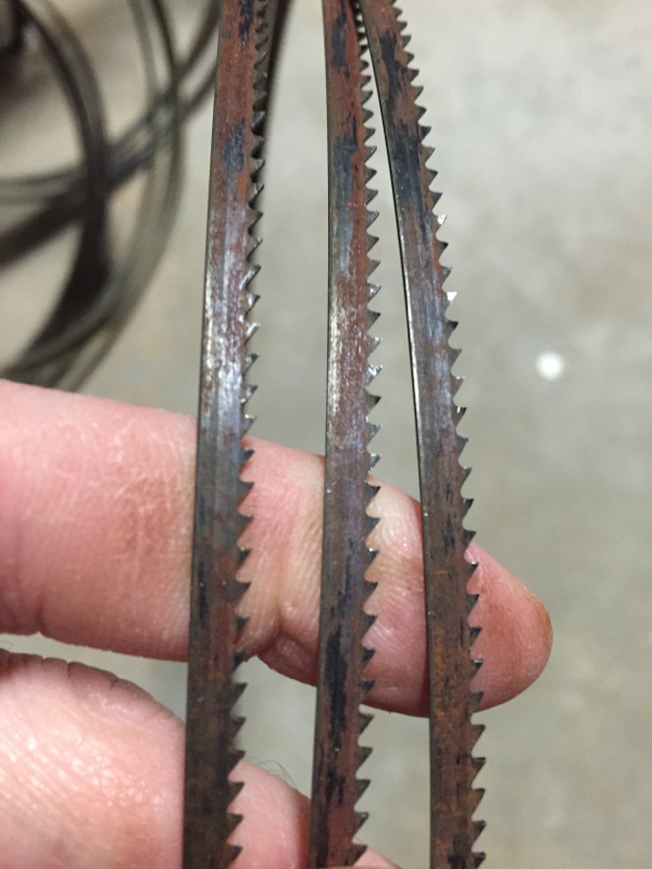

Then a couple like the third that have a little surface rust too so not sure about that.

None of those blades look new, far from it, the one with the least use is the one on the third pic but still, not that sharp.

Everyone of those blades you have shown are used. The ones on the right hand side photo look dull. The teeth should come to a point and those look rounded over. You can always have them sharpened. You would need a place that knows what they are doing though. The problem too is though it may cost more than new ones. Seperate the blades and use the ones you need and like others have said you will know if they are sharp after a few cuts. Now if you are rough cutting blanks so be it. They may do you well just the way they are.
