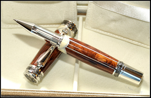

So I am on this site quite a bit and I see everyone but me making these segmented pents with what looks like metal accents. What is that? some kind of metal foil? Where can I get some?
Thanks
SSgt C.
This is not my pen but it shows what I want. Not the scalops but the silver lines.

The easiest and most common way to get the aluminum is to crack open a cold one. Most of what you see is aluminum from a soda can. Just cut it to size, sand the paint off, and glue it into place.
Ace Hardware here sells brass and "silver" door shims and kick panels. They are 5 inches wide and 12 inches long. Here, they are available in 5 thicknesses, from 1/32 inch and up. These are cheap, flat and easy to manipulate.
As Dean suggests, if you are not willing to spend the money on the shims, or have plenty of time, an aluminum beer or soda can will do in a pinch.
I prefer the look of brass dividers (and have better luck with brass staying glued to a variety of materials), but the aluminum ones look good, too. I always use ScotchBrite pads to rough up the surfaces before glue up.
If you use cans, you may also want to remove the interior coating before you glue it.

Yes!!! If you try cans, you must remove the protective layer from both the inside and out or there is NO way the glue up will work!
with all these diffrent metals are there any problems with turning them? I am thinking of using a 2 part apoxie to glue them in place. Anything else I need? What thickness would work the best or does it matter?
You can also use thin plastic sheet sold as guitar pick guard material. It comes in many colors and even banded colors (ie. black /white / black)

Since I made the pen you posted, perhaps it's best that I address the question for you. It has already been noted that just about anything can be used for accents, but if you're looking to use Brass or Aluminum you're better off walking away from the can option. I know others swear by it, but after many turns I just can't seem to keep a clean line with the can materials.
The pen in question uses a .025 thick sheet of aluminum purchased at Lowes for $7. You can also pick it up at The Home Depot or search Amazon...honestly; you can get this stuff anywhere, just do a search and find a thickness that works for you. When working with this material I'll sand both sides and use a Medium CA to secure it to the other materials. A note of caution...Aluminum likes to heat up and will break down the CA glue. As a result the bond may break so a clear 5 minute expoxy may be the best option. This is what I'm planning for my next series of pens to be safe (Thanks for the info Randall). Still finish the blank with CA, but bond with epoxy
Here's the link to my tutorial: http://www.penturners.org/forum/showthread.php?t=89931 I know you're more interested in the material, but the concept for the segmenting is the same when looking at the steps.
Feel free to PM me with any questions you might have and I'll be more than happy to help. From one SSG (Army) to another SSgt (Marine) I can square you away and make sure you're able to come up with something really cool looking.
Take care and best wishes...Happy New Year!
