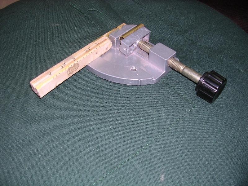

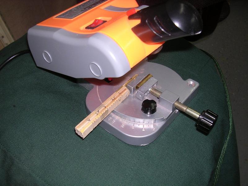

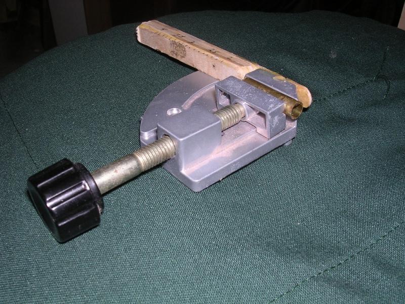

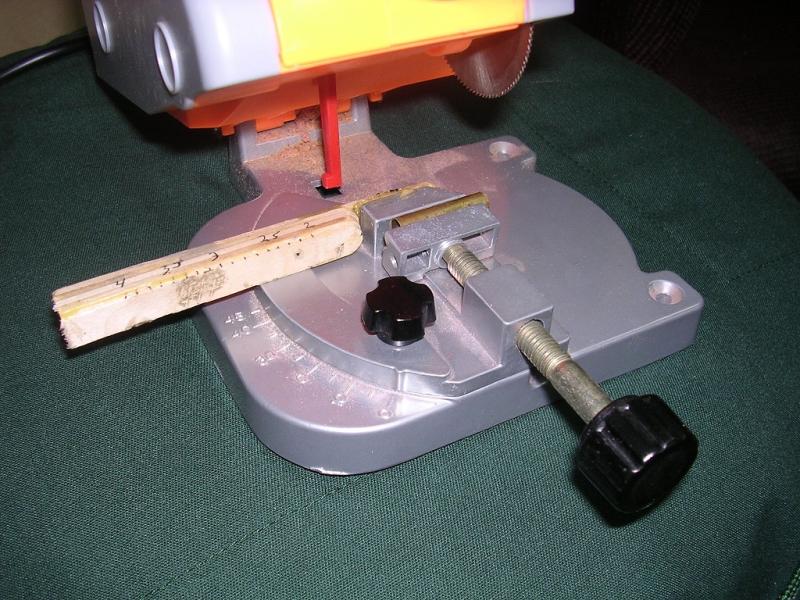

HF saw
I modified the little holder so I could make a more educated guess as to the length of the tube.
Took 4 popsicle sticks, epoxied them together and then epoxied that to the back of the clamp.
I put in one old tube and cut it off then removed the entire holder.
Thus i had the exact position of the blade and measured backwards.
This is a great idea!
