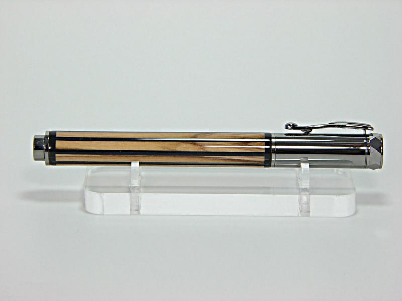

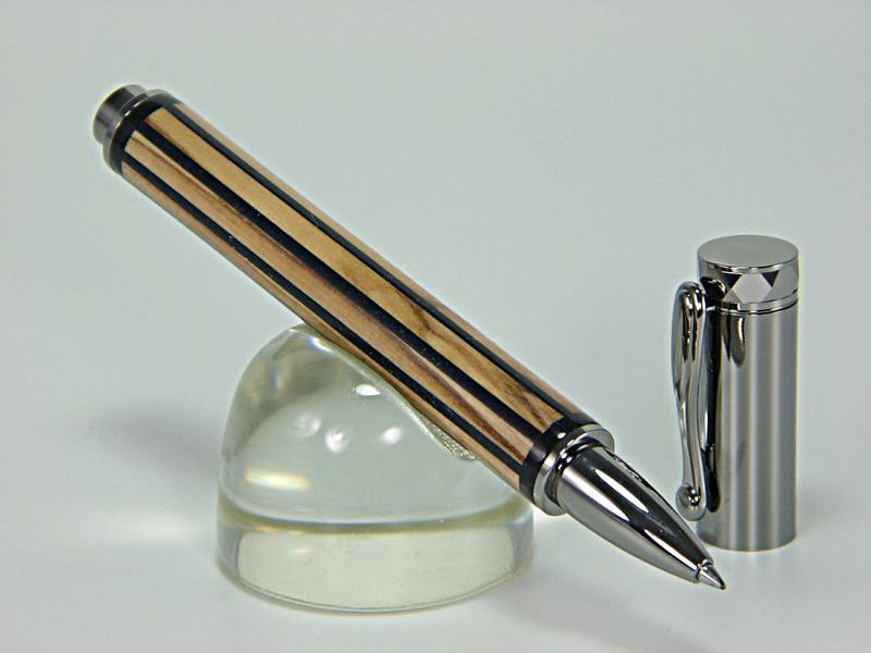

It is funny you ask this question because I just posted to Mark's post about a slew of Zen pens he made. In it I commented I made one Zen pen which has the magnetic cap. Here is the one I refer to. I was thinking of adding this type pen to my selling group but not sure how I feel about it. It was explained how the magnet works and yes this pen is postable. The problem I see with it is the cap moves and when it is put in the pocket I am afraid the cap will come off. Still not sure how I feel about them but then again I have not really put it through its paces enough.
