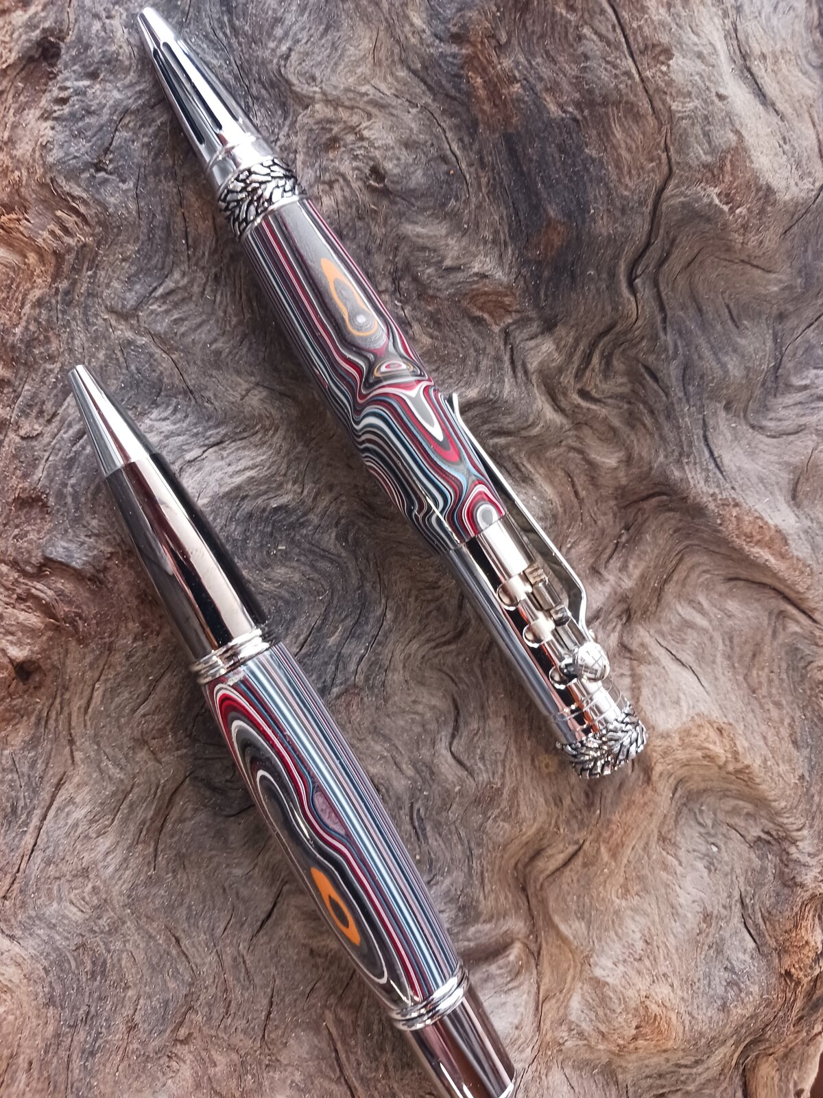

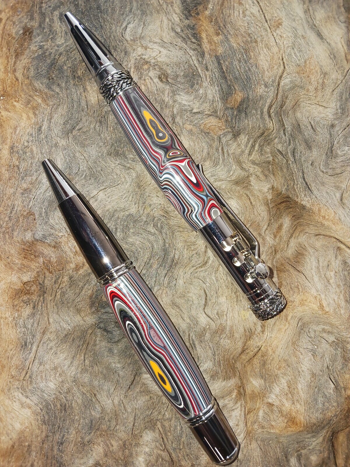

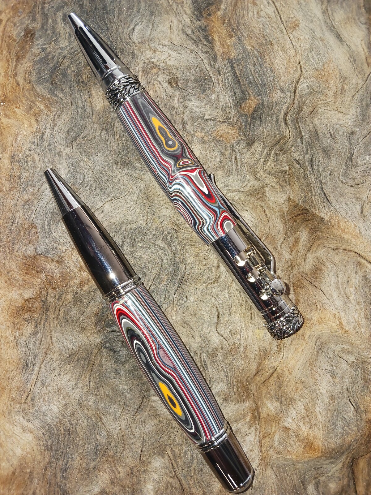

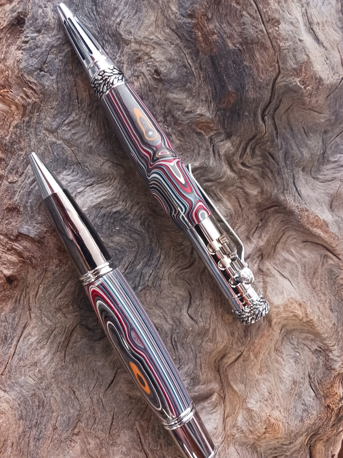

Sharp tools, light cuts, thin CA soak ever so often.
I have about a 1 of 10 failure rate where a blank blow up, and usually you can file the chunk back in place so it isn't a total loss.
