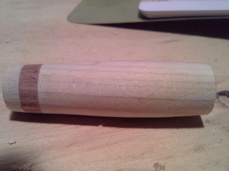

I know this thread is old, however, I was able to get a picture taken of what I was talking about. This is a segmented part of a pen using pine and cedar. The 'chatter' is horizontal along the center of the piece. I know it's a little difficult to see, but it was the best I could do.

That is hard to see.. im guessing you are talking about the horizontal band ? it looks like the wave from curly maple. In my experience i think the mandrel is bent slightly creating an out of round blank and the sanding itself created what you see now.
Well since it was an old thread, did you take in any of the advice that was given you and see if anything worked. From the photo I do not see what you are calling tool chatter. Tool chatter would be skips in the blank. High and low spots. If you did not take in any of the advice given then not much more we can say. There was alot mentioned and very good advice.
John, if you look above you will see that he did in fact take some or all of the advice given. You just have to read a little farther back than the most recent comment.

Your suggestions have been great! I slowed the lathe down and observed a slight wobble frm the mandrel. I have ordererd a new mandel and mandrel saver as well as adjusting the height of the tool rest. I believe that the problem will be corrected as soon as the new mandrel arrives. Again, thanks for the help. Next time I will try to be more specific on what is going on.
OK Seamus points out that you tried things and from what I see this is what you tried. Did it work??? Is this photo before or after the trying of the new mandrel or the suggestions that were given. You should never have to sand to take care of poor technique, poorly sharpened tools, or poor equipment. Sanding is not solving the problem but covering it up and adding a step.
If you have a straight mandrel or the mandrel saver and you still have these results then you need to look at the presentation of your tool to the blank and the height of your toolrest. Also the sharpnest of your tools and the angle of the cutting edge. I suggest if there is a turning club join and learn first hand or see if you can find someone in your area to teach you. It is so hard to explain what to do by writing words. Seeing someone do it or watch you in your approach is worth it weight in gold when it comes to problems such as this.
That is all I have to offer. Maybe someone else can see the problem you are showing. My eyes are not what they once were.:smile:

Are you still using a skew? That grain looks like it was scraped and not made with a shearing action. Are you using the skew like a scraper, or are you on top of the blank getting fine curls? Most wood will be almost burnished off the skew, and 100 grit would ruin the work. You should see a shine off a skew cut. A well made cut with a skew would allow you to start with 220. Watch a good video on skew cuts and get back to us.
