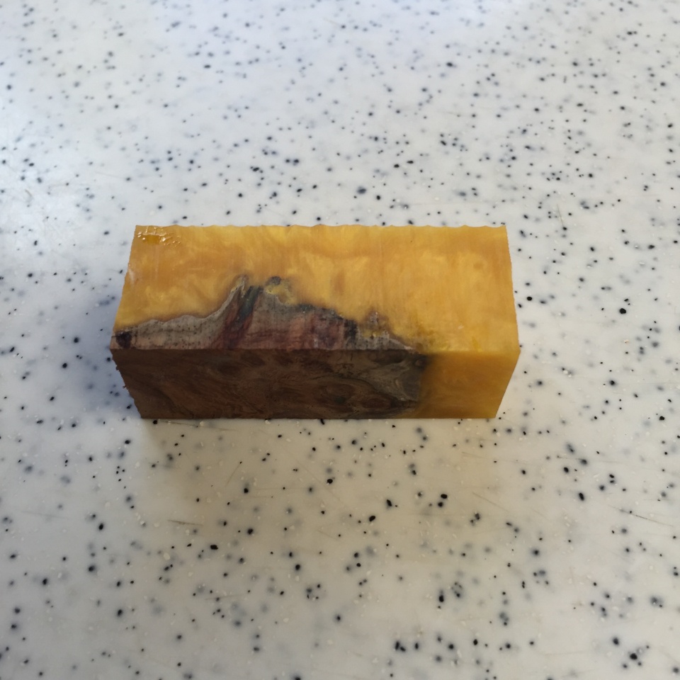

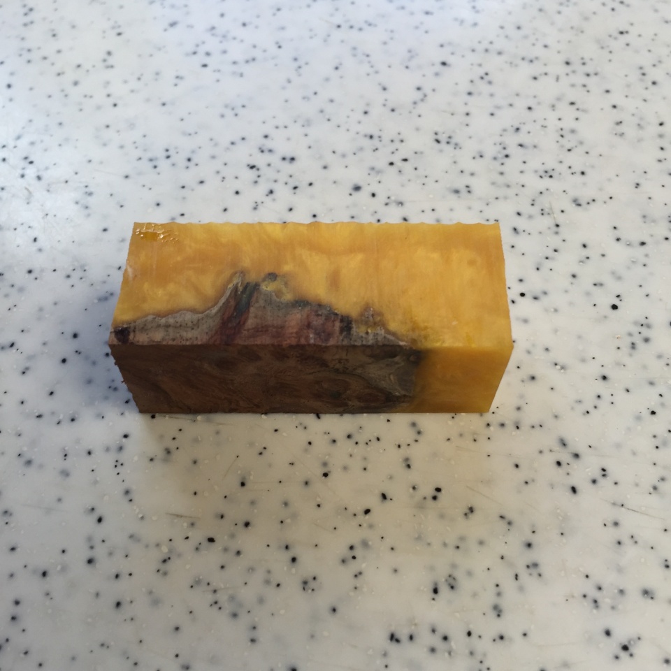

I have a blank that appears to me to be part acrylic and part wood. (Picture below)
I don't know where I got it, but more importantly, I don't know how to finish it. If it is wood, I use CA. If it is acrylic, I go through the MM sanding. What the heck do I do if it is (as it appears to me) a hybrid?
Your help is, as always, most appreciated!

Finish as you normally do wood. CA right on top of it. It is glue it will stick to the acrylic. Nothing special to do. Good luck.

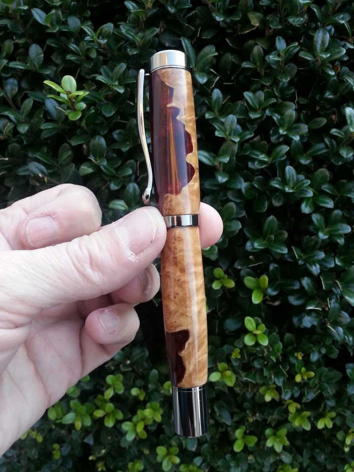

I finish those all of the side with CA just as if it was all wood. Here's a Triton that I finished that way.

Being that it contains wood, do not wet sand. Dry sand only.
You don't want to introduce moisture and then encapsulate it with CA. It will come back to haunt you later.
Also, I recommend trimming or sanding the corners off before headed to the lathe. Just might save your blank.

Thank you all for the quick replies. As I began turning the blank, I came to the same conclusion as John and Tony: It needs to be finished with CA because the wood part of the blank does not appear to have been infused with anything. It is just held in place by the acrylic. I am sure that it is more to it than that, but the wood part appears to be...wood.
As for sharp tools, Akula is right on. Tools and techniques that work for the acrylic part are ineffective on the part that is predominately wood. Charlie, I was lucky in the turning; nothing broke off and it is intact. Turned and dry sanded at this point; I don't wet sand until I have put the CA on, so I am hoping for the best.

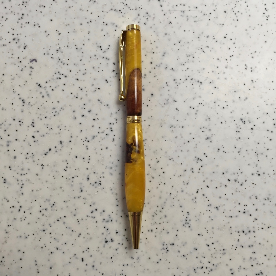

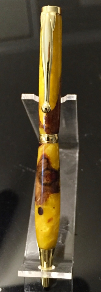

Well, I am quite pleased with the results. I used my regular CA finish procedure plus Steve's suggestion for sealing the ends. Basically, two or three coats of thin CA, followed with 6-8 coats of medium CA; then dry sand starting with 220, then 320, then 400 (with the lathe on slow speed, then off for lateral sanding at each grit), clean with DNA. Then wet sand with MM and finish off with a buffing.
The IPhone isn't the best camera, and there isn't any lighting other than on the ceiling, but the pen turned out much to my satisfaction. Your comments and critique are always most welcome.
Thanks again to all!

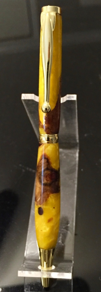

UGH!
Don't like that picture much. It looks squat because of the angle.

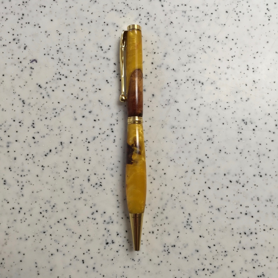

This one is much better.
