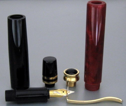

Adding clips to your pens is another tutorial. I haven't made that one, and not sure
there is an article on that yet. Although there are plenty of photos of pens with
the parts seperated (unassembled) that will give you an idea of how each part was made.
It's a matter of starting with the clip you choose, and measuring both outside, and
inside diameters of the clip, then drill, tap and turn your cap, and finial to accommodate
the clip. Several steps involved in this. After you have your cap and finial completed,
you need to file a notch in the top of the cap, to allow the stem of the clip to rest
in that notch, so that the finial will screw down flush with the edge of the cap.
I'll see if I can find some of the photos I mentioned.

On some of my pens, I left the clip ring exposed. Just being lazy. I don't have a lot of photos in my album for some reason. Such as the separated parts I mentioned. I'm pretty sure John Albert (jalbert) has posted some. If you want to search some of his posts in Show Off Your Pens forum, you may find some. He makes outstanding kitless pens. As do many other kitless makers.

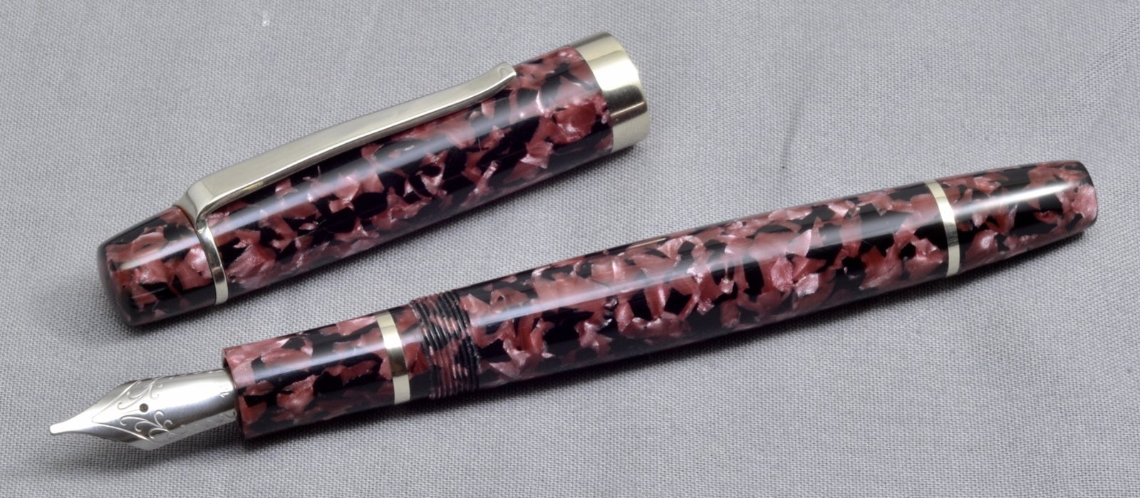

Like this one? I make my own from aluminum or brass. Although you can find silver rings and materials for making rings.
Yes, that's what I mean:), that's a beautiful pen. I'll have to get some metal rod and start turning some ring material. I saw a pen over on the Fountain Pen Network with handmade bronze clip and rings that was very pretty. I imagine making the clip on this pen was not easy....looks like lots of hammering and filing and polishing...:oops:

Thanks! This was a clip I bought years ago. They are no longer available as far as I know. I have many other clips, most of which are not suitable for kitless pens, as the inside of the rings are either too large, or too small. I haven't even tried to make a clip. Although many do make their own, such as John Albert.

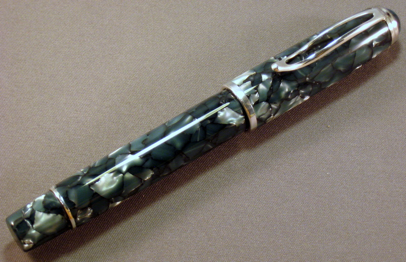

I've actually switched to argentium silver now that I've got the soldering equipment, and can make bands and clips with little waste šŸ˜ it's a lovely metal.
OP,I haven't done any pens lately with the lip style (don't know what it's actually called, so I'm making that term up) cap band, but in this example, I used nickel silver round bar stock to fabricate the band, and the tendon on the cap method you alluded to earlier, and epoxied the band on. The key to a good fit is using a boring bar with a depth stop to cut a precise counterbore inside the cap band for the tenon.
