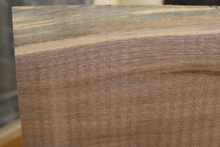

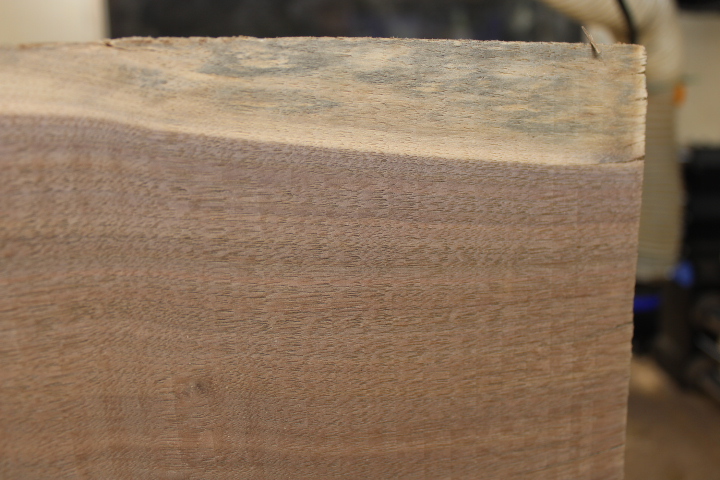

How deep does this stain go in this walnut slab?
Mar 26, 2021
150
Lexington, Ky
I'm surfacing this 2" walnut slab on the CNC, and I'm wondering what this dark coloring is on the lighter sap wood and how deep it goes? I don't have a lot of experience with walnut, and I haven't seen this kind of coloring in other peoples' projects, so I don't know what to think.
Will this unwanted dark color possibly lessen as I take more layers off?
The gray streaks are moisture related oxidation and fungal reaction. Usually this is seen in the white sapwood. If you want to see it even more pronounced, go cut a large holly limb (or tree) in the late spring and cut it into a board. Within a couple of weeks, the white holly will be gray from the excess sap in a fungal reaction. In some cases it affects the spalting in different woods.
The reason you see it in the white wood of the walnut is that there is more moisture traveling in the white sap wood than the brown and (I have been told by several over the years) - wood cut in the spring and early summer will be more likely to have spalting or graying in the sap wood because more moisture is traveling through it at that time. Again, I have been told that if I want white holly to stay white, cut the tree in the late fall or winter. I don't know how true that is but I have heard it more than once.
BTW, the graying of the sap wood can be found by Googling: "Why is the white sap wood turning gray?" But, I learned it the hard way by cutting a neighbor's small holly tree in the early summer (at his request) and seeing the white holly turn gray within a couple of weeks, destroying its value to me!
