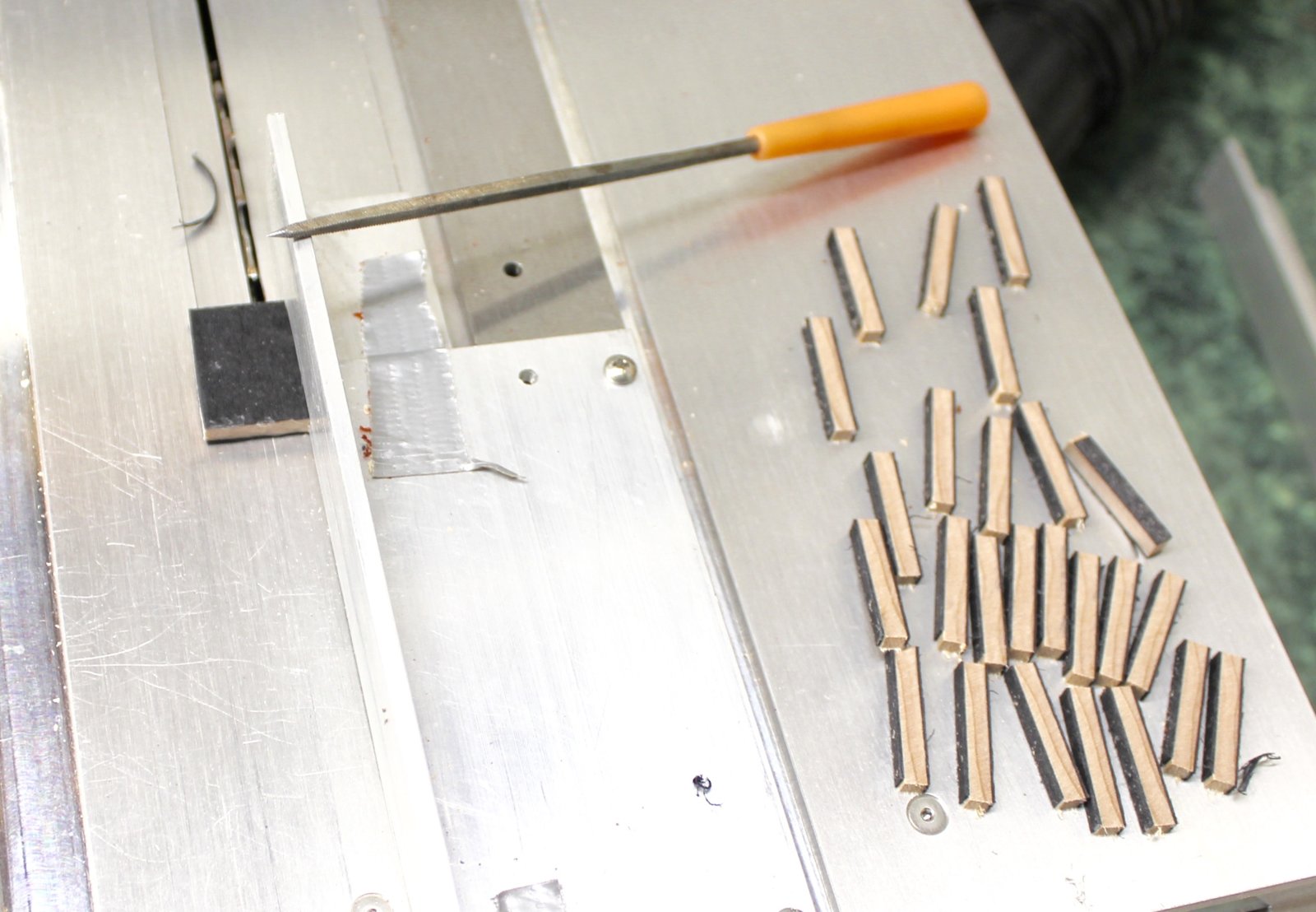

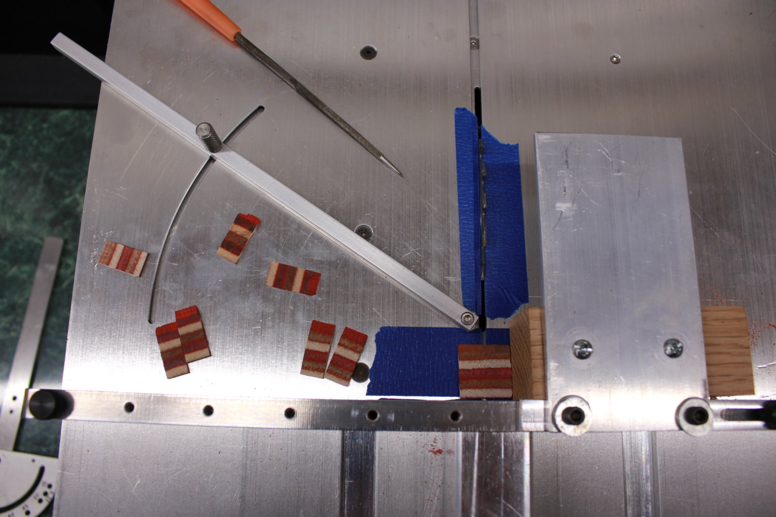

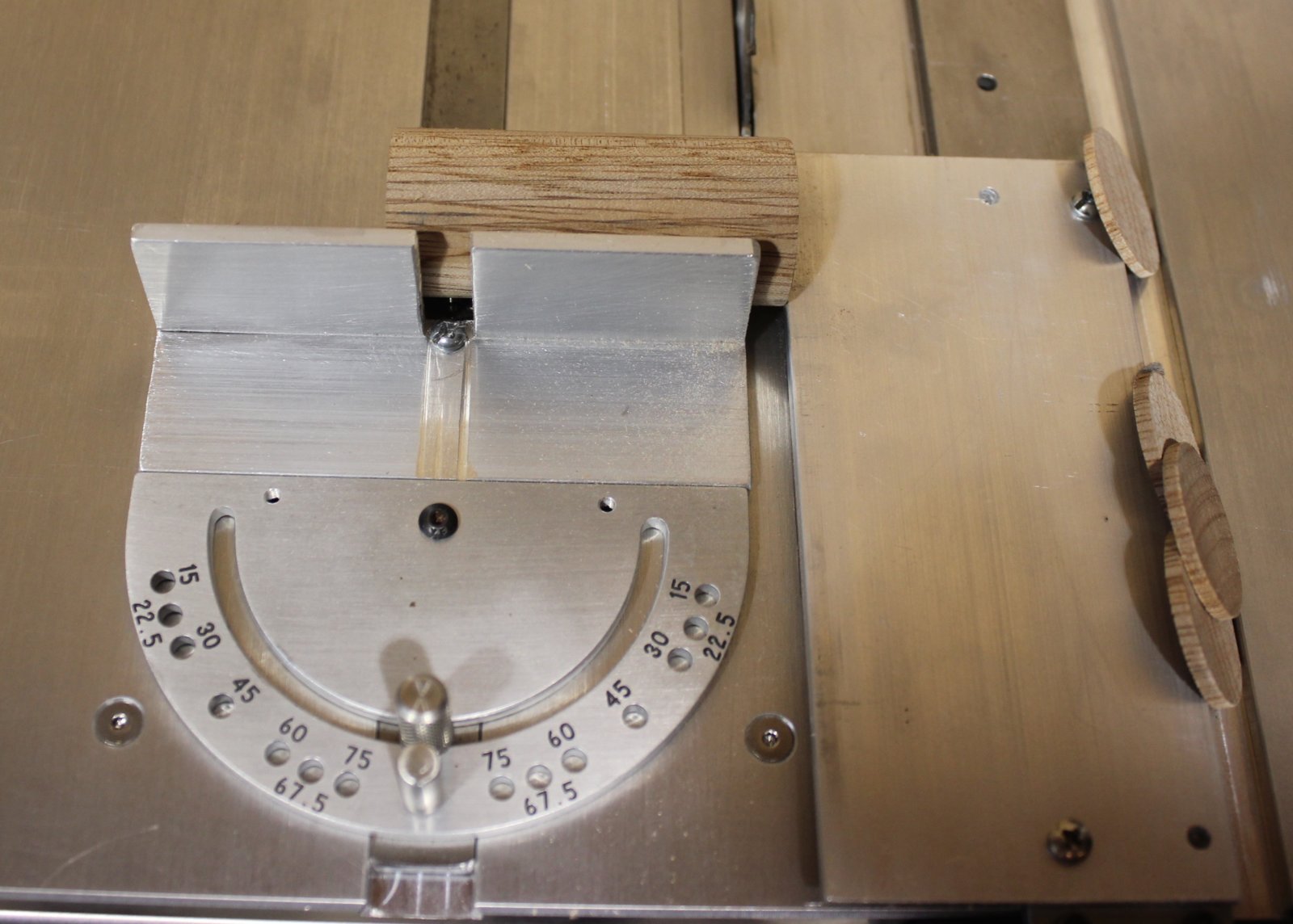

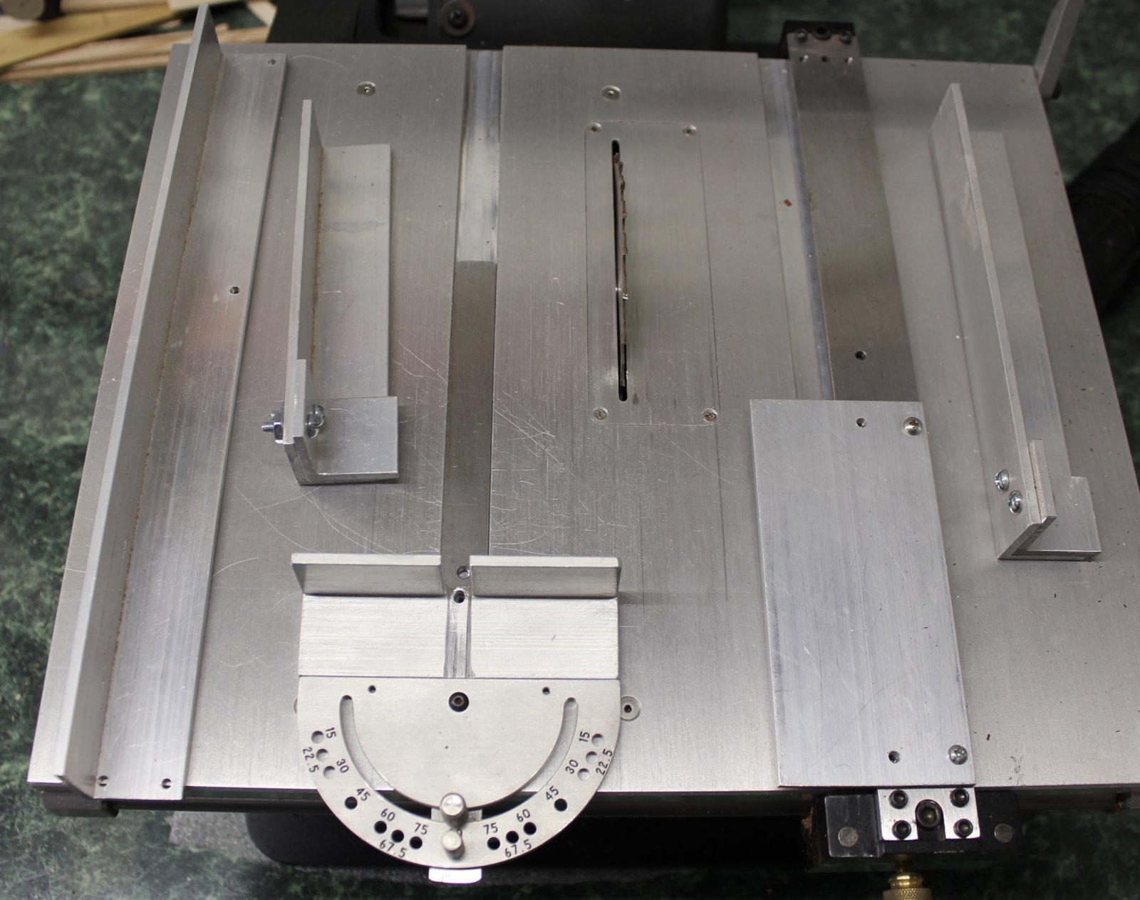

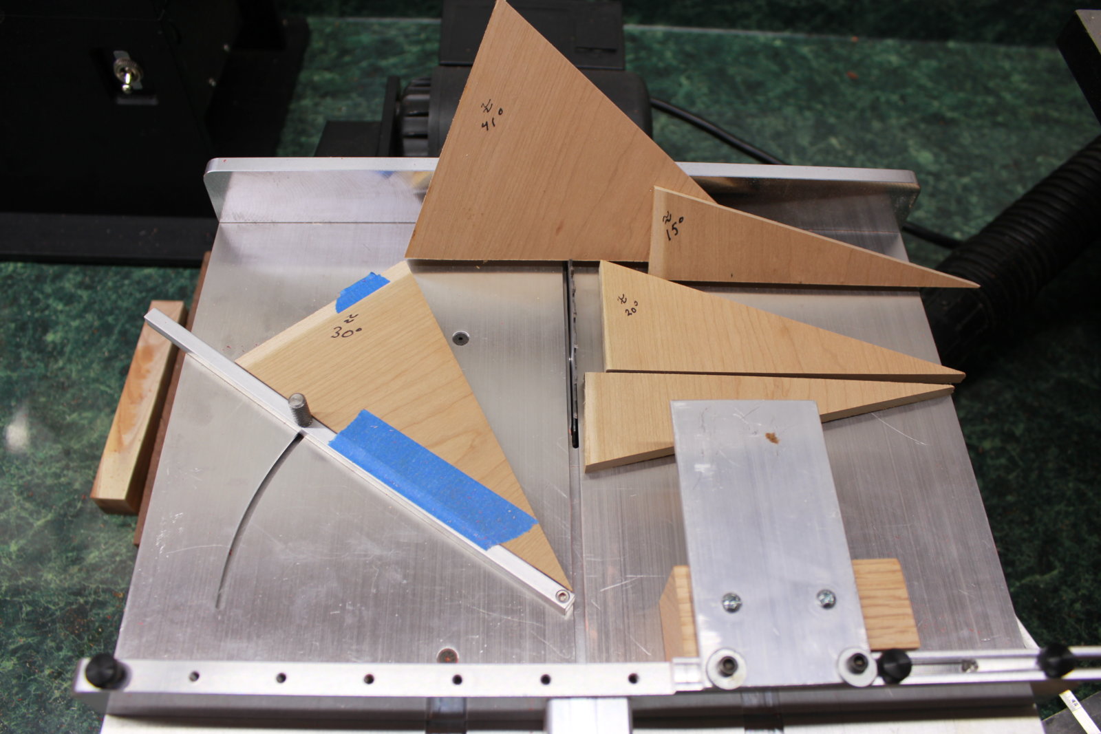

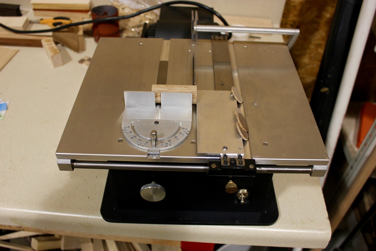

I have a Byrnes table saw and I like it very much. . Quality is very good, IMO. . Blade size is about 5 or 5.5 inch. . Kerf is about 0.060".
Cuts are very close to square. . I have used it for some elementary segmenting and have been very pleased with results. . The cutting guide is very sturdy and tightens down at both ends; easy to loosen and move . The saw is easily stored and brought out when you need it. . Nice to use on the bench. . Does not take up much room. . Have not tried any Celtic knots, simply cuz I don't particularly like them but I should try that just for kicks.
Many people think the Byrnes is overpriced, but I don't mind paying more to get better. . Not sure what accessories come with it now; mine is a few years old.
Tony, I have one and absolutely love it. Best tool I own. The precision is incredible. Go for it, you'll be glad you did.
I also own both the Byrnes Table Saw and the Thickness sander. Quality is excellent for both. More expensive, yup. But it is made in USA and that is a consideration. You will hear it is a toy and you should buy a full size saw. But the important thing is what you are using it for. In my basement shop I don't have the space for a full size saw, and I like the smaller footprint.
Be aware that the blade cutting height is about 15/16" which is a disadvantage. When cutting full-height hardwood, the motor is a bit underpowered, but I have not found this a problem.
I had a Bosch contractor's saw and a craftsman full size table saw when I started segmenting, I'd never go back.
I would not buy the sliding top (accessory) again, as I have rarely used it, and have made several jigs.
My opinion only - I'd buy it again in a heartbeat.
I am going to get it. Any..."nice to have" accessories (blades, tilting table, rip fence, etc.) ? Thank you.
As I said, I have the sliding table. The quality is excellent, but using it will reduce your cutting height more. Im at at my in-laws another 9+ days, so I cannot measure it.
Get a spare blade. I have a local shop that sharpens them, so that's nice. The zero tolerance blade might be nice - I simply use blue painter's tape, wide and that has been fine for me.
I'd actually suggest for you to get the saw and play with it. Wait a bit for the accessories until you are sure for what you want to do. And many accessories can be made.
