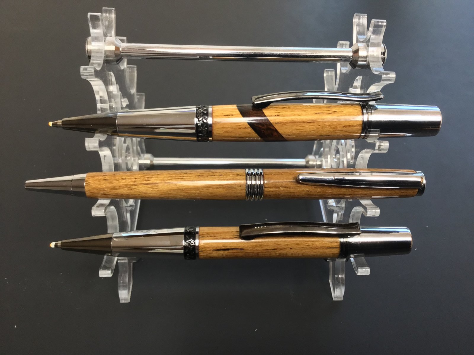

I have certainly enjoyed reading the responses to my question. The wood in question is Teak, and when I got it, it had quite a grey tint to it, along with just a slight bit of an oily smell. However, after turning and sanding it, it has a pleasing, though not spectacular reddish-tan color. There is no contrasting grain in the pieces that I have. I think I will go with what I am experienced with; CA.
I will share one bit of the experience, however. I was going to make a CSUSA Aero pen with one of the pieces. When I was cutting the blank (after inserting and gluing the tube in) I cut the darn thing (blank and tube) off about 3 mm short! To say that I was upset is putting it mildly. I don't have any more of this wood. I called CSUSA and the tech said that was no way to recover from that. A friend came over, and we cut the blank about 3/8" up from the nib end on a 30 degree angle, put a piece of contrasting wood in that was 3mm wide. We were able to drill the insert while the blank was still glued up without harming the brass tube on either end!! Yay! Instead of "another one for the green bin" this will work! Did I say Yay? I did!
I LOVE this hobby and REALLY appreciate the help I get in my garage/shop from folks, and from the forum!
Love to see some pictures and hear how your final finish went. I've got Teak pieces off of eleven WWII Battleships that I'll be hopefully turning this winter. I'm not sure how I want to finish them so any ideas/advice would be very helpful.
Well, here are the results of the pens made out of Teak. They are from the USS Missouri. I was amazed at the difference in the color of the wood before and after it was turned. It began kind of grey and a bit smelly. After initial turning and sanding, it took several cleanings with DNA before the dark was removed, revealing the light brown you see. I decided on CA because it is what I know best. The wood does not have a lot of visual character, but an amazing character in its history. The pen with the insert of Rosewood happened because I am an idiot as I explained above.
There is one issue that really troubles me. The 2 single-blank pens are Aero pens from CSUSA. The mechanisms don't work smoothly on either of them. I have about 10 of them sitting to be used, but I don't really want to put all that effort into something that is rough. I went back to a couple of pens that I made earlier and they were both rough. I tried spraying some silicone into the mechanism (a thought that I had while talking to CSUSA, and was told to try). It helped a bit, but they are still rough.
I must admit I love the segmented one.
