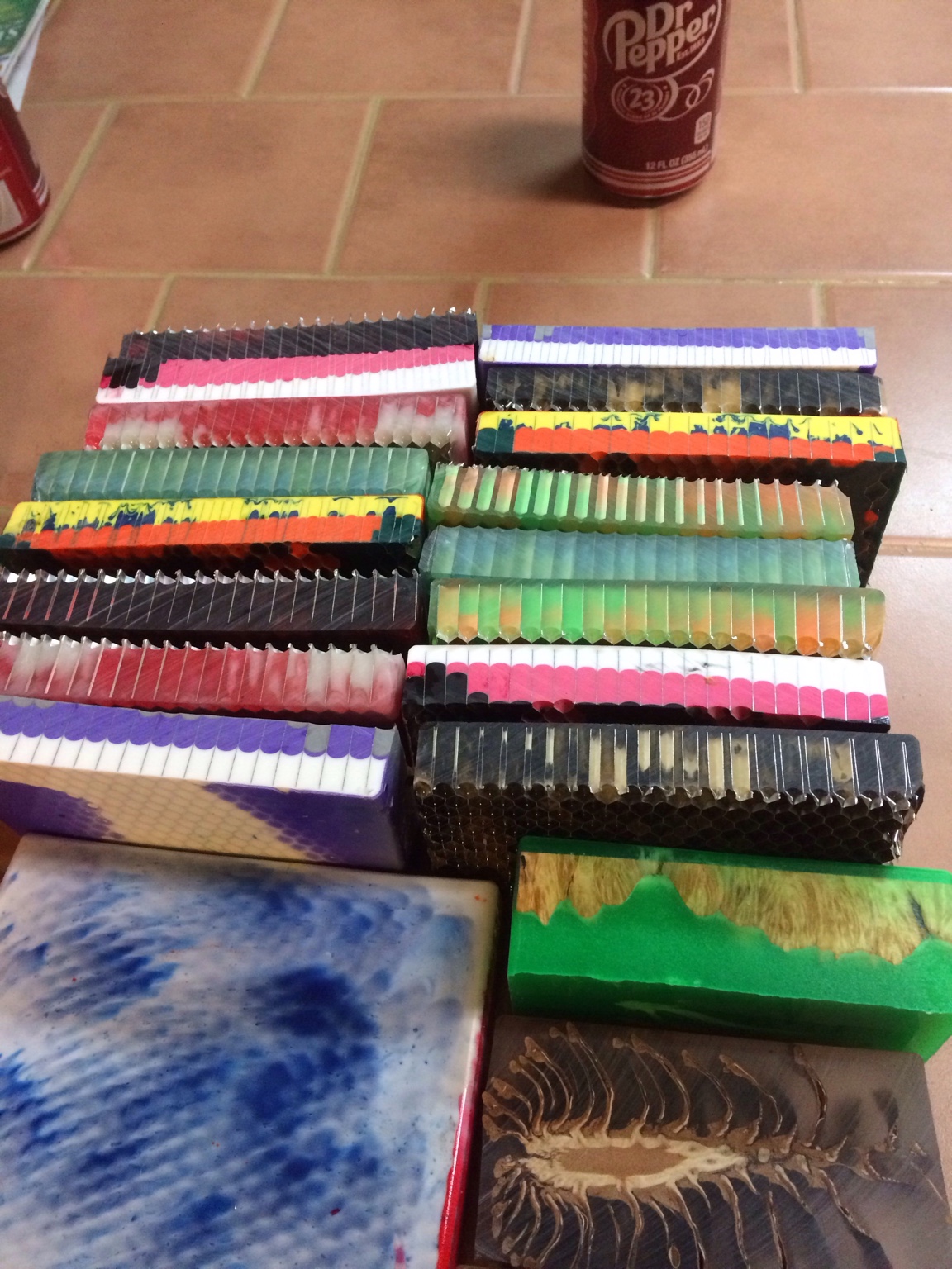

I'm working with Brooks on this now - we found some aluminum honeycomb core (whatever that is) on ebay with tiny cells and good dimensions for this type of thing.

I saw a youtube video with the aluminum honeycomb core cast with alumilite. Didn't work at all. The alumilite just fell out if the holes. Don't know how PR would hold up. Post the results!

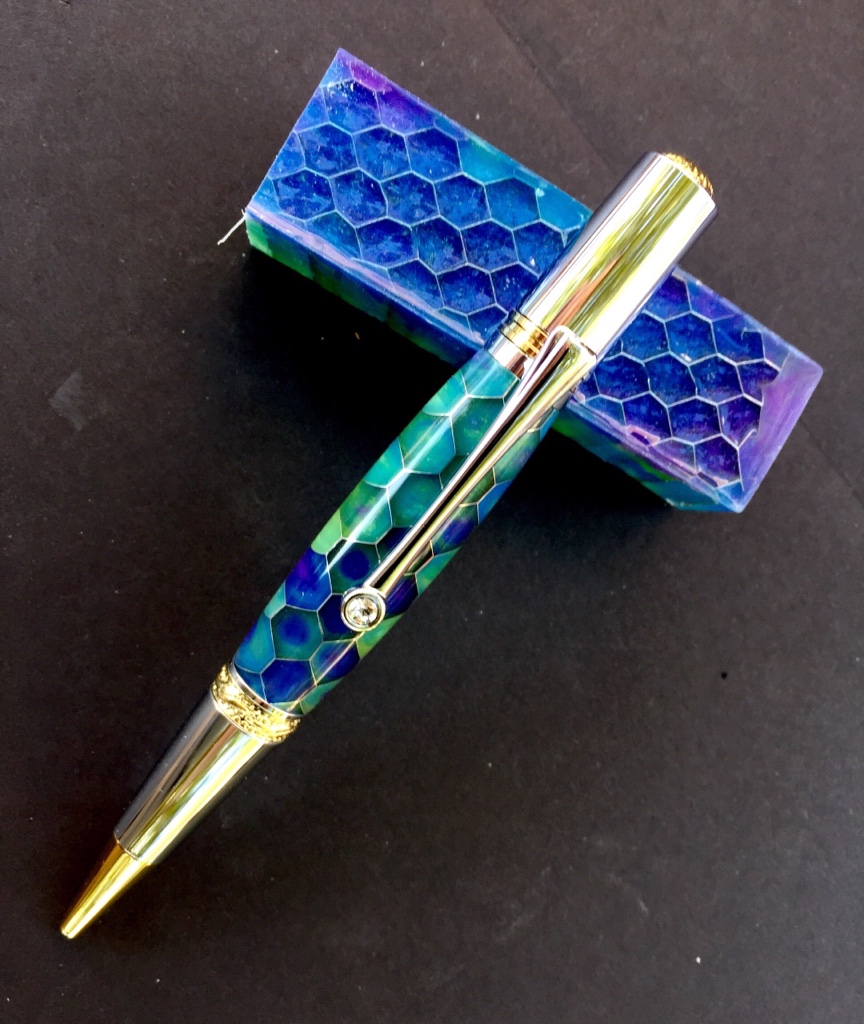

The Blank Masters in Richmond, TX makes honeycomb blanks.
https://m.facebook.com/theblankmasters/
Here is an example of one of his blanks on one of my pens.
He is working on a method to make the honeycomb mesh out of an aluminite pour and then another aluminite fill.

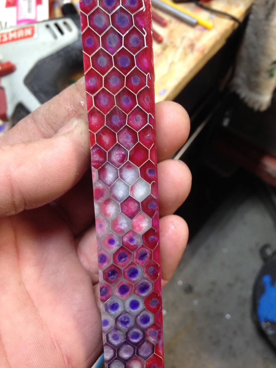

How do those blanks turn? I tried casting into honeycomb aluminum 3 or 4 years ago. I could never get the blank turned without the resin separating from the comb during turning.
More4dan
Mar 17, 2016
2,102
Katy, TX
I've turned aluminum honeycomb with aluminite resin. While rough turning round I had a few chip outs. I rough turn mostly on a metal lathe with HSS and finish shaping by hand with a carbide cutter. I've had no chip out problems as I approached final diameters.
Good cleaning of the aluminum prior to pouring the resin is important. And you have to keep the blank cool while drilling and turning.
I'm working with a local caster looking at alternatives to alum for honeycombs. Stay tuned.
