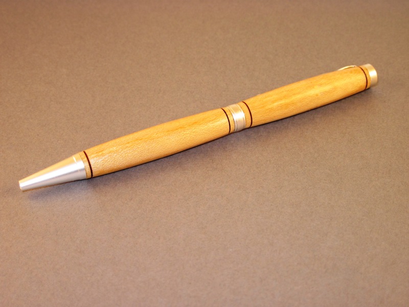

I like the branches for pen blanks - lots of nice dark lines in 'em.

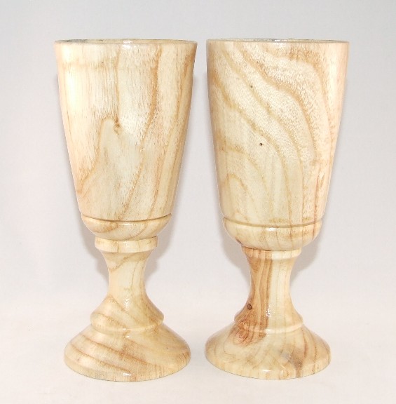

We had a Honey Locust in my back yard when we first moved here... about 6 or 8 inches diameter and with 4" thorns up and down the trunk... I cut it and saved the wood (without the thorns) and then spent 3 or 4 years trying to kill the stump.

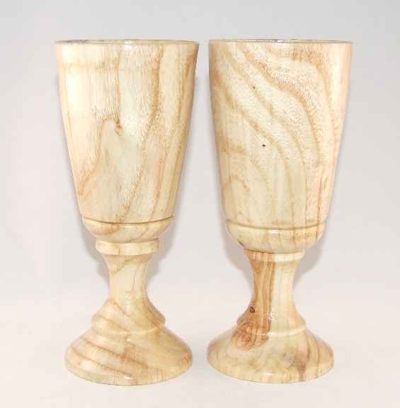

I turned a couple of goblets from what I had, it's fairly bland wood, but does turn well.

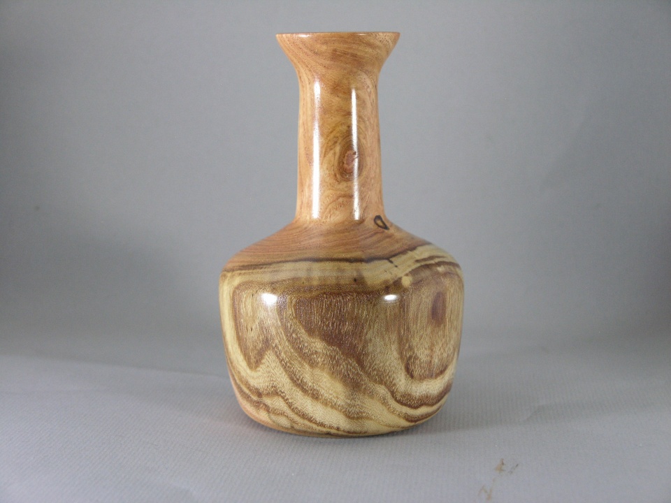

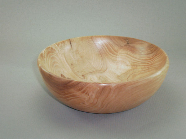

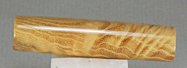

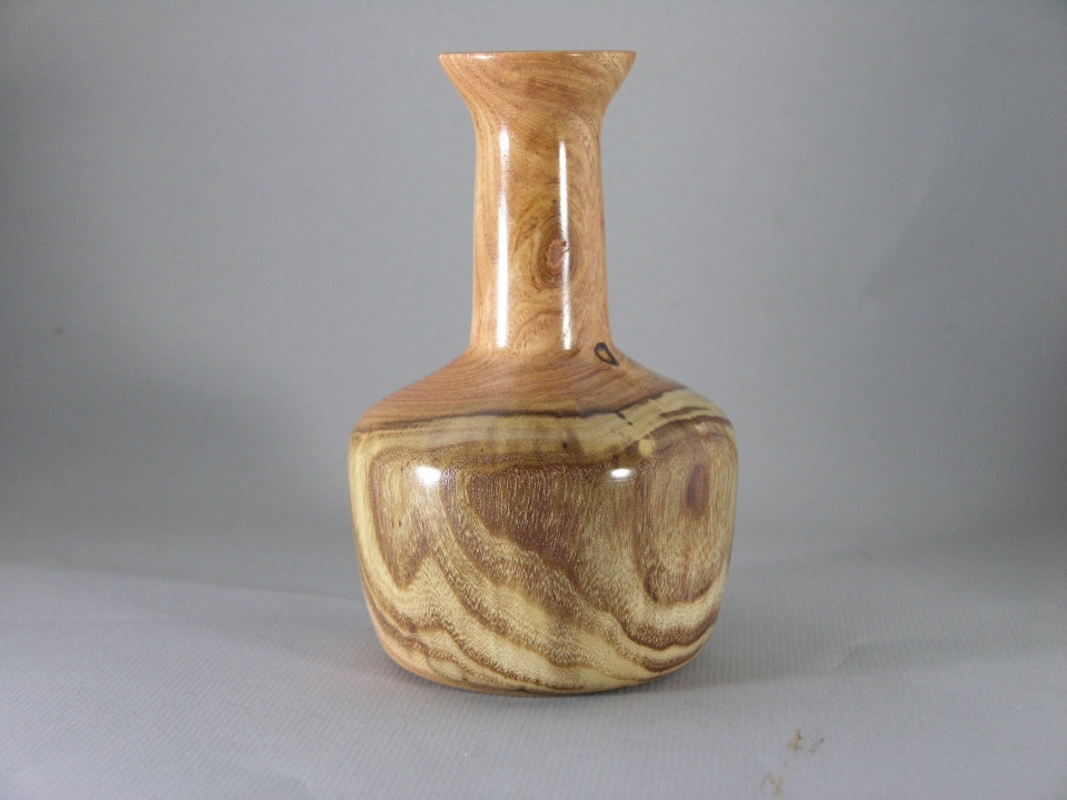

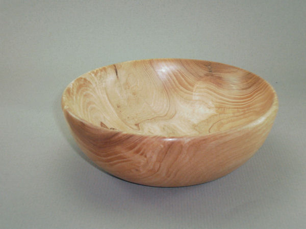

Tree surgeons took down a honey locust at a neighbors a few years ago, I got most of it for firewood (I wasn't turning then). We don't use the fireplace much as we normally heat with natural gas but with the new carbon tax just dumped on us I can see putting in a wood burning stove in the basement. I found some of the honey locust last summer near the center of the pile and turned a few things with it. Here is a small twig pot I did with it. It's about 3" across at the widest point. A small bowl and a pen blank. The pen blank came out of a piece of crotch wood and a different tree.
If you get lucky there can be some nice stuff inside.
