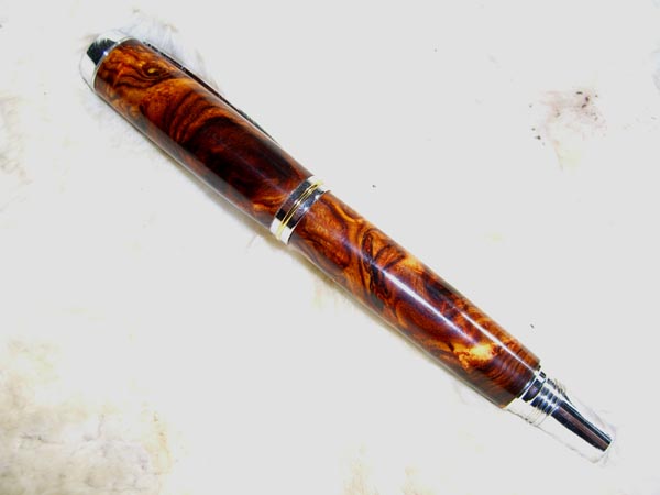

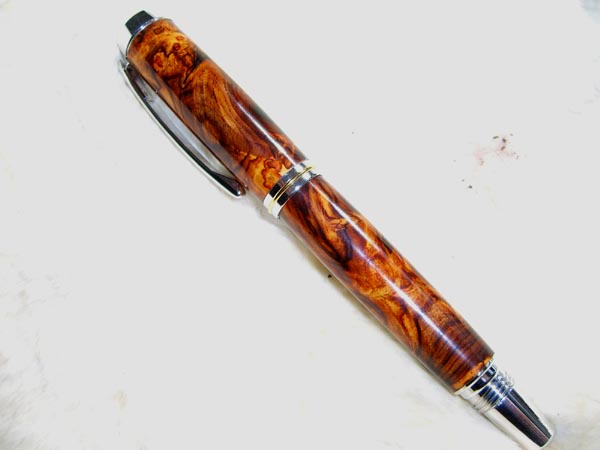

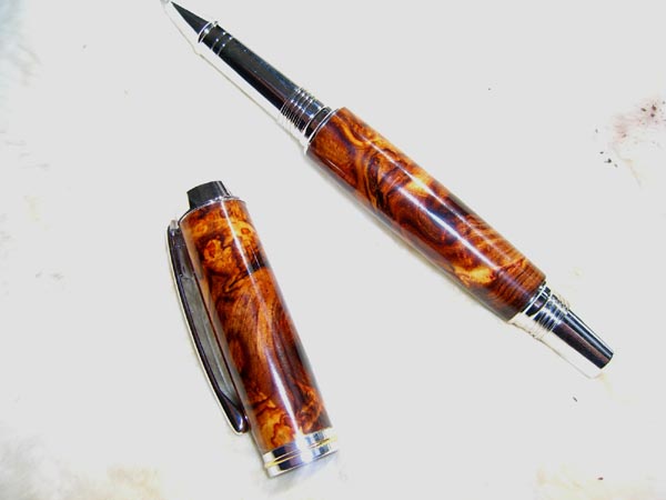

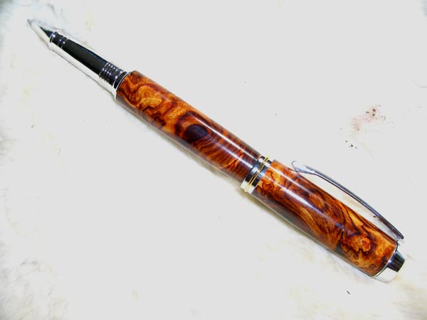

Well here it is... the Jr. Gent I made from burl #1 of the three burl stash I scored last weekend. The pix tell the story. The wood and pen is a natural light shot and the detail are flash PIX shot against some white rabbit fur which washed out.

Oh I forgot to mention the finish... tung oil and CA... maybe 5 layers. I also hit the naked wood with a small amount of tung and let it sit overnight before starting the Tung/CA process.
MM-12000 and then China White & Carnauba buffs and a coat of Ren Wax.
