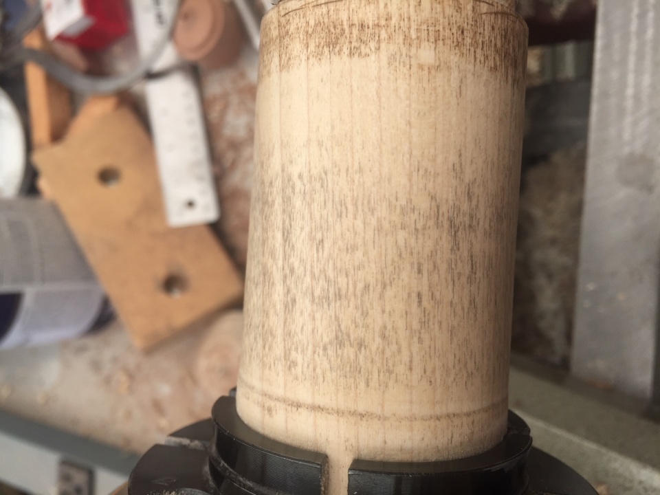

I was watching a few YouTube videos where turners made their own sanding wax. Essentially, the formula was 4 parts mineral oil, 1 part tripoli and one part beeswax. I did this by weight. 6 oz, 1.5 oz and 1.5 oz.
Formulation was easy.. but, I got horrible results in my one trial on a light colored piece of alder (I think it was alder). Anyhow as you can see in the photo, the sanding wax left dark gray color in the wood.. not what I was expecting.
The guys that made the SW on YouTube had a tan colored tripoli and mine was a dark gray color. I ordered it from Amazon and it was listed as Rottonstone/Tripoli. It was made by Behlens which I remember as a reputable manufacturer of wood finishing products and was listed on the container for finishing woodwork that has a finish applied.. such as a varnish.
So, not what I expected.. Have any of you made your own sanding wax? If so, what did you use for the grit?
Thanks
Edit: I later saw a formulation by Capt'n Eddie. He used beeswax and mineral oil without the tripoli. I'm guessing this is likely what I should make up. Probably use the mix with the rottenstone for putting a polish on items that have already had a hard finish applied. Wonder if it would work with acrylics.. which I have yet to try..

That photo and the resulting "grayed" polish make it look like bamboo!

Definitely not bamboo.. I'm quite sure it's alder.. Re the beeswax and mineral oil, that's Capt'n Eddy's formula that he got from an old time turner friend of his.
Because of the mineral oil and beeswax, I doubt one could put a finish on it other than shellac.. but, possibly something harder over that if desired.
What is the objective - are you trying to get a smoother surface on raw wood prior to applying a finish, get a smoother finish on wood that will only get mineral oil, fill pores before applying a finish, . . .
If the first, adhesion will be an issue over wax and mineral oil; if the second, plain 800 grit sandpaper gives me an extremely smooth raw wood surface; if the third the filled pores will never dry hard.
