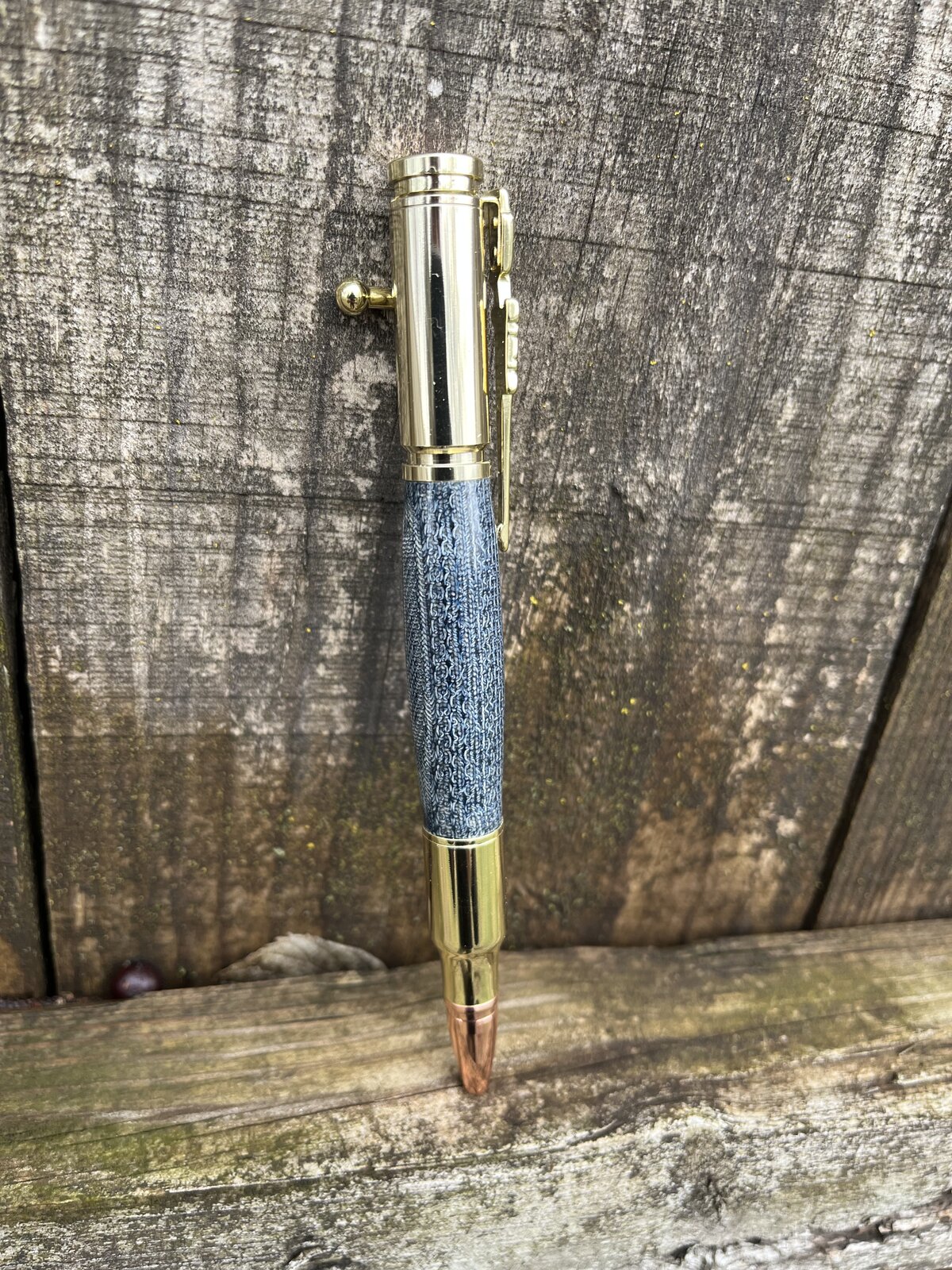

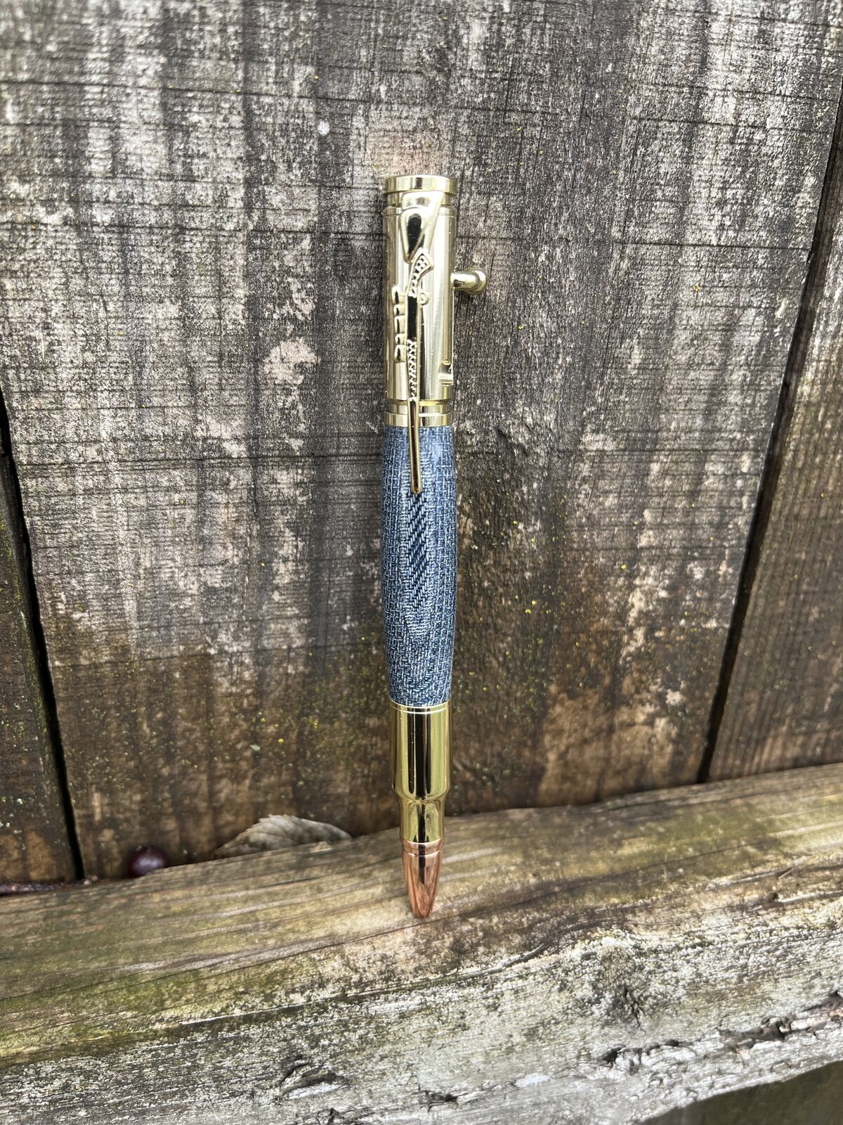

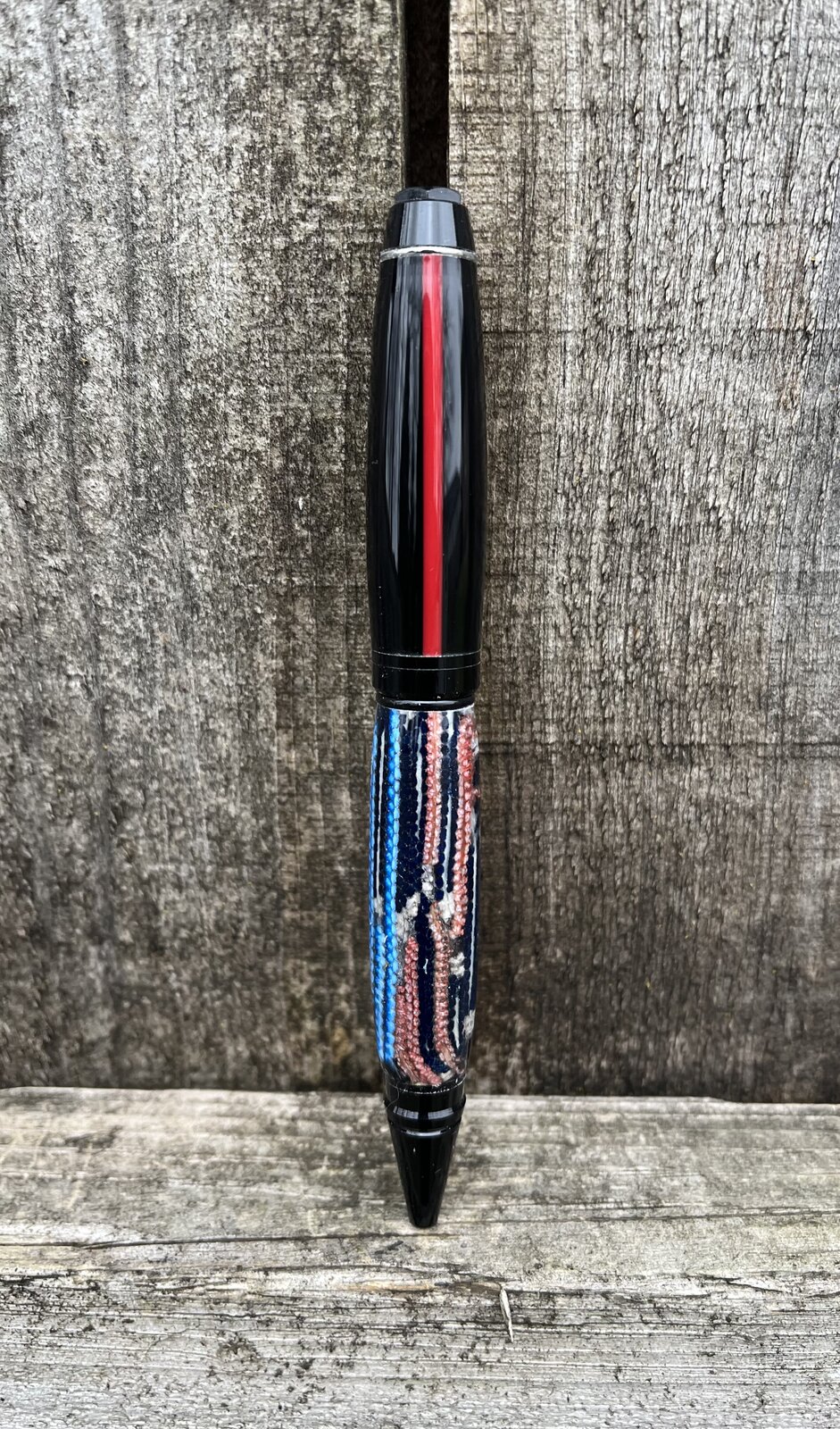

I purchased the blank made from fire hose off a guy on a Facebook pen turning group for a firefighter themed cigar. It got me thinking and decided to make my own micarta of sorts out of an old pair of blue jeans. I used bondo fiberglass resin and soaked each price of denim before clamping. My clamping/press set up needs some improvement for the next round as the blank didn't come out to a uniformed size, however it was sill usable for 2 single tube pens

I really like the denim pen. Very nice pattern. The hose is nice just not my favorite. Did you have trouble with the hose fraying as you turned it? I've tried casting and stabilizing fire hose and I had those issues. Once I got to the hose it frayed like cotton and I had to soak it in CA as I turned it down. I thought it was a huge pain. After it was all said and done it looked good just not too sure it was worth the trouble. I'm sure I'll try it agian but it would be nice to find an easier method. Thanks for showing.

I like that idea, I'll keep it in mind for my next attempts. Thanks!
Yes I had problems with it fraying. One I turned it round I frequently stoped and soaked it with thin CA to get a better cut. And it sure does soak up the CA. After I applied the finish, sanded and polished, it wasn't real impressed with my finish, probably could have used a few more CA coats, but I'll chalk that up as being new to CA finishes
