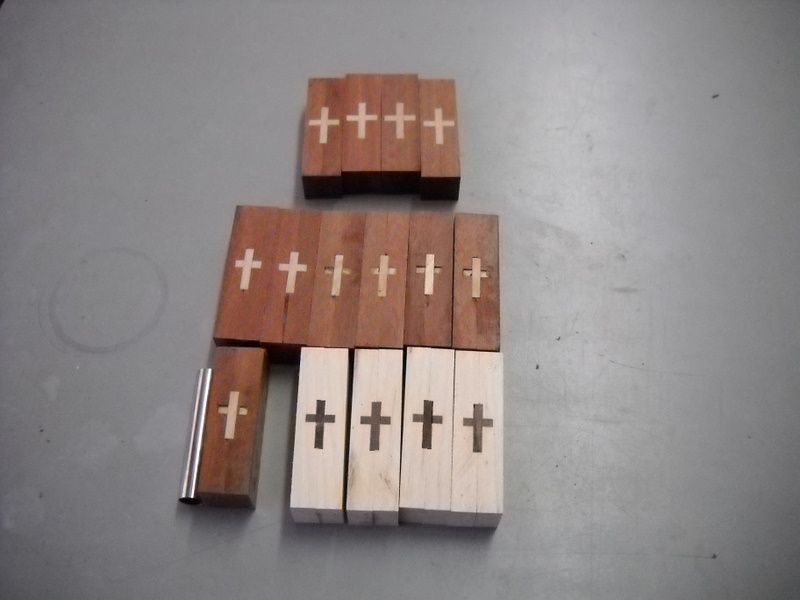

I've made some cross inlay blanks using table saw and router table.

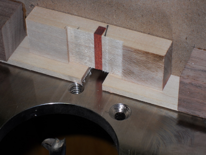

  2. Using a miter gauge jig and router table, route 1/8" slot for horizontal section of cross
  3. Glue in horizontal inlay
  4. Using same miter gauge jig and stop blocks, route 1/16" slot for vertical section of cross -- use a sharp bit to get clean edges

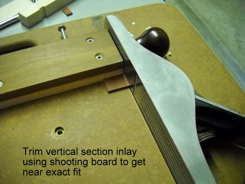

  5. Trim vertical section length on shooting board to get precise fit for the vertical section

Takes a while to get the jig set up and precise height adjustments but not particularly difficult once set up is done. Here are some photos of various steps and resulting blanks:
