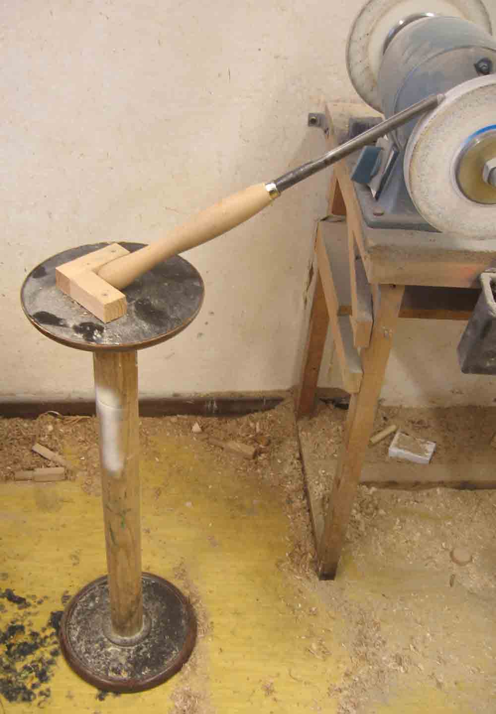

simple home made jig
Hello !
Perhaps it is too late, but I am enslosing a photo of very simple tool holder. I was having a lot of trouble with grinding gouges, which had to be perfectly grinded for making chess pieces. After seeing few profesional and home made, wooden jigs I decided to make one. But I did not have enough place on the table with the grinders, so I made simple tool holder. Since then I grind gouges with out any problem. I belive the key is that bevel is grinded in "one line" from the start to the end, and this can be done with this. Of course profesional jig could (is) be better, but this one also work fine. I just set it in correct position before turning on grinder, and than step on the bottom piece of wood, to have same position at all time of the grinding. And I guess none jig could be made in less time.
Good luck.

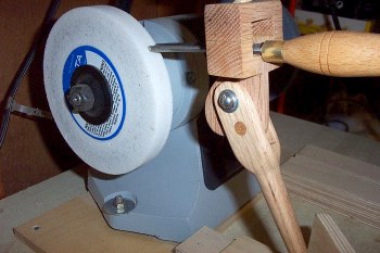

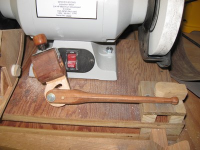

Here is the ones I built. I did searches in the internet, found some examples and using pictures from what I found made my own.

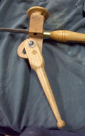

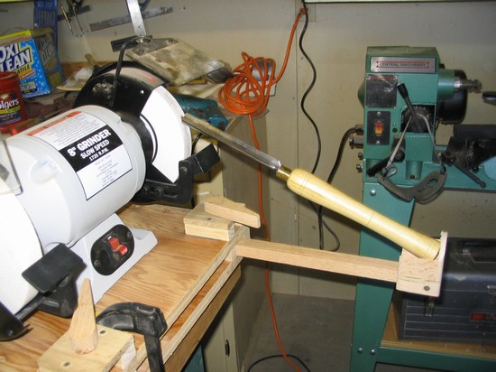

Here's one I used to make...
Here's some pics of one I use to make...

PaulDoug
Mar 2, 2008
3,488
Benton City, WA.
Marc, note the similarities between yours' and mine. You picture looks awful familiar. Thanks for the inspiration. Think i got the stem on mine too long though.
