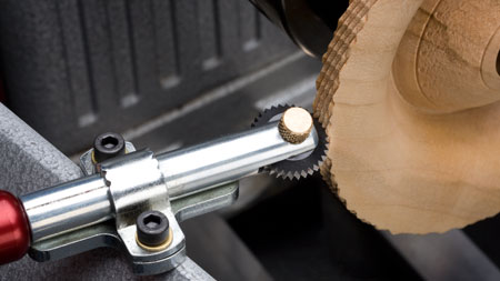

Those of you who mentioned the round vs. square, think I could rig up something like the attached pic? It's one of the spiralling tools that CSUSA sells... should definitely allow me to keep my tool from rolling.

Save some time and purchase 'square' stock. I use 5/8" bar and it 'sits' real stable on your tool rest. Just suggestions.:smile:

I originally used square stock - both 1/2" and 5/8". A few months ago I used a piece of 1/2" round because I always use an oval skew at an angle when I turn pens. I used the round shaft tool in this manner for pen turning and really like it. I still finish turn with skew though. I agree that I would probably not use the round shaft tool on something very aggressive. It would 1) want to turn on you, and 2) has less mass than a square shaft.
Good luck and be careful.
