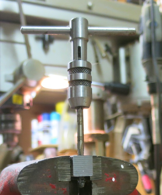

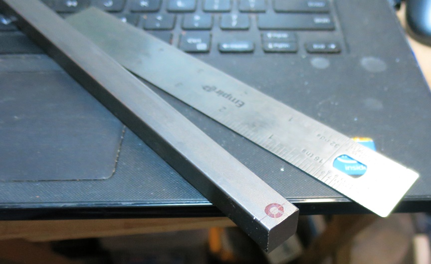

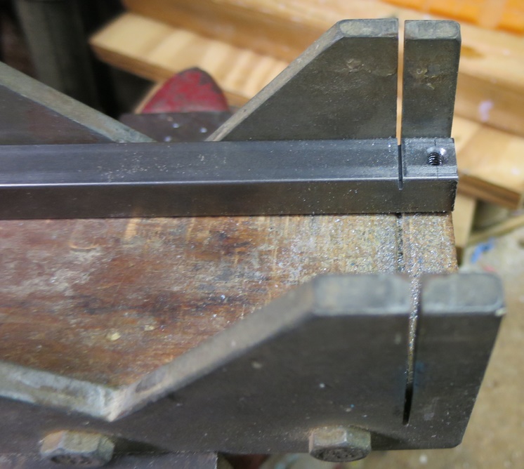

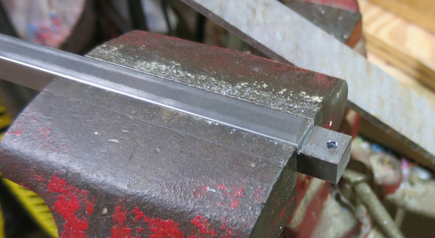

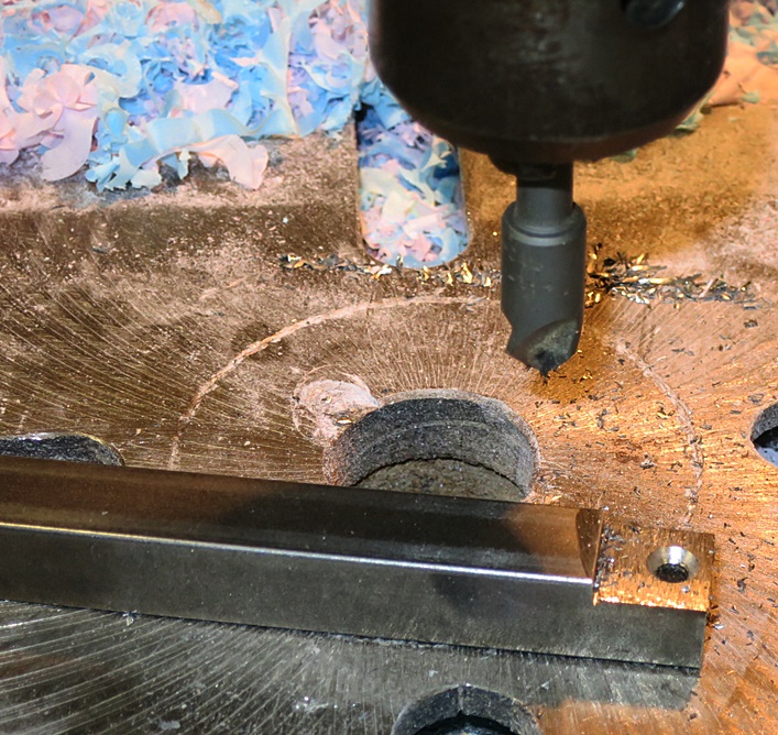

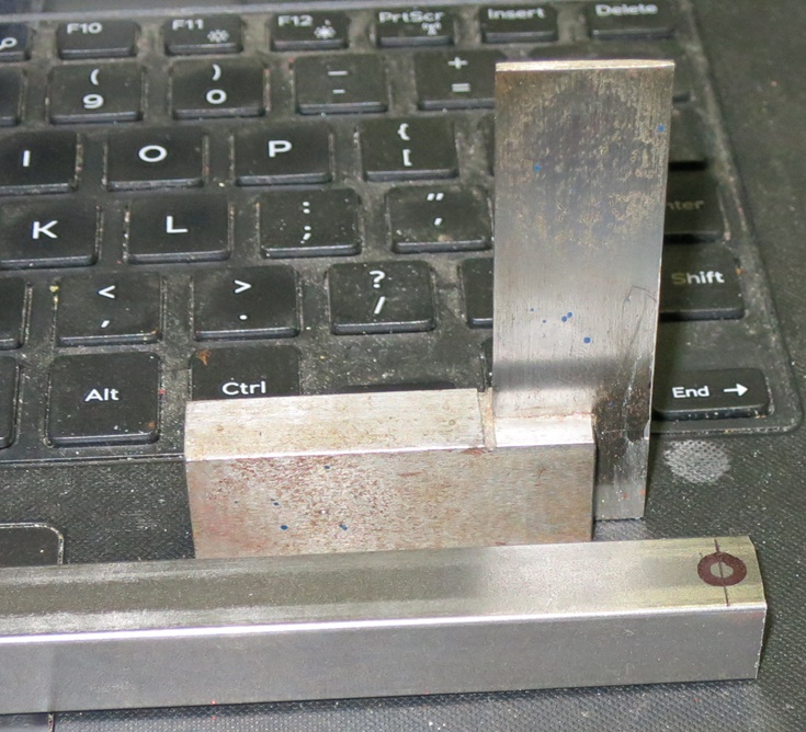

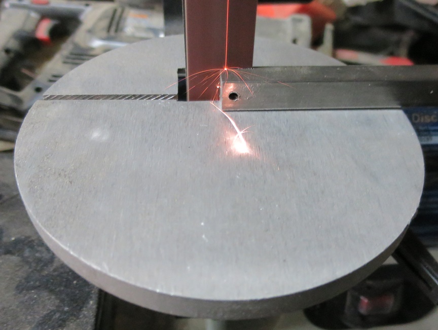

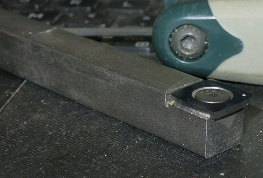

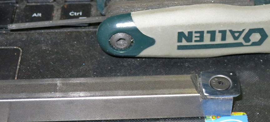

I bought some 15mm carbide radius cutters from Arizona Carbide a while back, and finally got around to making a handle. I used a 12" length of mild 1/2" square steel. I marked it, drilled it, and tapped it with an 8-32 tap. For the notch, I cut a slot with a hacksaw a little deeper than the cutter is thick. Then used a combination of my 1" belt sander and a coarse file to cut the notch. I had to put a chamfer in the tapped hole with a countersink, so the screw would tighten all the way.

To give yourself just a TINY bit more leeway in using that tool ... I'ld go back and grind a steep bevel under the front of the carbide bit. Not so far back that it hits the screw, mind you ... just 7 - 12 degrees of relief, so that you can approach your blank carbide first, rather than heel of that step first. :)

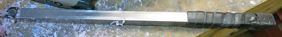

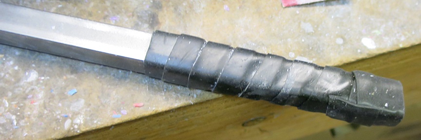

I still need to turn a wood handle for it, but for now I wrapped the end with friction tape. It actually works! I used it to turn two brittle blanks. It's not exactly precision, but I'm happy with it.

Good idea. I'll do that.

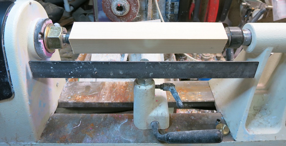

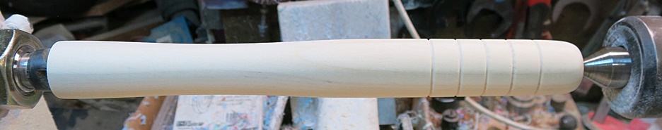

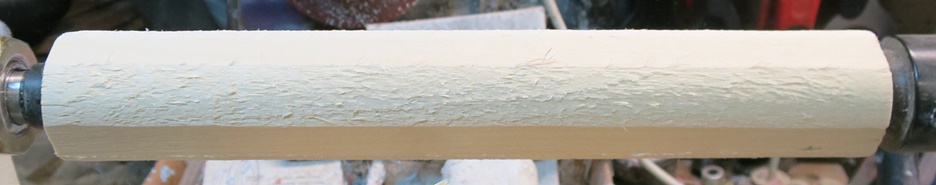

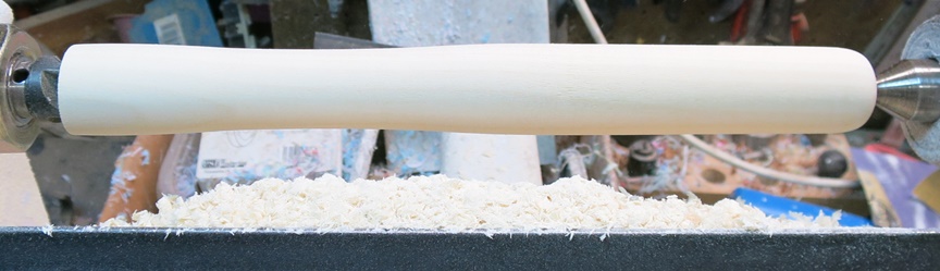

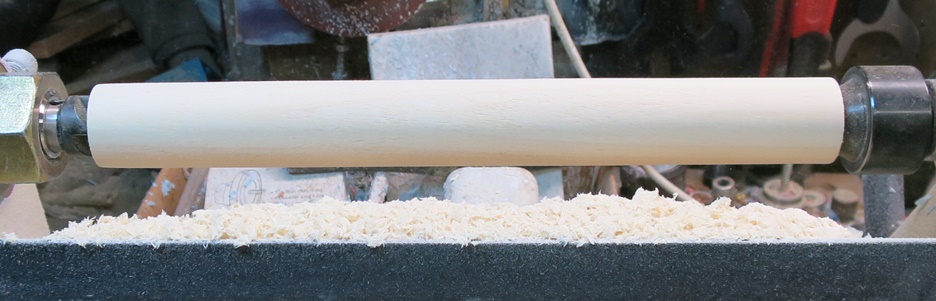

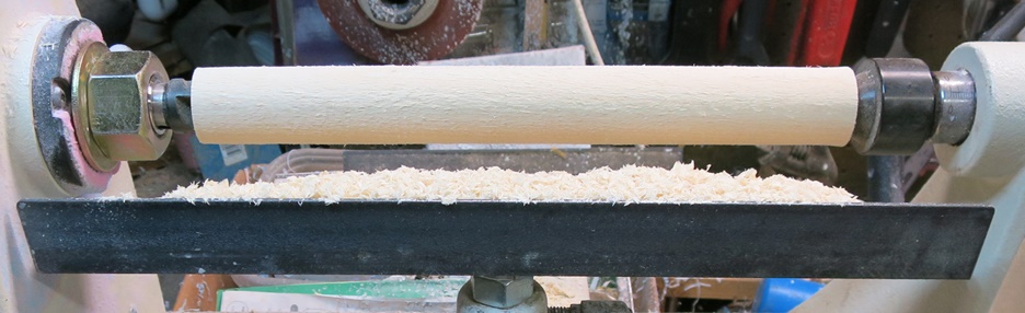

It's been a long time since I've turned a spindle. Certainly a lot different than turning a 3/4" pen blank. I used a 2" x 2" piece of poplar. It's rough, but I'm happy with it. I think I'm going to stain it to make it darker, then put an oil finish on it. I still have to figure out a ferrule for the front.
