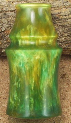

I cast my first alumilite this weekend. So far I have only used PR, but it is too brittle for calls. Here is the result. I used green and gold pearl-ex powders. It is a coyote call that imitates a rabbit in distress.

Looks great. Perfect for color for spring. Now just switch the colors of the pearl-ex to have calls for each season - time of year, that is (as opposed to type of critter) ;)

Jeremy,
I also have found that the PR is very brittle for any type
of game call. What is your take on the alumilite for game calls?
You did a fine job on the color of the call, keep up the good work
on the coyote calls.

Alan,
I reluctantly decided to do some testing with this call prior to trying to sell any. I dropped the call on the concrete several times from about 7 feet, tossed it, and threw it extremly hard all without a single chip. I made sure that the edges hit the concrete and all that happened were a couple of small indentions when I threw it the hardest. I think it is going to work just fine.

Jeremy, nice call and nice color combination..
Yep, I know what you mean about the Alumilite being tough. First money blanks I made I through them around a bit just to see how hard they were and other than some small dents on the edges the it never cracked or broke.
