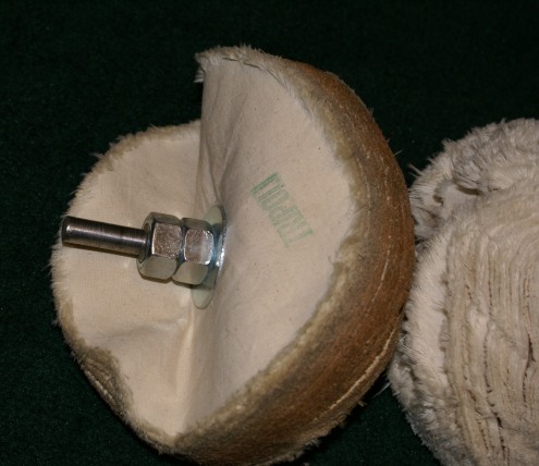

Thread two hex nuts onto the all-thread down to the point where the milling ends. Follow with a fender washer and the Tripoli wheel, another washer and another hex nut. Tighten them to squeeze the wheel. (1st pic)

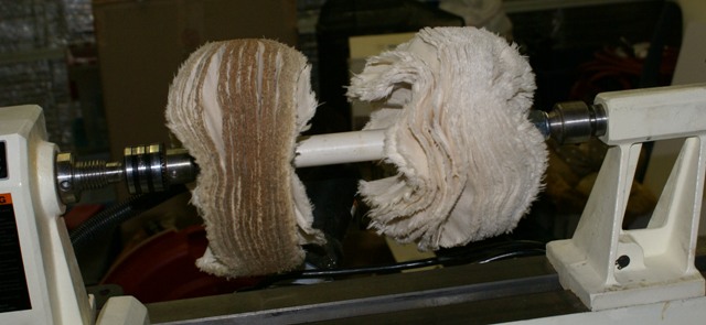

Then add a 4-1/2" piece of the PVC pipe on and a hex nut, the White Diamond wheel, another washer The PVC is to protect the pens from the spinning allthread (and my knuckles!! :eek: DAMHIKT!!! ) (2nd pic)
Add two hex nuts. Tighten them to squeeze the wheel.

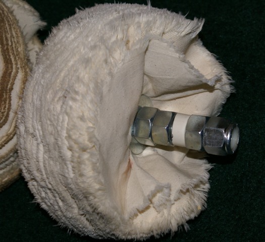

Now add another hex nut and the nylon hex nut so the nylon hex nut is about 1/2 way on. (3rd pic)

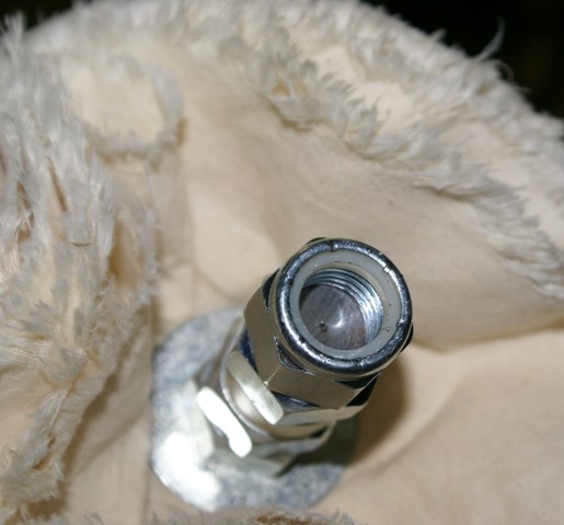

Measure the space between the 5th and 6th hex nuts and cut a piece of PVC to fit in that space. Remove the nylon hex nut and the 6th one, add the PVC, then the 6th and nylon hex nuts. Tighten everything. (4th pic)

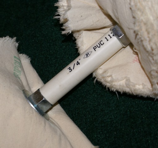

On the lathe (5th pic)

Great and simple set-up. I was wondering what to do about the end points. The nylon lock nuts are ingenious. Thanks for the photo.
