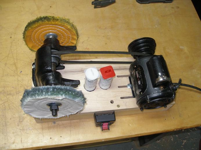

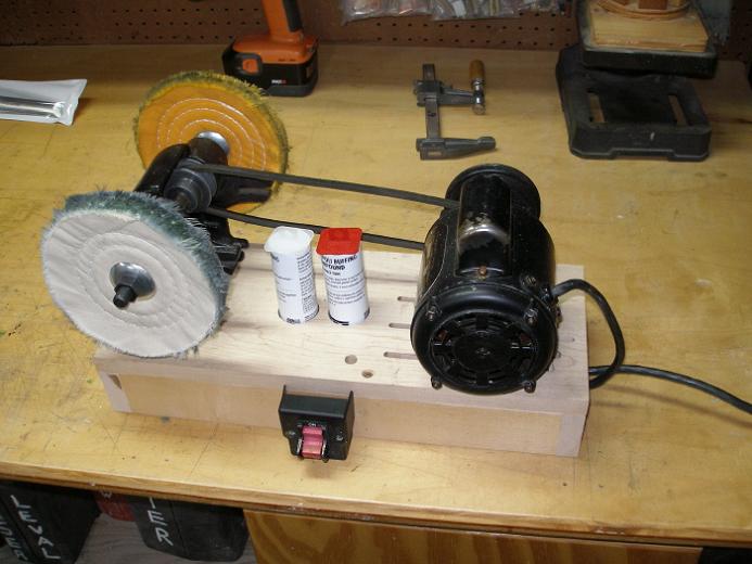

Hi All,
This is what I did this weekend. Had the motor, had the arbor, had the pads, had the belt and had the time. I realize the pads aren't the correct type. I will pick up a couple of softer cloth ones as soon as I can.
It spins at somewhere in the neighborhood of 1600 to 1750 RPM's. The switch on the front controls it. It's the switch that was on the motor when it was on a drill press, so it will control the motor fine. I tossed together the box from Maple scraps I had around.
Here are a couple of picks,
So, what'd ya think? Did a good job of keeping me busy for a few hours.

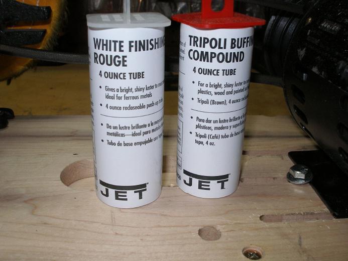

By the way, is this polishing compound what I need? I know the one is Tripoli. But what about the other one, the White Finishing Rouge? Is that similar to White Diamond? Here's a pick,
Thanks for looking,,,,,, and confirming how <s>cheap</s> frugal I am.
If the Jet 'white finishing rouge' is the same as the Ryobi 'white finishing rouge', then yes, it's basically white diamond. Why are your buffing wheels green? Looks like you been using axle grease to buff with! hehe
Not quite. Those were buffing wheels for polishing metal. I used them to polish a few shell casing also. Like I said, I need to get a couple of good ones.
I was hoping that was the correct compound. I thought it looked pretty good. The folks at the Woodworkers Emporium are not the most helpful bunch you have ever met. To busy with regulars and trying to sell machines.
Nice job! I have a similar setup for metal polishing, I use the Beall system for wood. Just one thought - you might want to cobble together some sort of guard for the belt to keep your fingers and sleeves out of it.

That looks like a nice job. I would have preferred to see the switch placed at the front of the buffer so there was no temptation to reach over the turning wheels to turn it off.

Nice setup but how do you keep it from dancing across your workbench?
I clamp it down to the edge of the work bench.
I placed the switch there because I ran out of cord and didn't want to extend it.
