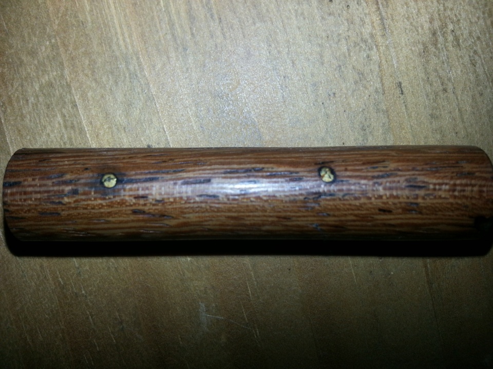

Hey,
I've only turned a dozen or so pens, so I am still figuring things out. I recently started turning a piece for a Sierra pen. As I was rounding it out, I started seeing a lot of holes within the wood. I could tell that some went clear through to the tube. I had heard reference to people filling in imperfections with CA/superglue, so did that for practice, using some random Harbor Freight super glue. This did smooth out/fill the holes, though it also sunk into the wood and darkened it a lot in the areas I poured it. I turned/sanded the darkness out to end up with a relatively smooth blank. This catches y'all up and brings me to my two questions:
1) What do y'all do when presented with hidden holes in the wood that are deep enough to show the tube? Is there a way to fill them, or is the tube just going to be visible?
2) What should I do with this blank? I could jam it on a Sierra kit, but seeing the tube through a few little holes seems pretty... rough. Is it worth wasting a kit on, or do I toss it?
Thanks!
-Will

This kind of problem will present itself when working with reclaimed wood ... those appear to be nail holes.
The typical fix is actually .... take some wood dust/shavings from the wood you are working with and fill the hole, then soak with CA to fill it and seal it ...
Those are fairly big holes, though ... I'ld turn the wood off the brass tubes to save them, and try again with another piece of wood. :)
Bummer! You will probably get three dozen ways to fill a hole so I will just give my you my thought with what I see.
Either turn the wood off the tube and start with new wood or....make a bunch more holes similar to those down to the brass and then fill with CA and call it a design opportunity!
Black colored epoxy to fill can work well. Common technique with mesquite.
Coffee grounds, smashed up turquoise, etc.
Inflate is sold in many colors for such uses.

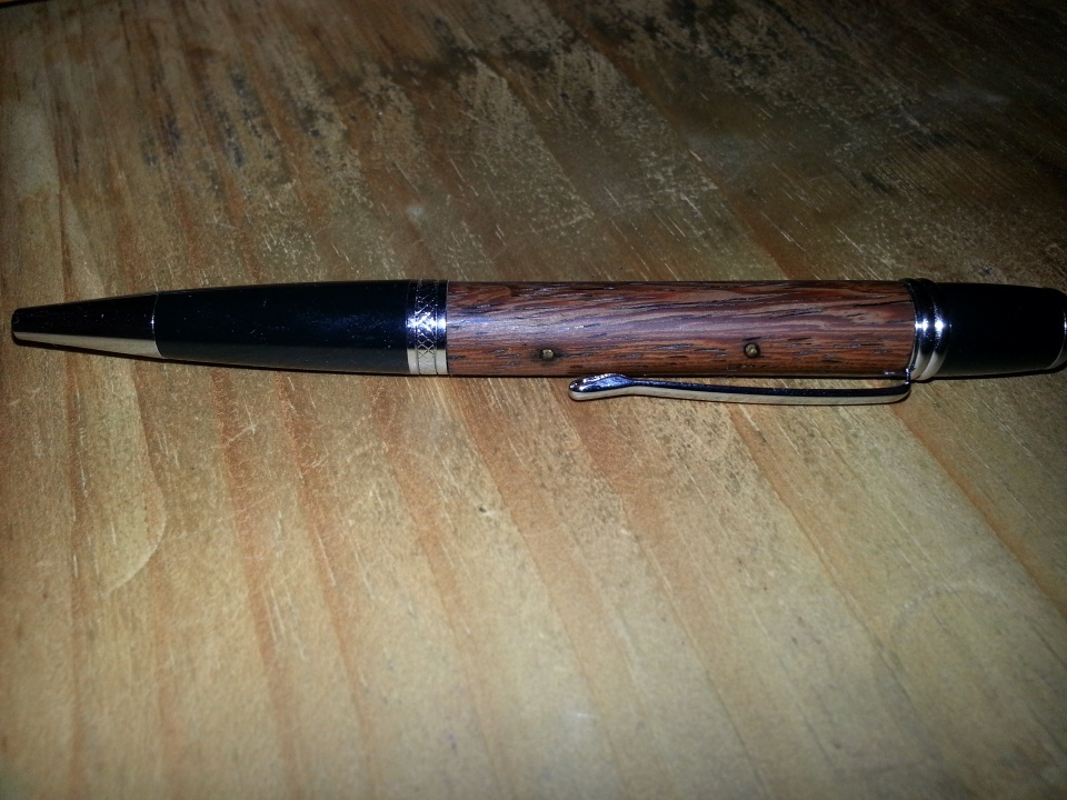

Thank y'all! In the end, I did opt to put a basic kit on it because I had learned enough from making it that I figured the pen deserved it! Either I can give it to a friend having a rough day or add it to a tip or something!
