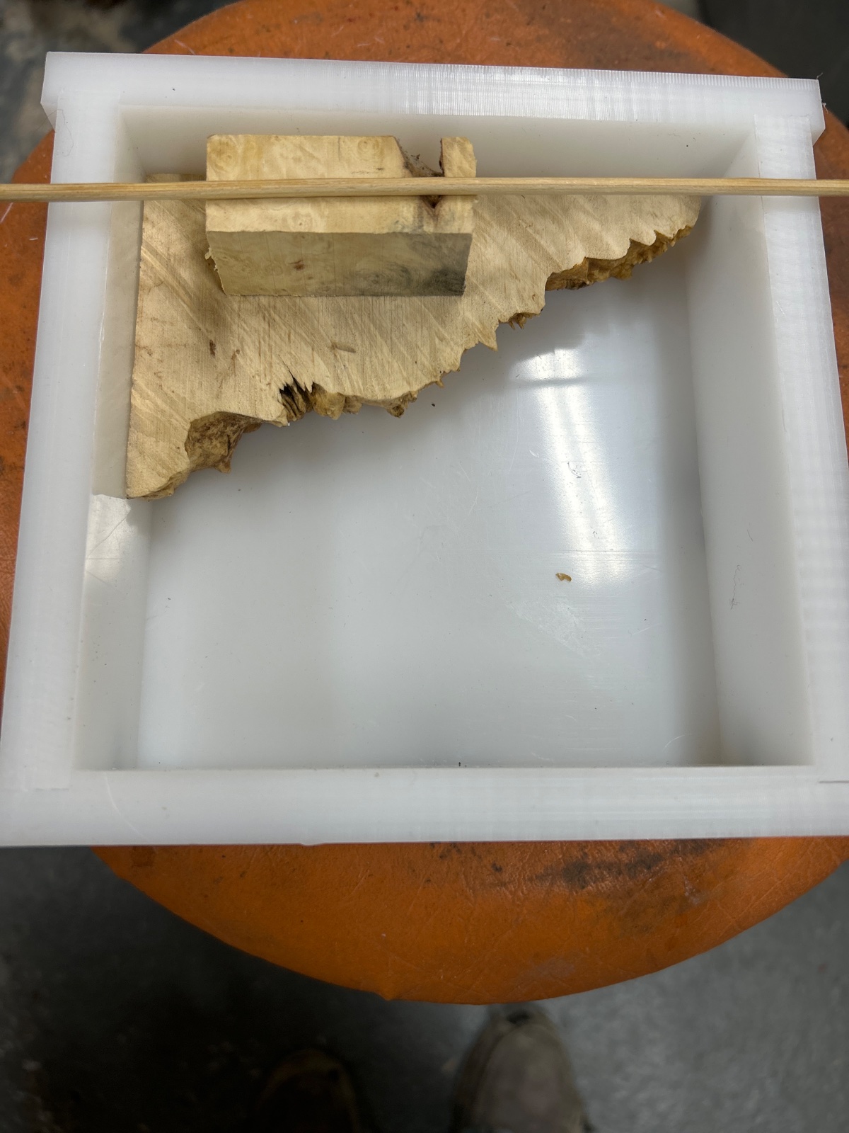

The above posts are good, also… I often put a small block of wood on top of the pieces being cast, and then place a skewer or popsicle stick across that and tape or clamp it in place. After being cast, I cut the scrap piece off.
