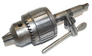

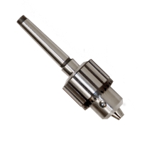

What a coincident! Thursday, after the turkey, I had decided to order a new chuck for drilling that has a 1/4" x 20 thread for a draw bolt instead of a "tang" that is found on some chucks. My lathe has a hole thru the hand wheel on the tailstock, so for future drilling I intend to use a draw-bar for the next level of safety!
I checked my chuck & sure enough, it's a tang end, not a threaded end.
I might have to buy a threaded end chuck to be safe & sure.
Thanks for posting the pic. I had no idea there were different models of chucks. Pretty sweet. :smile:
Threaded tang?
Do you have a source for the arbors with the threaded tang?
