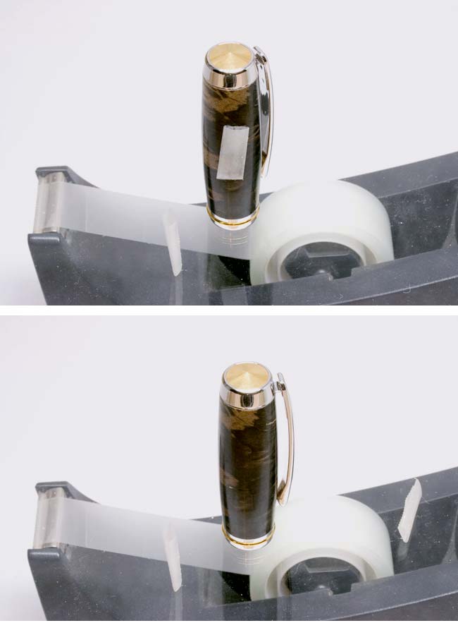

Kiddo said:
Been going bananas trying to get pens to "stay-put" when shooting them.
No need to turn into a fruit to hold a pen still. I use Scotch tape works great and very fast. Scotch brand is nice since it does not live any glue behind itself. So far no problems with the finishes. It even helps on fabric too.
Just cut a vare short piece of it 3/4" or so and tri fold it as you can see on the pics it is easy and it hold the pen at a rather steep angle.
Hope it helps
Alex
