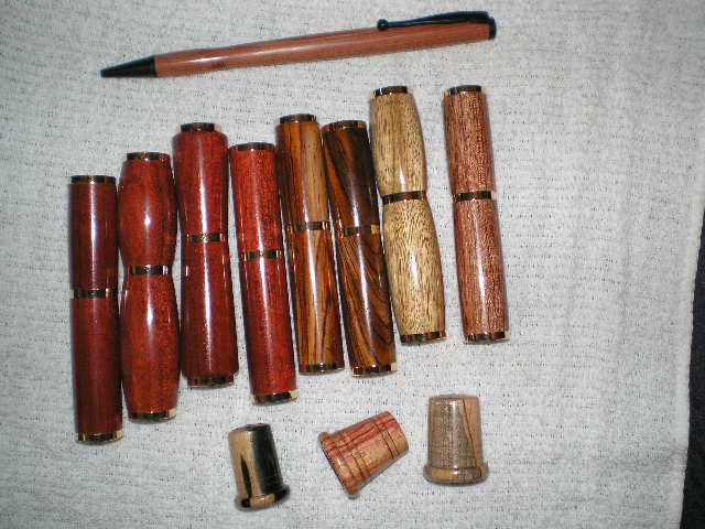

Hi Greg, I have made a bunch of thimbles for my sister who is into quilting. I use one of the tapered cutters on pen blank remnants in the blank vise with drill press, then using a jam fixture in my wood lathe I turn o.d. and end. I made a fixture that goes over thimble and puts the little divots on the end. Use a dremal with a small sanding drum to smooth out chatter marks inside thimble. I will post picture with a couple I made. The other items in picture are perfume spritzers with out the spritzer. I sell them as needle holders to the ladies who sew.

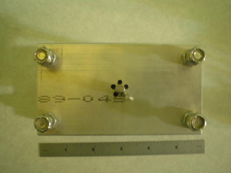

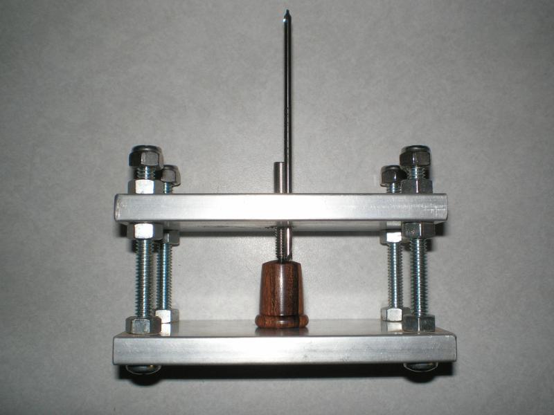

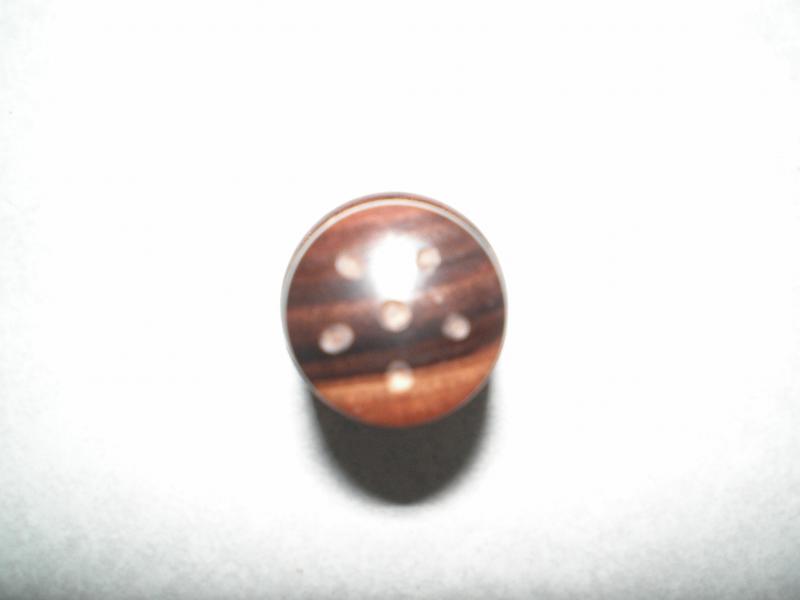

Thanks for the "brilliant" comments. Needle holders are good sellers (take the hint). Back to the thimbles, hopefully not hijacking this thread, but expanding on the original question. Posting pictures of my fixture. When thimble is finish turned on jam chuck, while lathe still spinning, move center in and establish a center "spot" on thimble. remove thimble and use fixture as shown to add five more spots. I used a 5/16 dia. 5 hole bolt hole patern for the fixture, holes reamed to 1/8" dia. I use #1 X 4 inch long center drill and hand twist. It does not take much. Center bolt for locating on the center spot that was put on by the lathe center is a 8-32 bolt with 1 inch thread, threaded end radius'd and head turned almost flush with thread dia. for clearance. Pictures should explain a lot, sorry for the poor photogaphy. Thimble end showing spots had a lot of glare. The spots are really nice and round. It looks a lot nicer in real life.
