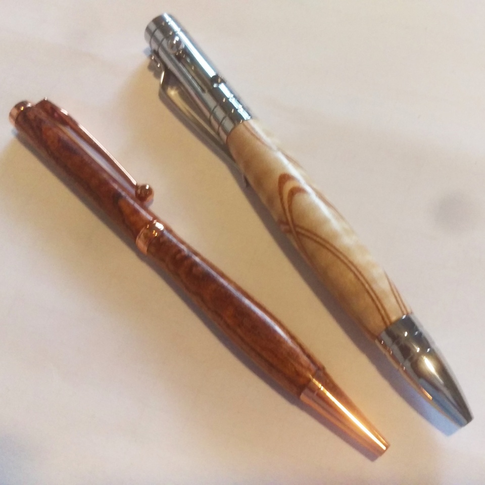

Hi all, just wanted to get your opinions on pen kits that are higher quality than slimlines but somewhat similar.
The things I like about slimlines is the sleek profile and high percentage of wood vs components, with their ability to really shape the profile how I see fit.
So basically, I'm looking for recommendations for ball point kits that are a good replacement for slimlines.
I can't stand sierra style or the bolt actions with the bullet casing shaped barrel/nib.
If my attempt at attaching a picture works, you will see a couple of my pens. A slimline with the profile I find most comfortable to write with (very slight bulge to the front of the lower barrel, straight the rest of the way) and 'monogram' pen (also called a tech pen by other retailers) which I should have made straighter. I'll end up disassembling it and turning it into a straight barrel rather than the bulged one.

I am in the process of trying different brands of slimlines. Just bought some dayacom slims from Exotic blanks. So far I think I prefer them. I like the finish better and the transmission seems smoother in the few that I have.
I really like the slimline pro Click pen also.

Yuo can buy all the components seperately if you look around. WoodnWhimsies has everything you need. Or Buy 10 inch long 7mm tubes and make the bottom longer if you want and just push the tranny in the tube farther using a kits hardware if you find a kit you like. Is the Euro style pen something you could use?

Thanks for the tips. I'll have to check out the Dayacom slimlines, not sure where the best place to source them in Australia is but if I can't find somewhere, the next time I order specialty blanks from exoticblanks I'll have to add those to the order.
Exotic blanks are a fantastic company, but shipping to Australia is nightmarishly expensive!
The Euro is worth looking at. I'm not totally sold on the aesthetic based on the pictures but I think I would have to hold one to truly see if I like it.
I did just stumble across the Executive Clicker pen which is available in a Rhodium plating (my favourite plating)
Executive Clicker Pen Kits - Timberbits - Made in Taiwan
Slightly thicker than I prefer but might be worth a shot, as it would really show off your wood

On a related note, I've always wanted the premium designer kit to be offered in a better plating than 24kt gold. I made one a while back and it seemed like a good kit.
https://www.pennstateind.com/store/PKMONT2PAR.html
For your question, what is it about the slimline that you don't like? If it's plating quality I believe there are upgrade options available like the Titanium Nitride stuff. If it's the writing quality you can get upgrade refills, including official Cross refills, that really help in that area (I would argue it's as important as the outer pen body). If it's the design then you have a lot of freedom to change it, the slimline is probably the most versatile kit in the hobby (search for slimline contests on here to see what I mean). If it's the twist transmission, which I would agree is one of the weakest parts of the kit, then you do have the option to shop around and find higher quality replacement transmissions. I never actually did that last one myself, but I'm confident there are really good ones out there.

The ONLY thing I don't like about the slimline kits is the plating. They just tend to flake off so soon. Everything else about them I love. I have a pack of upgraded refills, they are a comfortable size for most people to write with. I like customising the shape for more comfort, they show off the wood. I love them. But because the plating is usually crap, they feel cheap.
I'd be happy to pay more for slimlines that are solid shiny stainless steel just so I know they will be super durable.
The Titanium Nitride stuff you mentioned sounds good, but having a hard time finding a supplier in Australia that specifies that on the description. Most of the gold ones are 24ct and the silver just states silver or chrome. But now I know what to look out for.
If shipping from the states wasn't so insanely expensive, life would be good.

If any of your suppliers have a Comfort style try that. They come with a rubber grip but you just don't use it. They look just like a slimline but are very slightly thicker and better quality.
