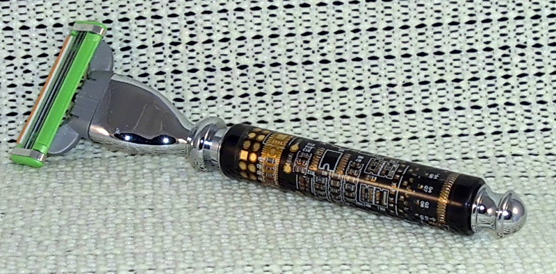

I have done a few razors in truestone and buffalo horn ,for durability (harsh bathroom conditions) soap water steam etc. This one was a request . I used a circuit board pen kit from Ernie and the chrome kit from PSI. Extended the length of the blank with black acrylic plugs glued on to the circuit board, and drilled to suit the 7 mm Tube ,not a lot of room for fancy shapes so plain jane straight handle ,looks better than my poor picture shows , cheers ~ John

Very nice! Did you use the circuit board kit that normally fits a Sierra, or is there a kit with a 7mm tube?
Its the sierra kit with extensions for the ends in black acrilic ,drilled to suit 7 mm tubes for the razor kit.

Very nice John. My son-in-law wants a computer razor and I was reluctant to make one, thanks to you I will give it a go.
If you need more detailed explanation send me a mail :) for how I actually did this one ,quite easy :) cheers ~ John

Too cool! Is that the new and improved "Electric Razor"? :biggrin::biggrin::)
