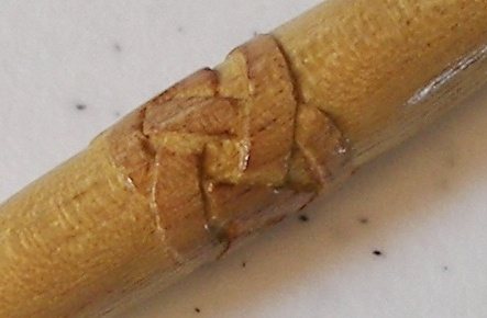

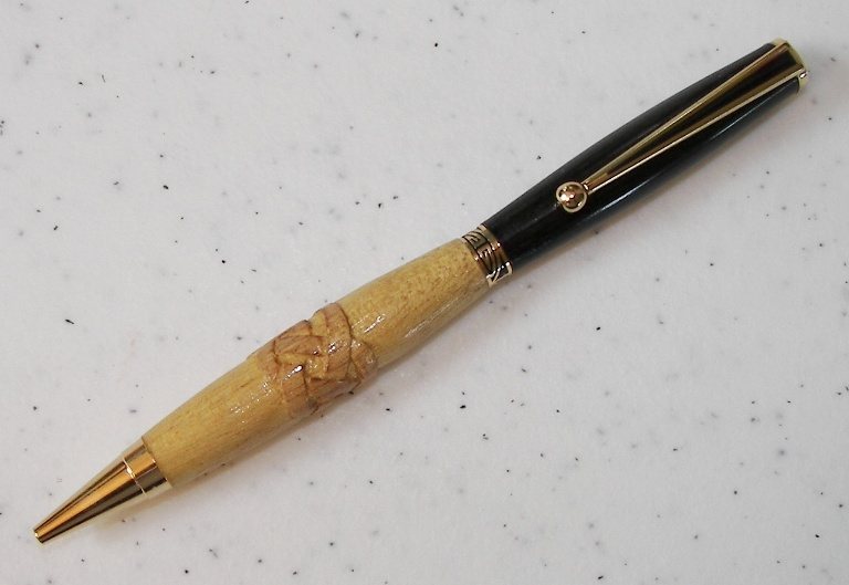

I used an exacto knife to carve this one.

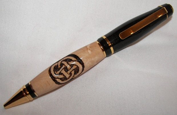

This one I used a powercrafter rotary carver and a woodburner.

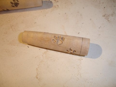

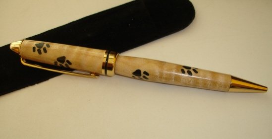

I use a dremel with very tiny bits, though the smallest I have is too big for fine detail. I don't have any pictures but I recently did one for an elementary school music teacher with music notes on it. It came out great but I think a better job could have been done with a scroll saw and number 2 blade to cut the fine detail in, while also making the note on both sides of the pen. If you use a dremel, get the smallest bit set you can, woodcraft sells them and try it out on something large, like a cigar pen first. Just get it round and then hit it with the dremel to get a feel for the size of the cuts. You can make some very nice inlays, like the one Jeff posted above, it's fairly easy and people love them. I've sold several pens with paw prints, women seem to really be drawn to them...
