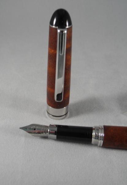

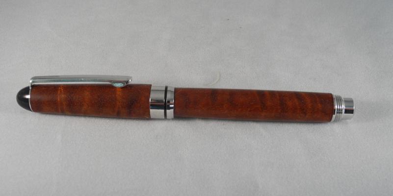

I have been making FP's for several years. Berea makes a screw-top postable Fountain and Rollerball called the Streamline. Here is a link to one of pens in the series: Streamline American™ - Screw Cap - Roller Ball 24Kt Gold Pen Kit Making Supplies Berea HardWoods
They use a 'V' letter series drill, which corresponds to 9.5 mm. These are very nice pens with an Iridium tip (not steel).
I have made the Vertex pens just to try them, but was not pleased with the plating (Chinese origin).
I have attached 2 pics showing the pen and nib.
