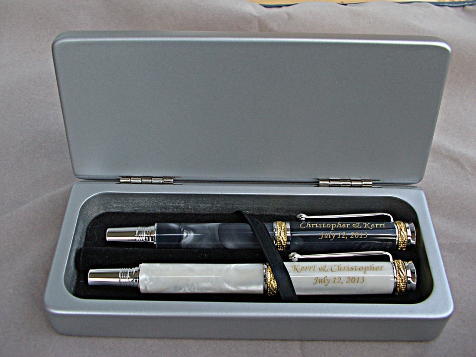

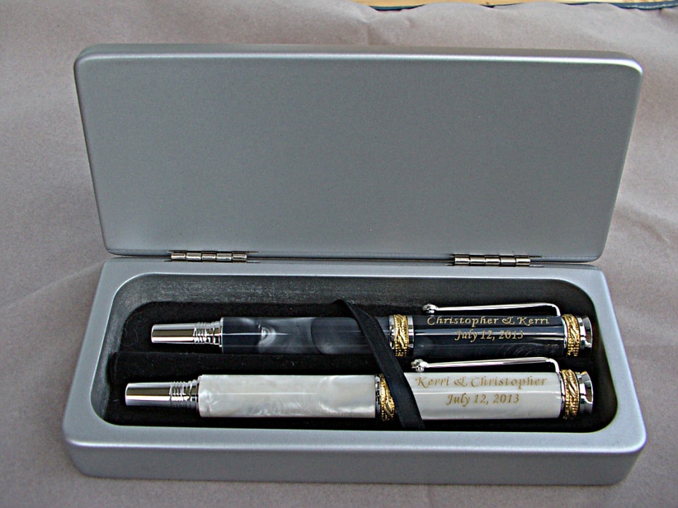

"High End" is a subjective term. Here is a couple I did for my Nephew and his bride. Majestic and Majestic JR from PSI. To me the majestic line matches any highend line out there.
