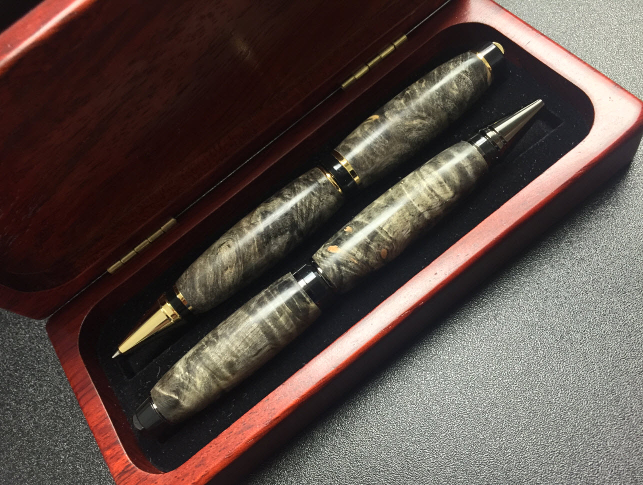

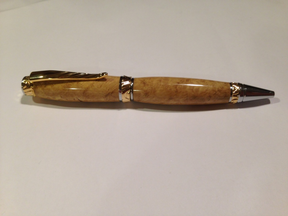

I`m looking for a nice, robust mechanical pencil kit. I have a customer who purchased an ornate cigar pen I made out of Acacia burl, and would like a matching mechanical pencil. Robust size, and he has asked that the mechanism has a very thin metal tube that hold the lead at the point. Some of the higher quality pencils have this. It prevents the lead from breaking off easily. The tube sheaths the lead for about 1/8" beyond the end of the nib. Any suggestions? I'll attach a photo of the pen.
Thanks,
Jake

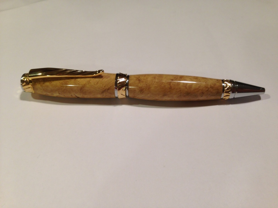

I have made a few of the cigar pencils, they are ok, see pen pencil set below. They tend to rattle a little. The tubes are identical to other cigar pens, and so is the top clip assembly, but everything else is custom, you also really cant swap out the rings to jazz it up.

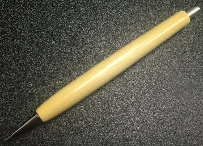

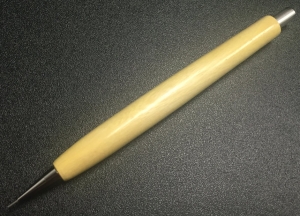

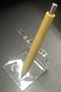

You could make a pentel pencil that has had a face lift, with a large diameter body. This is not an easy pencil to make, the very end is fragile when turning. I have a post with more explicit directions (http://www.penturners.org/forum/f13/pentel-pencil-142379/). The pentel comes is .5, .7 and .9mm. The mechanism is one of the best out there. But it requires some special equipment as noted in my post. I know this does not satisfy your ornate requirement. Just a thought.
