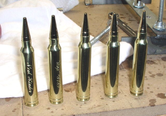

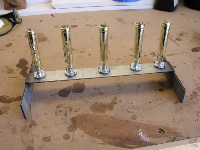

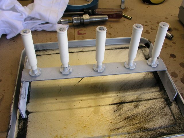

I use the Eastwood Gun, but have heard good things about the HF gun. I have a very large Toaster over than I purchased from Walmart on sale for 39 bucks, if I recall. It has a thermostat on it which is plenty accurate for PC. I welded a small rack for my bullet casings. 400 degrees for the cure flow temp, backed down to around 350 degrees for 20 minutes is about all you need. You only need 8-10 working psi for your gun, so even the smallest of compressors will work fine.
Really in my opinion, the HF oven is not cost effective. For the small size interior space that it offers, you can get a used kitchen oven for next to nothing that will yield the same results. The vapors created by the flowing powders is not good. I wear a respirator when blowing the coat, and use a cross fan to blow the fumes out my garage door when flowing it out. Once the powder has flowed (Gone from powder to a smooth liquid) the fumes greatly dissipate, though I still keep the fan running.

I;ve noticed that after a few uses my jig (to hold the coated pieces) has a nice thick coat of powder(baked on). I'm thinking the melted powder is affecting the conductivity of the attached gator clip. Do yuou brush off the powder from your jig prior to baking? Your jig looks cleaner than mine, which is covered with various colors of baked on powder. I've also discovered that jigs made from galvanized or zinc plated metal parts seems to hamper electrical connections needed to stick the powder. What are your thoughts on these?

Oh!!! FANGAR - who does your metal engraving on the brass casings?

Jay,
I have a local guy in Sacramento that does them for me. Great work at a great price. I drop them off and pick them up a day or so later. In a pinch, he does them while I wait. Great guy.

Don,
You are absolutely correct in your thinking. Mine looks clean as I glass blast it off every so often. If you plan on doing any larger parts, you might invest in a small cabinet from HF. Or they make a nice little gun that can shoot sand with. I used to do that. Just take the parts out in the yard and the sand goes into the grass. But if you don't clean the parts eventually you will get far less a charge parts.

Thanks, James
The engraving really looks classy. Do you knowing whether he used an "engraving machine" or does he do it by hand?
20-years ago, I went to Arkansas and studied under a man who used the GRS (pneumatic) tiny "air hammer" system. I left there and practiced for several months on an identicle system - then, things happened and I ceased to practice. My goal was gun and knife engraving. Today, in a special little room, sits my Gravermeister engraving system and all the accessories necessary - and I still don't know how to do it. I tried a couple of things, but when it comes to hand engraving on a "cylinder", it's a whole new ball game - not like working on a flat practice piece. At my present age, I kinda think I'll never be a good (or even an acceptable) engraver.
Thanks for any further information on his technique.
