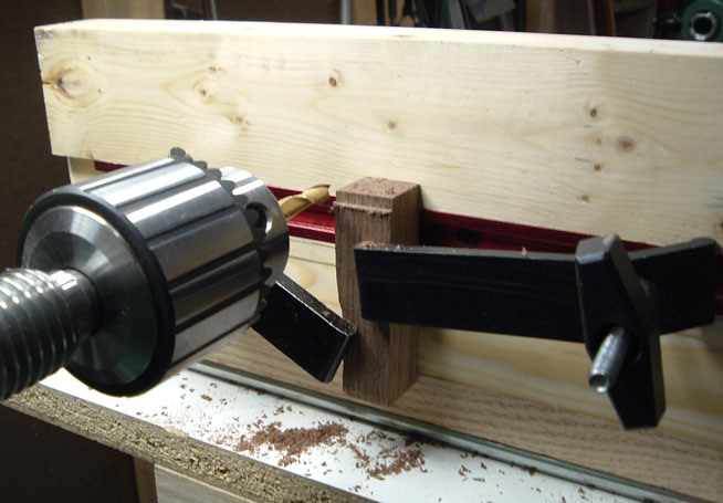

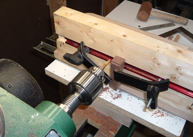

Well, I don't think anyone has done it quite like this but for what I need it will do.
I decided to try this as opposed to a cross slide table, which I will get later anyway.
I needed a way to mill a shallow section out of some cherry for an upcoming project and this will do that.
No, it is not at all rock solid. However, if I take shallow bites and run the lathe at top speed, it does a good job.
The section that holds the stock rides on 2 bottom mount drawer slides. That assembly gives me the side-to-side movement and the whole thing sits on a platform that rides the lathe ways with a banjo type clamp to hold it in place.
I'm debating on a leadscrew being added to make the feed easier and more consistent.
The bit is a 1/4" 2 flute solid carbide endmill used for metal. The chuck has a drawbar attached.

That cut showing is just a test as the bit only arrived this afternoon.

For this, you might want to try a three or four flute mill. with a higher RPM speed and more flutes doing the cutting, it'll take smaller bites of the wood and won't be so grabby and smoother sliding if you don't want to add a feed screw. But the feed screw would be the better idea. You also might consider looking for a collet chuck that threads onto your headstock for the end mill. Using a MT2 drill chuck could come loose and bite into your work piece and possibly break your cutter.
