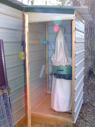

One suggestion - if you have the room - the machine tends to be pretty loud, so if you can, build a wall around it inside the shop or build a separate closet/shed outside the shop and pipe through the walls... I put mine outside the shop and most I get is a low hum ...
