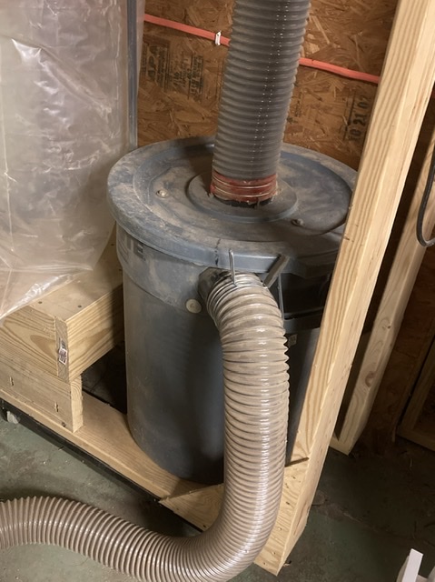

Trash can with Thein Baffle inside.

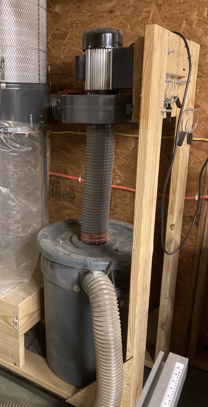

Vertical, top mounted blower hooked directly to collector collar.

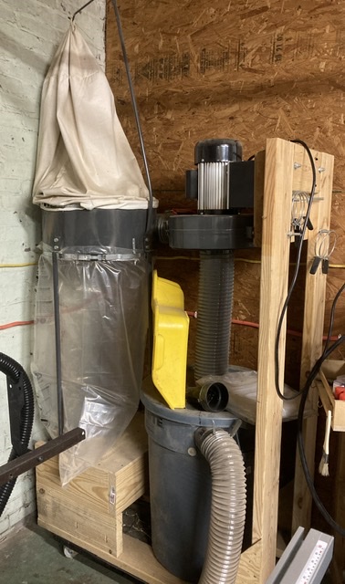

Prior to last upgrade.

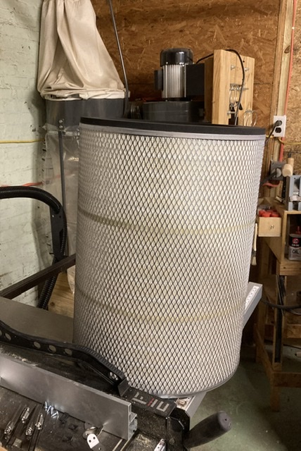

The Wynn filter 35C222NANO Cartridge Kit

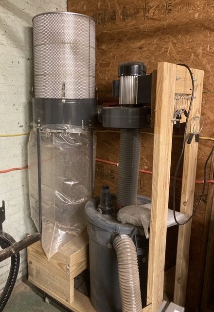

The end result. Noise dropped by 3db to 93 db at 3 feet and 87 db at 6 feet.
I wish I had previously taken amperage readings on the blower motor. It is now working much less. Previously the dust filter bag and the dust collection bag were stretched skin tight with and open 4" hose 6 feet long. Now, with something like 600 percent more surface area on the exhaust, the collection bag still swirls the fine dust nicely and is inflated but is quite relaxed.

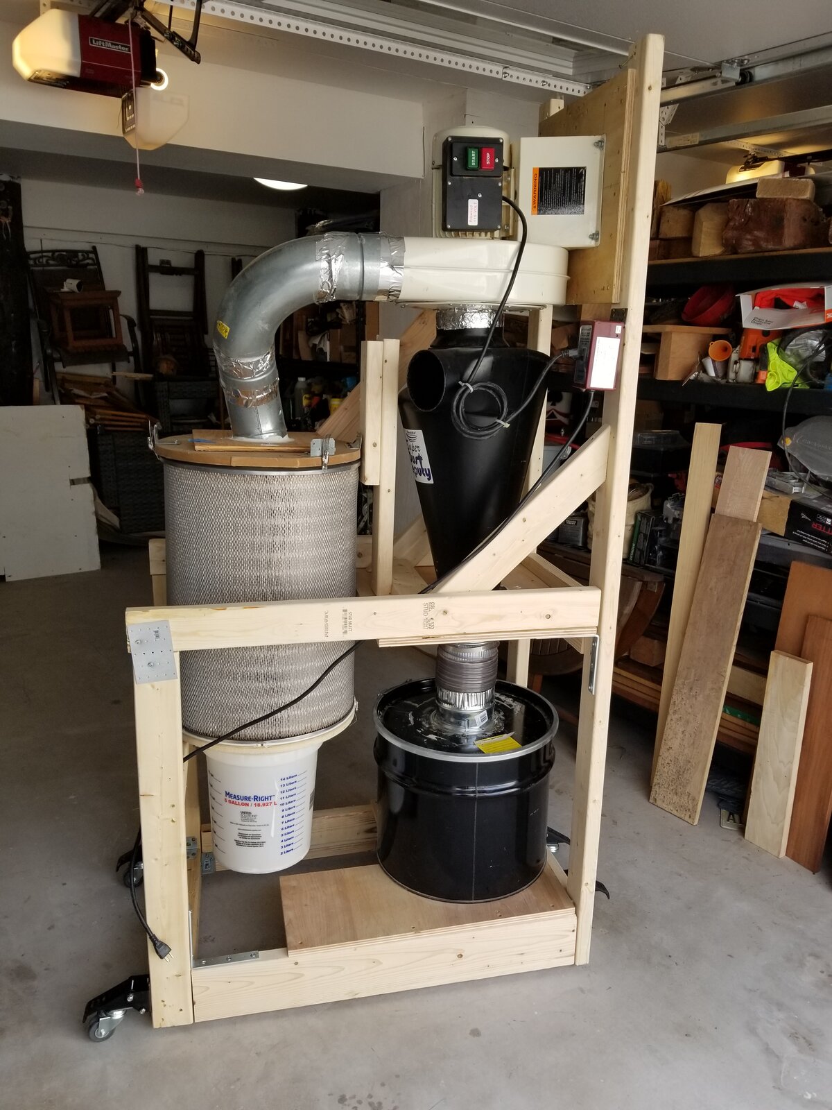

I have been using the same filter in a Jet modified 1100. I added an Omega Super Dust deputy to the setup, removed the Jet cyclone ring, and added a 20 gal pail for the final dust. Works pretty nicely. I highly recommend the Wynn filters - and if you do a modified setup, try his filter clamps out - they work well - you can see them in the pics on the plywood filter top attached to construction angle braces.
