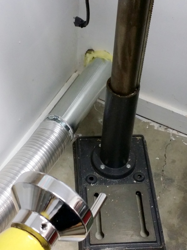

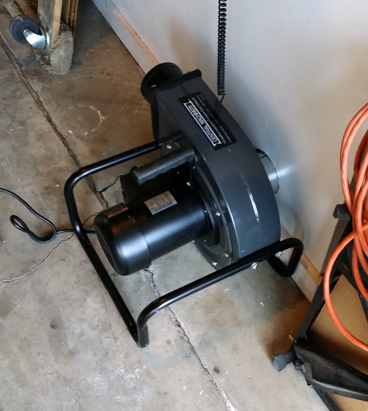

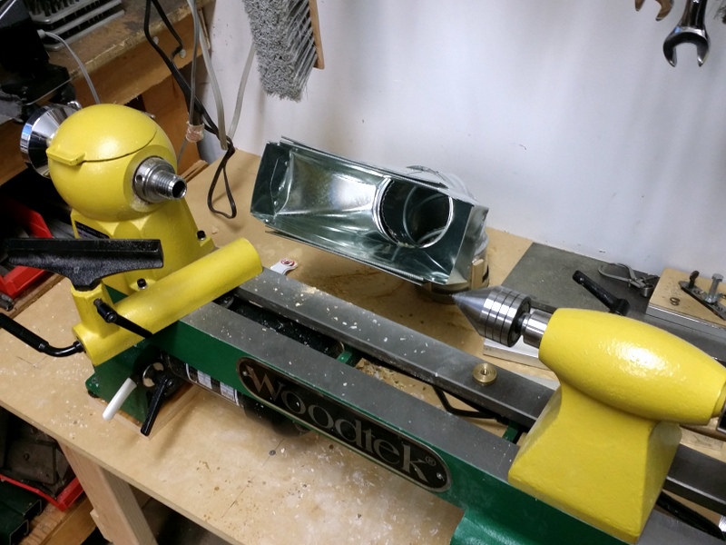

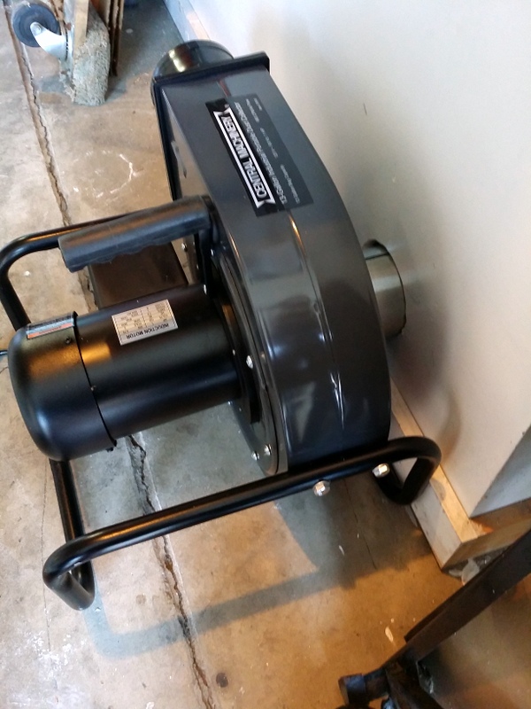

Friday I bought the HF grey 13 cubic foot DC. I had been looking at the smaller red unit but they are no longer available and someone had just purchased the store demo. The previous evening I spent quite a bit of time researching Google. The problem with the red unit was it had a brush type motor as on a shop vac. Longevity was not to be expected when running constantly. The 13 cubic foot had great reviews. I did the installation this afternoon. It went well. Although I do not have a separator, which I will figure out later, the DC works well. I have not turned with it yet but gave it a quick dynamic test with a few handfuls of sawdust and it seems very powerful. It is put together with just one short straight run of dryer vent hose and a two foot length of tin pipe. The fittings came from Lowe's for the whopping total of $30.76. I've posted photos.
