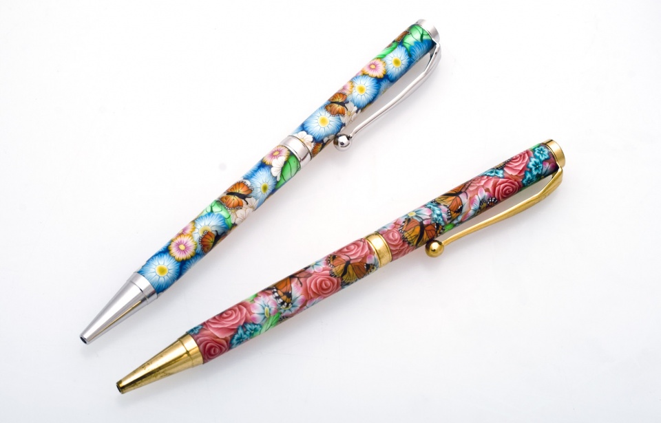

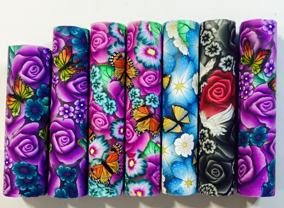

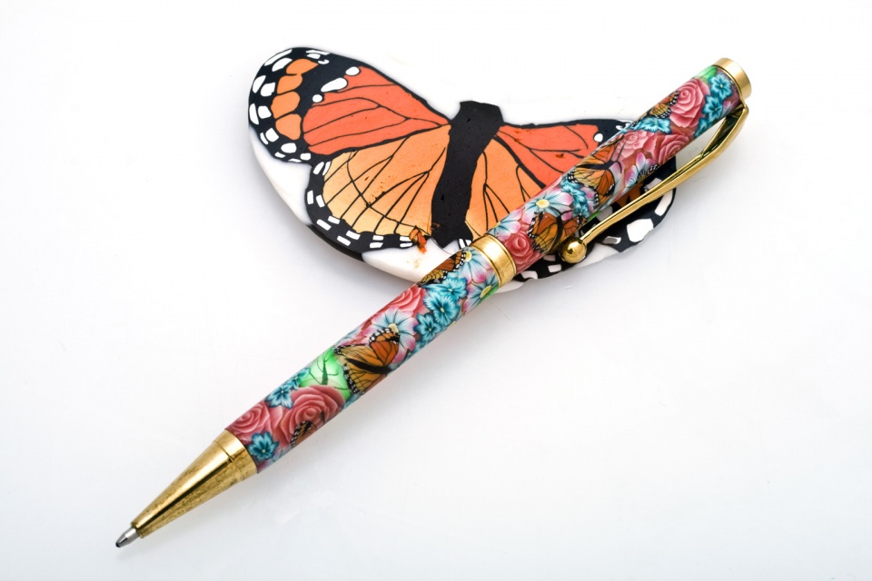

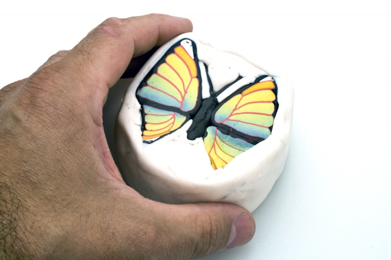

I was trying to show some insight into the complexity and how much is missed when they think painted, stickers and similar corner cutting methods.

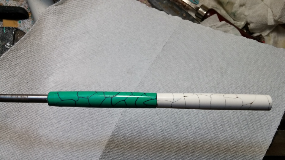

The reason I had/have to drill them is how the blank is made. I chop up the clay into random pieces and coat it with black acrylic paint. After the paint dries, the PC is laid down just like it would for real stone layer by layer. For my first try this was the best way to do it. If you look at my pic thats one section and the "layers" look just like they should. Added from the top not placed around the blank.
I'm not knocking any other technique but this is the look I'm trying to achieve and its the best way I can figure out how to do it now.
My second try didn't work out so well because I used Premo instead of the Sculpey(not III, I guess the original) I used for the test. The Sculpey after the paint dried was very oily, the Premo semi sticky. My procedure was to use a 1/2" PVC tube and compress the "layers" together. It worked better than expected for the Sculpey but since the Premo was sticky it got hung up on the sides of the PVC and not sure what happened but it didn't make nice layers. It kind of mixed the dried paint into the clay. This is what I expected for my test and again was pleasantly surprised.
I think my next test is to make more of a flat mold and come up with a way to mold the clay around the blank.
My goal is to make semi precious stone like turquoise or marble with gold running through the veins. I know I can get True Stone but I wanted to try something for myself. I bought the perfect random chunk gold glitter yesterday.

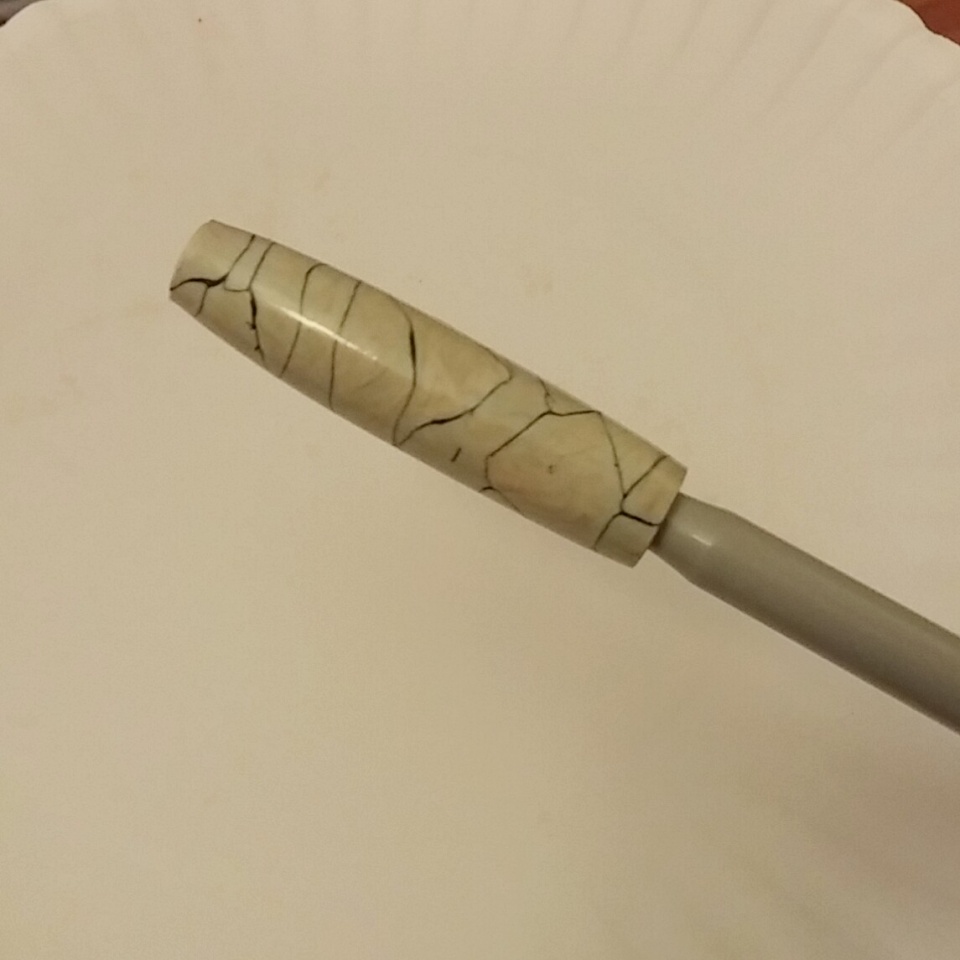

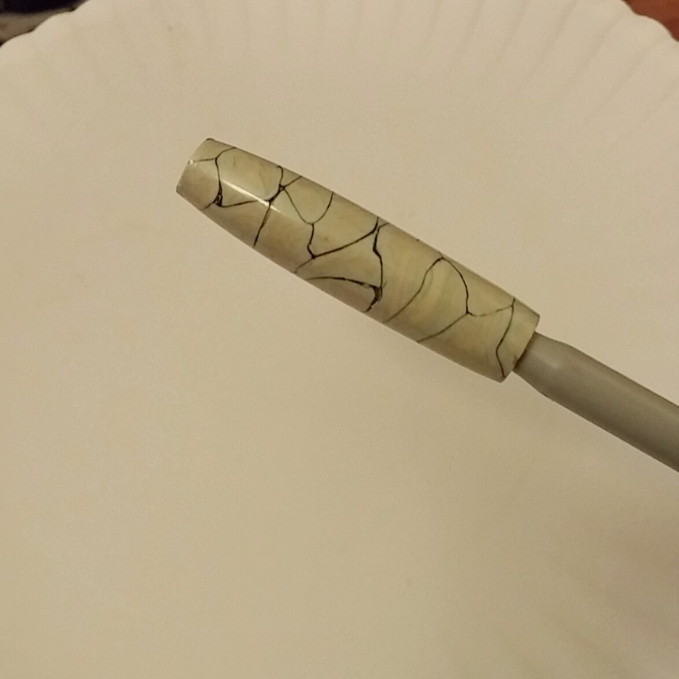

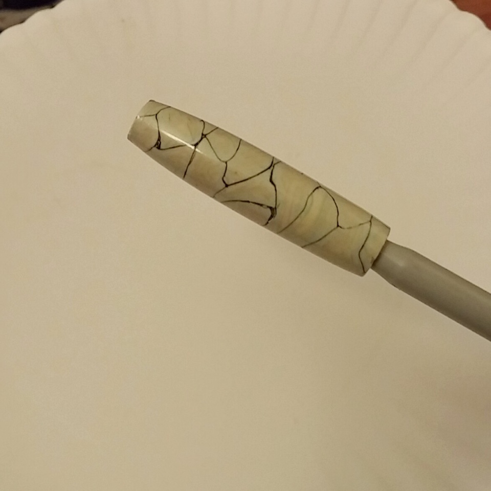

Latest try
Having issues with the finish.
These were done on tube. The "cracks" are embossing powder.
