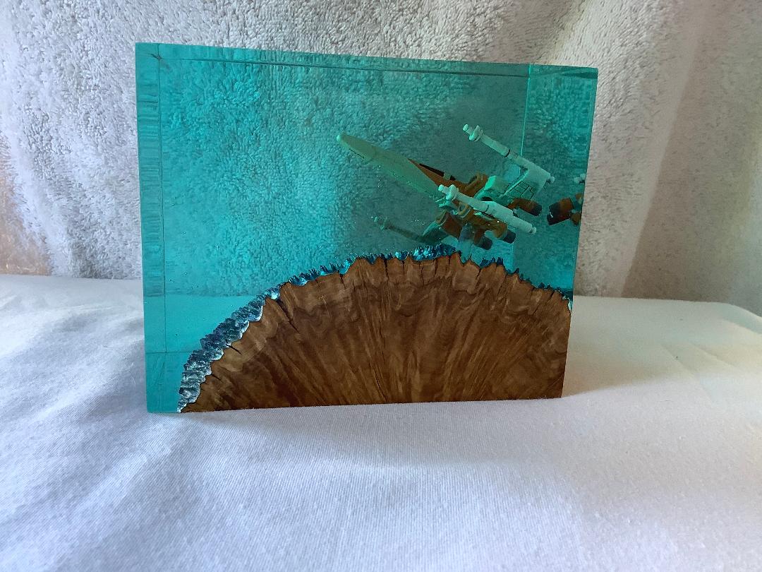

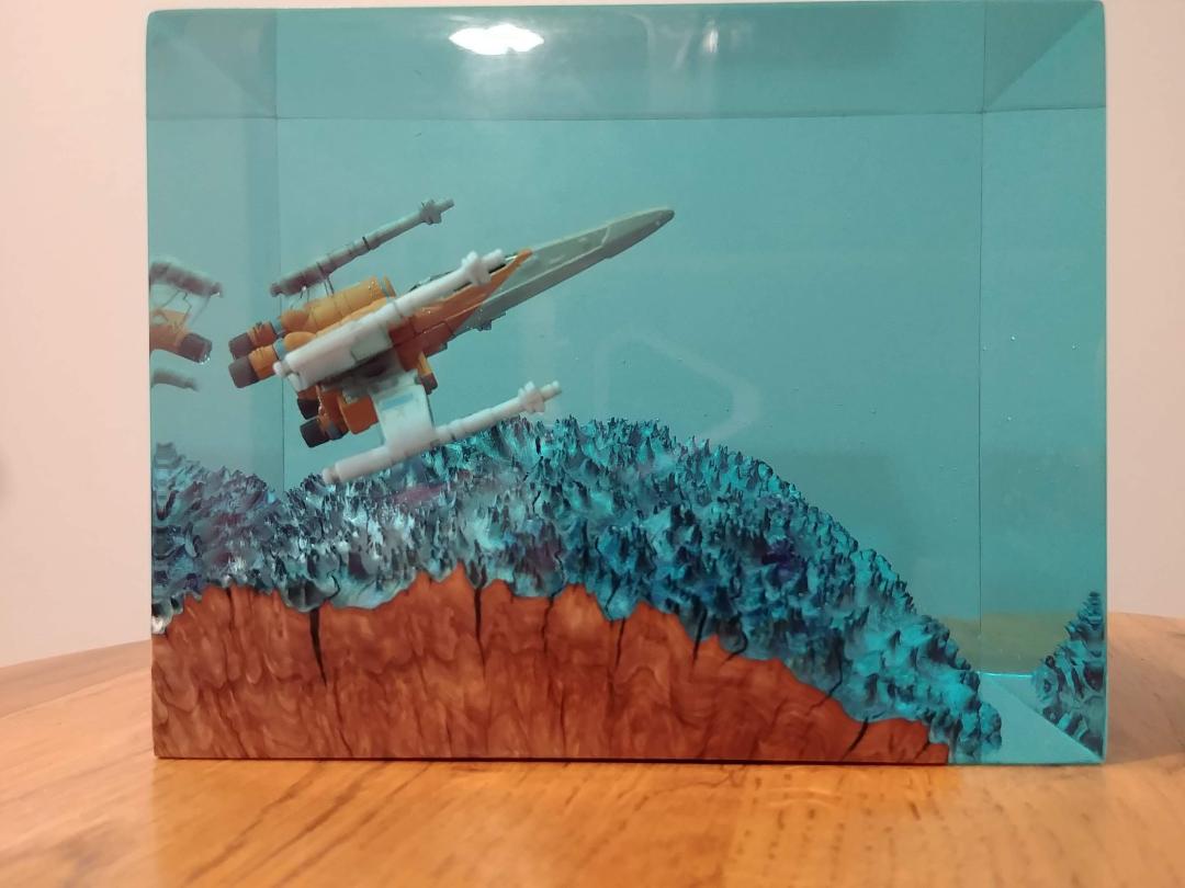

I have poured large volumes of Alumilite Clear Slow and have not had any problems. Your open times will be diminished because with that volume of resin the temperature will increase faster than a small pour. I didn't have a need for added cooling of epoxy resin.
