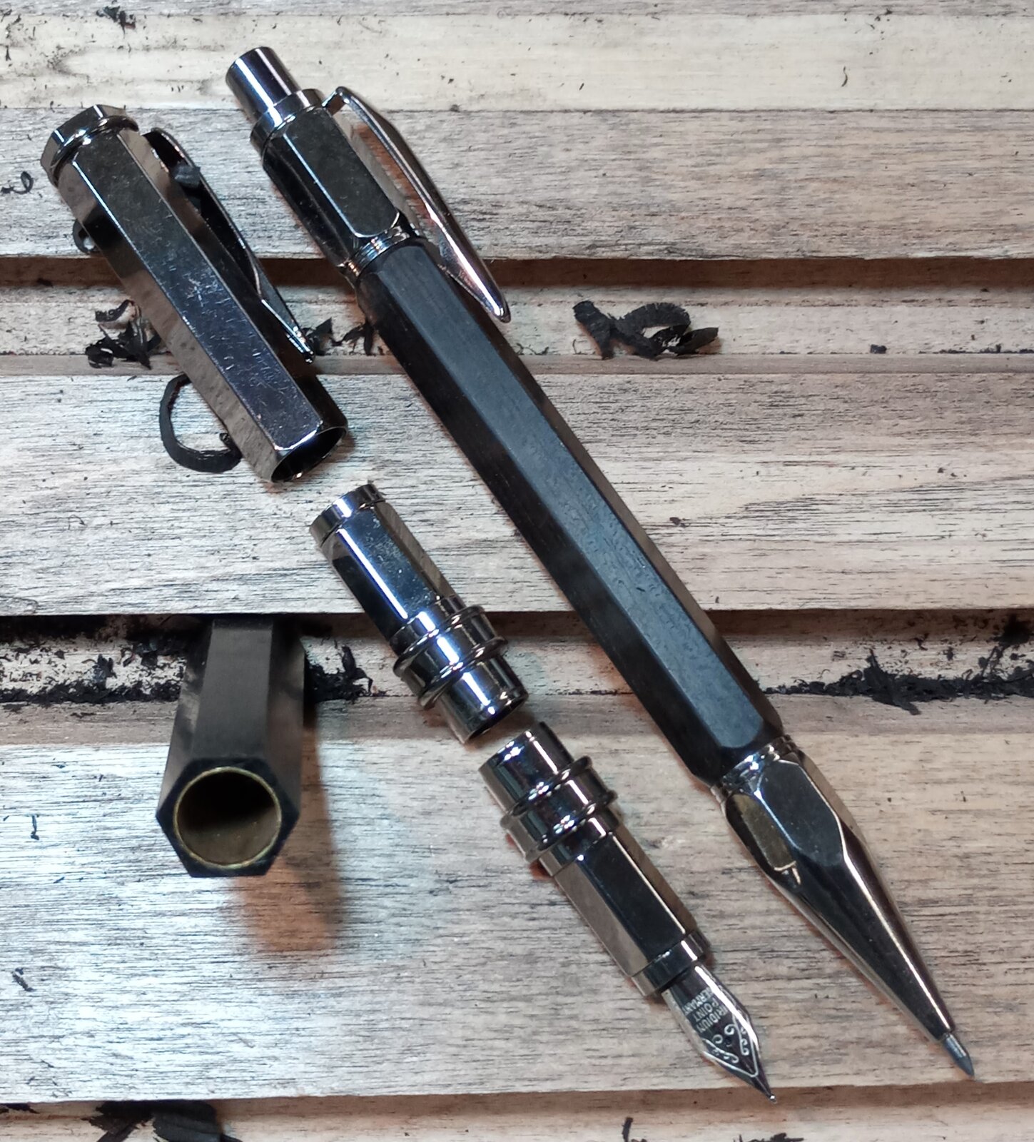

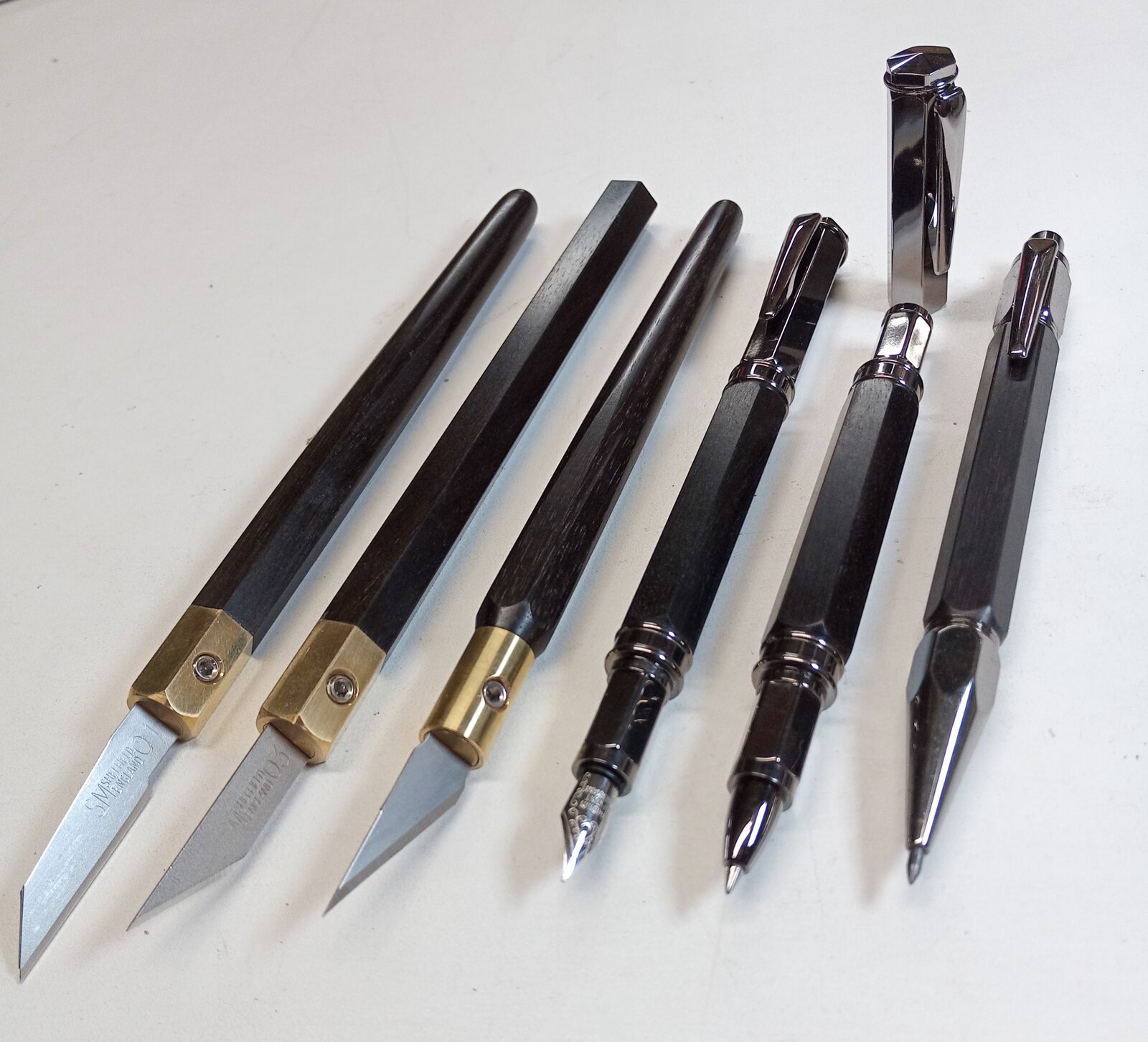

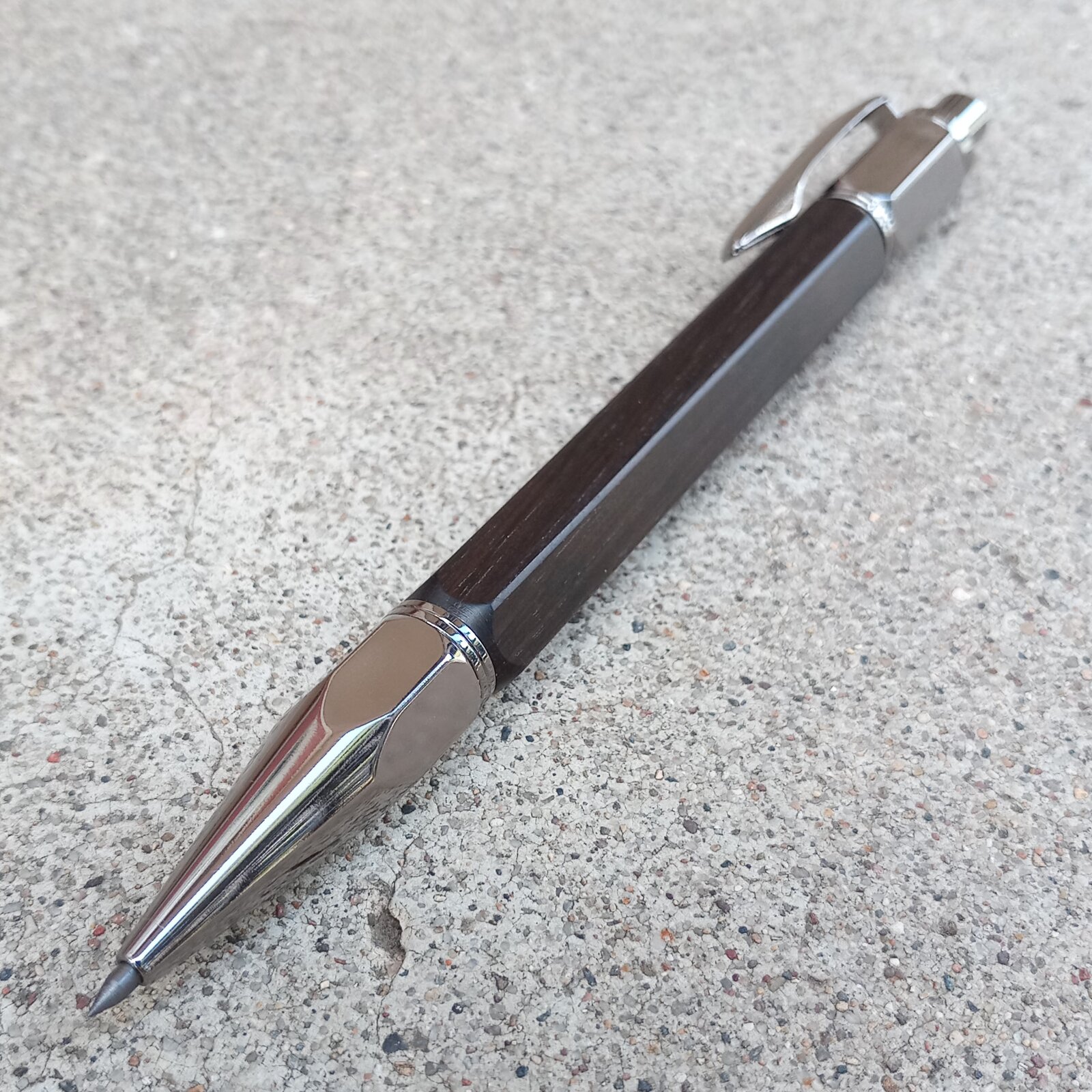

I put some hexagonal Ebony bodies on Vertex Pencil, Rollerball, and Fountain kits.
Very little turning on these, just the chamfers at the ends of the bodies. I made a little jig to cut the hexagon using a cabinet scraper.' I've been doing hexagons a while on the knives I've been making but this is the first time I did it on a tube. Should have looked here first as I see now others have done it and shared and my learning curve may have been flattened.
If you're on Instagram, I highlighted the process in a story.
