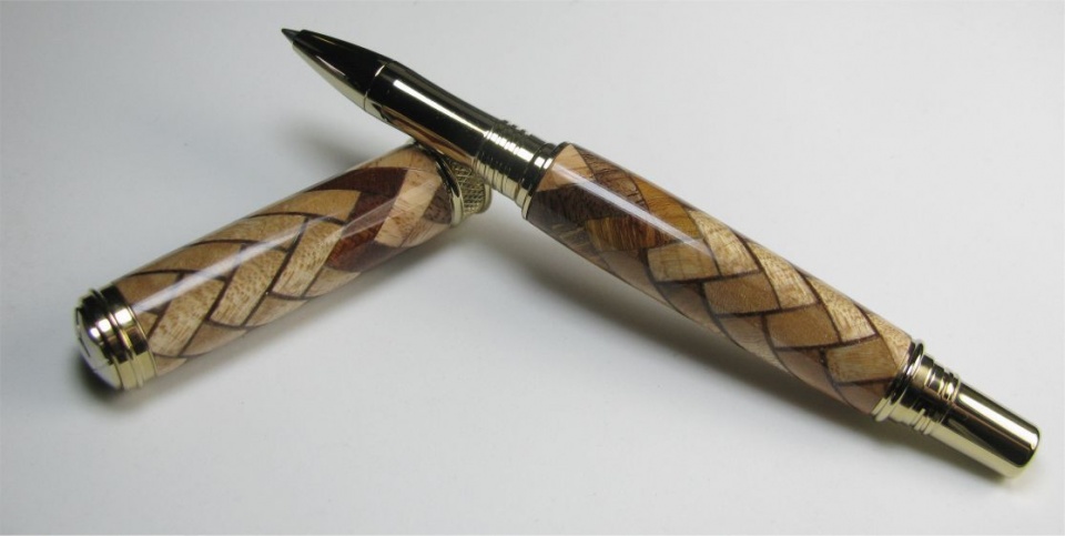

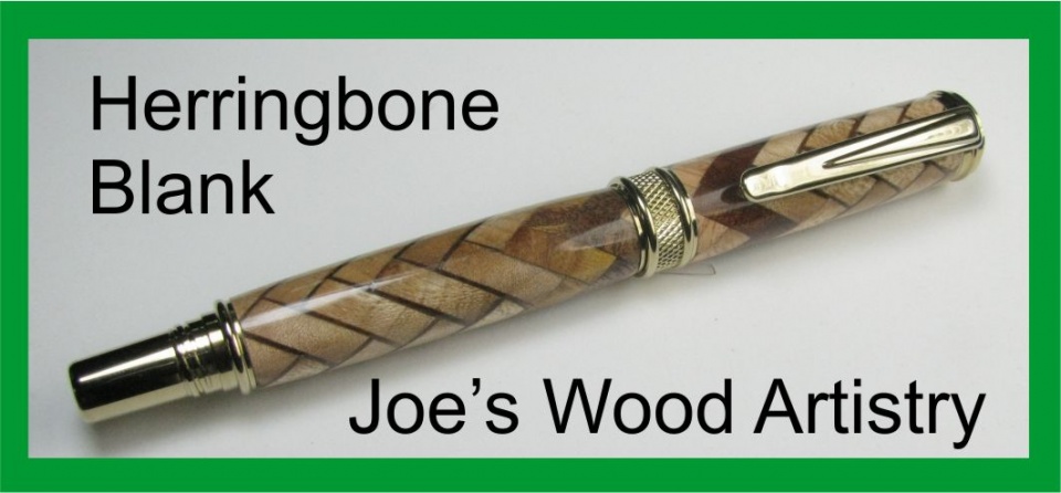

Shot some video on Friday, put the pen together today (Jr. Harold) and shot some more video (instructions on junior series). Then actually LOOKED at the pen---Joe's work is remarkable--very well made, consistent to turn and priced very modestly!!
In the shows we did, I think the pen could be sold VERY comfortably in the mid to high 100's, and I would expect some would be WAY up.
Comments always welcome!!

Beautiful blank and pen!

LOVE the picture of the pen Ed. The Kit is great but the blank is what makes that pen a keeper. Very well done.

Great job Ed !! Is the finish CA glue ? For those of you who have made Herringbone blanks ,for this wood blank , I assembled veneer between the pieces by first gluing a long piece of veneer to ONE surface of the 3/4 X 3/4 X 12 strip, then cut the wafers to the desired thickness . Before assembling the wafers , ONE end grain surface had to have veneer also glued up. When assembling the 6 wafers of wood per row , make sure you don't have two pieces of veneer glued to each other. I don't know if this makes sense or not !!!! At least I tried . If you have any questions, please ask. Thanks again Ed . Looking forward to watching and hearing the video.:embarrassed::embarrassed::embarrassed::rolleyes:
