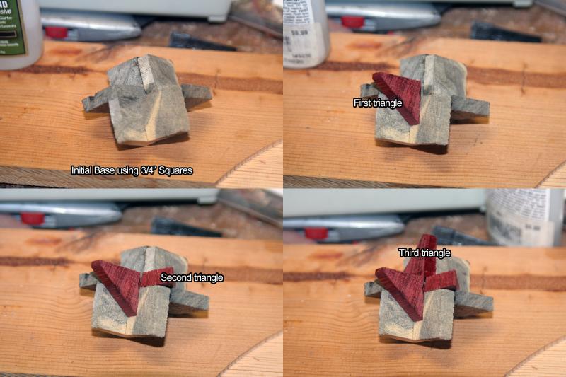

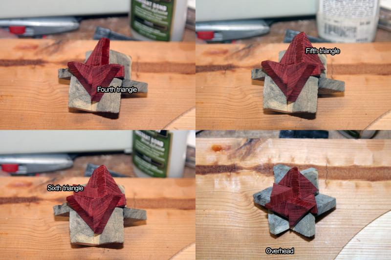

LarryDNJR
Feb 28, 2010
912
Columbus, OH
Here are some photos that might help with the glue up I was discussing.

I wonder how it would work to clip the inside corner of the 3 piece glueup where it meets with the other half to create an intentional void that will help guide the drill bit down center.
Gary I noticed as I followed Darrin's tutorial that every other course had a small square void at the center. It actually acted as a guide to keep the bit centered as I drilled it
