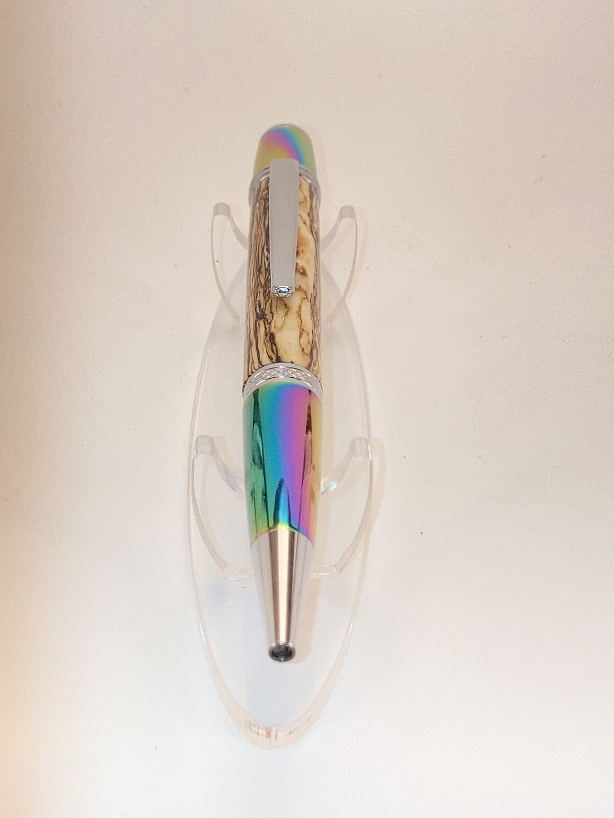

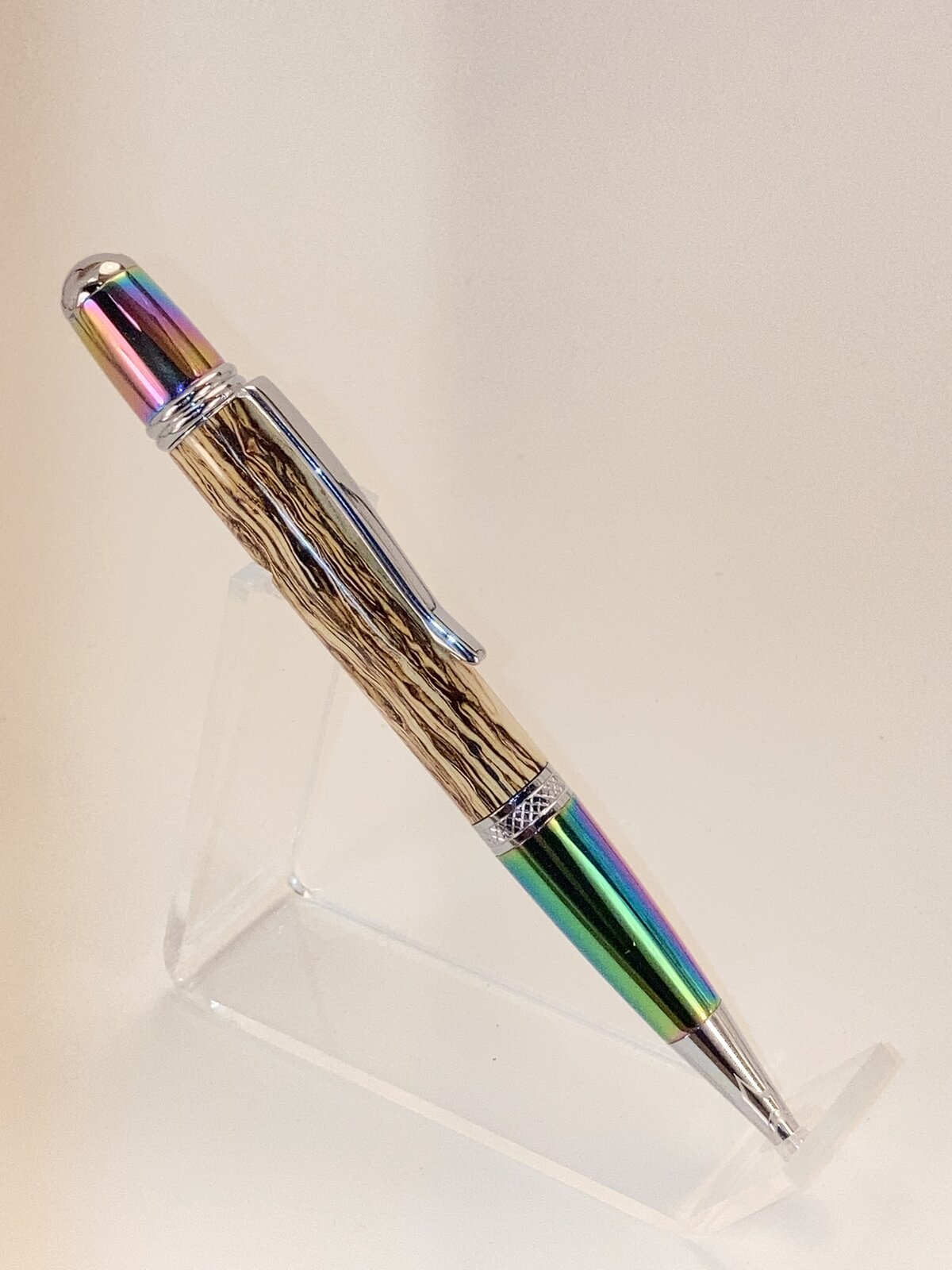

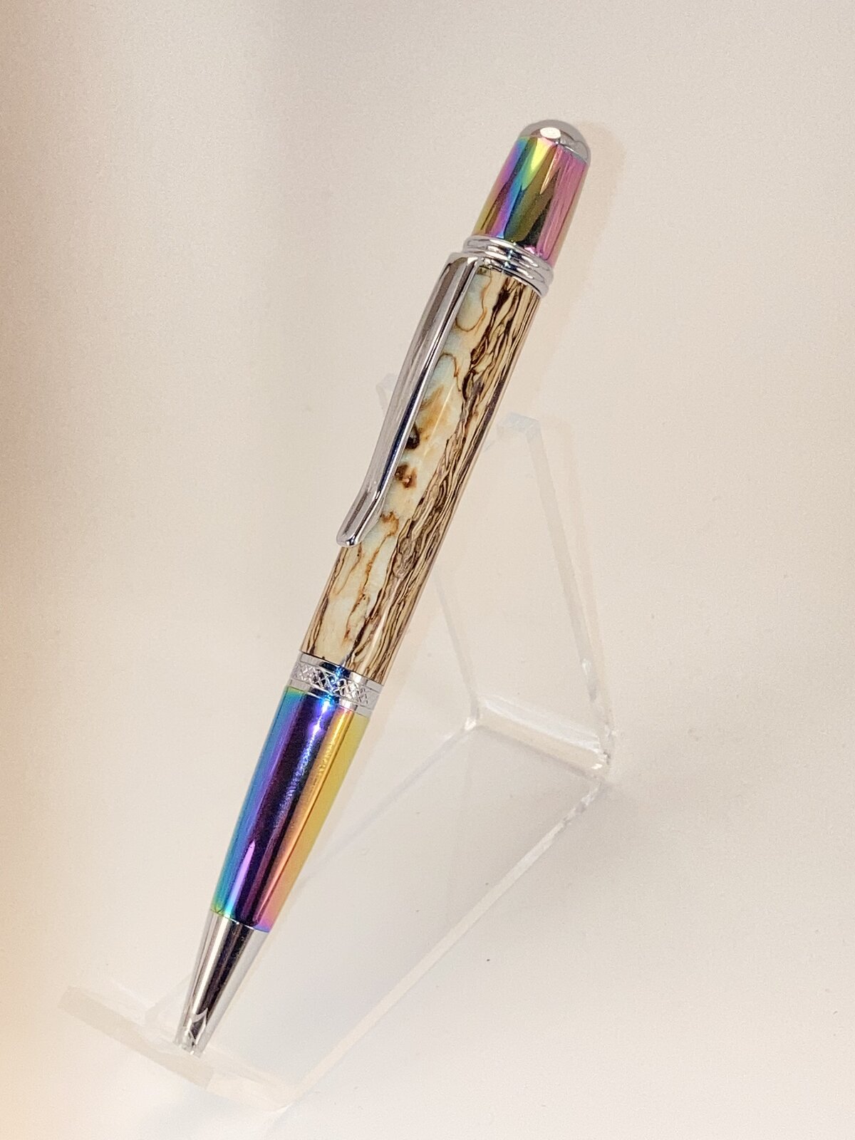

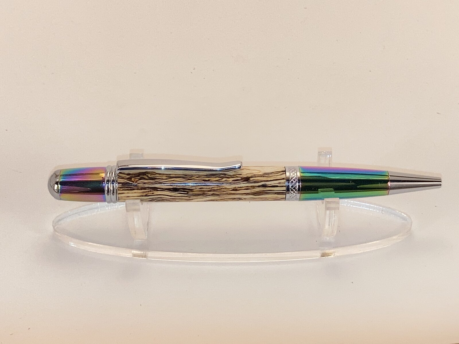

This is my first attempt at using hempwood. I have been seeing the beautiful pens posted here and had to try one for myself. Taking note of some of the struggles others have had. I rounded the blank on my disk sander before starting. Rotated to a fresh side on my carbide cutter. I proceeded by taking light cuts and stopping every mm or so to soak it in ca.
While a bit tricky to turn it is a beautiful material and I wouldn't hesitate to buy more of it.

Thank you Alan. I would rate it similar to pens that I have made with unstabelized burls and spalted woods.
Looks really good. I have a less than 50% success rate with hempwood.
Your posts and a few others are why I took the precautions I did. No doubt I would have blown it out with my normal aggressive turning, and why I did a single tube pen (so I had a back up.) Even still it seemed very fibrous almost fuzzy at times which is why I soaked it in ca.
If I were to try it again, I would definitely flood it with CA. Even then, I had such large chip outs, I'm not sure how much it would help.

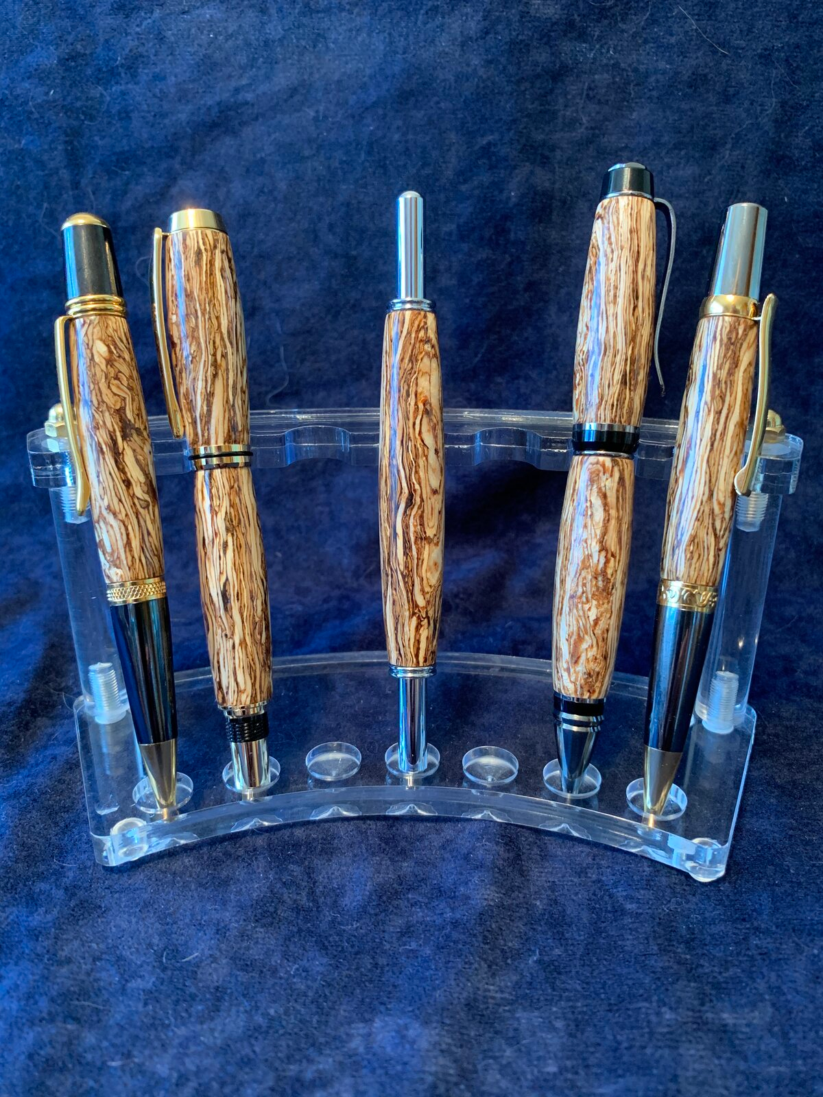

A very nice looking pen. I like the way the wood complements the colors of the pen kit.
For those who remember my post, I like the look of Hempwood. I had bought the Hempwood directly from the manufacturer, since Exotic Blanks was not offering Hempwood blanks at the time.
I have not experienced many of the issues I have heard about and read about. I must be lucky.
I round the blanks and mount them in a collect chuck for drilling. I go slow on drilling. I use Gorilla Clear to glue the tube in. I soak the blank with super-fast/thin CA after the tube is glued in. I turn with a skew. I also soak the blank with super-fast/thin CA before sanding, and finish with CA.
