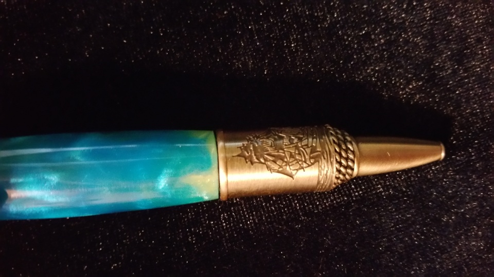

I made a beautiful Nautical (PSI) pen but there is a gap between the tip and the blank. I tried to take the pen apart but I am unable to punch it due to the internal mechanism that was pressed inside the cap. Any suggestions? Here's a pic....

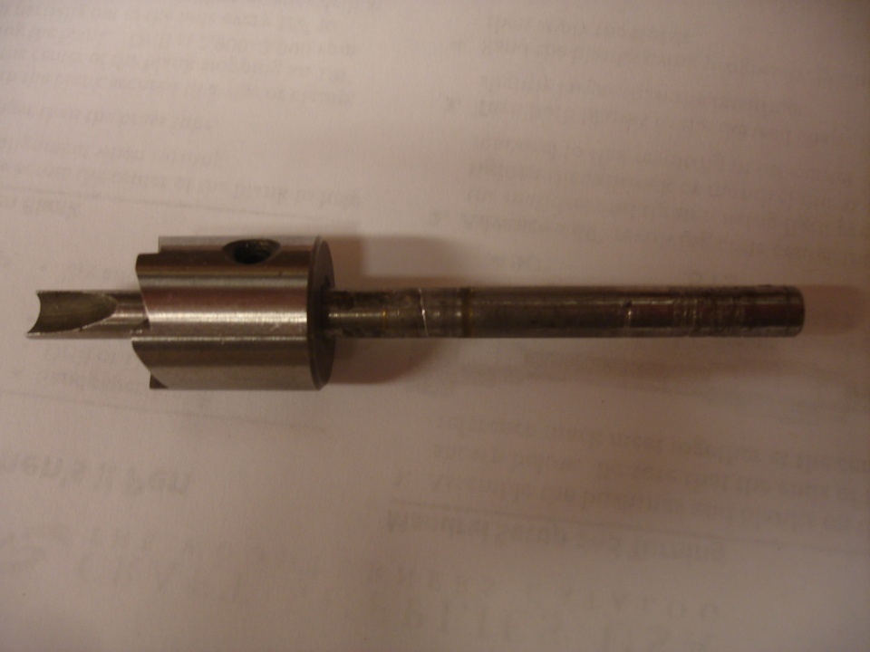

Keep it for yourself or put it by your phone. I have a cup with pens in, by the phone , cause it never fails that I need one for certain calls.
Either the blank or kit is not square in relation to the center axis of the blank or perpendicular...your choice. As a "Professional" pen turner, these things should have been addressed prior to assembly. Buy another and try again.

If you can remove the tip mark the edge that needs trimming,remove the tip and hand file or sand until you get a fit. Be gentle take it slow it can be done.

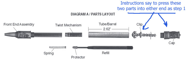

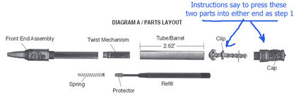

I studied the instructions and, correct me if this is wrong, the twist function is between the main barrel and the pen tip assembly. In other words, the area you are seeing the gap is where the 2 sections rotate. Is that correct?
That is the way the instructions read and it looks like you would unscrew the main pen body from the tip assembly when you need to change the refill.
As pictured below, I see no way for the cap assembly to be the only part that turns the twist mechanism. If that is the case then the main pen body should unscrew from the tip by unscrewing the threaded twist mechanism. And, if that is the case, you may then be able to drive the tip assembly off and redo the blank.

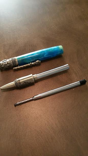

I can easily take the nib assembly off no problem. Inside where the cap and clip are is a other mechanism that inserted in that position when I first assembled the pen. If I punch the cap assembly off from the inside the I will damage it and the pen won't function I will send pics shortly.
Thank you :)
This is the problem....
The twist mechanism is inside the cap! Here is a picuture. First is all three pieces that I have taken apart. My mission today is to get the cap off without damaging the twist mechanism inside the cap. Maybe it doesn't belong there but that is where it decided to take up space lol.

When you assembled the pen, after pressing on the cap and clip, did you screw the transmission onto the front end assembly before installing? It looks like from the instructions, like the others were saying, that the whole front assembly with the transmission should pull out unless the transmission came unscrewed.

Yes, thats what it looks like. The transmission came unscrewed in the tube. I don't know if you can find a long bolt with the same threads that you could screw into the transmission to pull it out. Next time you might want to us lock tight on those threads.

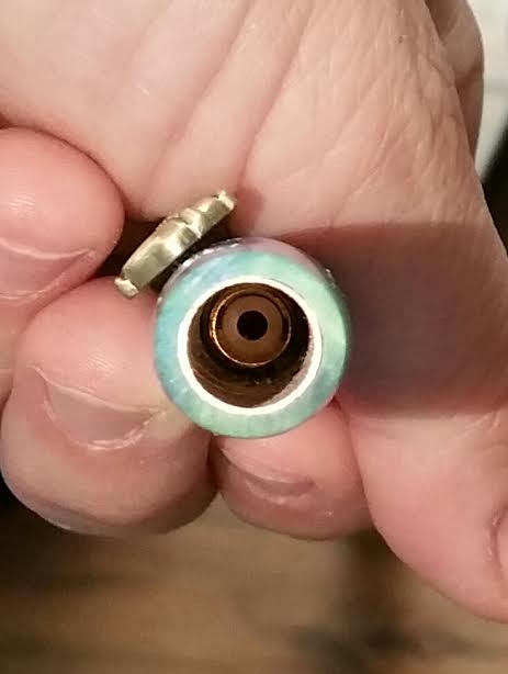

Can you screw the nib end back on to the transmission? Or has the transmission slipped too far into the cap?
I did it! I got it apart without damage! Next question is this....
If I barrel trim to 'round' the edge that was off, won't that make it too short for the components and show a gap anyway? If so, I can just remake the tube but would rather spend that time doing more productive things :)
Michelle try putting a generous chamfer on the inside of your tube and see how it fits before you trim the end. If the tube ID edge is too sharp it wont go all the way on if the metal parts have a radius. I had a wall st II from wood craft which had this problem. Also you may want to use the barrel trimmer head backwards with sand paper glued to the flat side which is alot more gentle than the cutting teeth.
