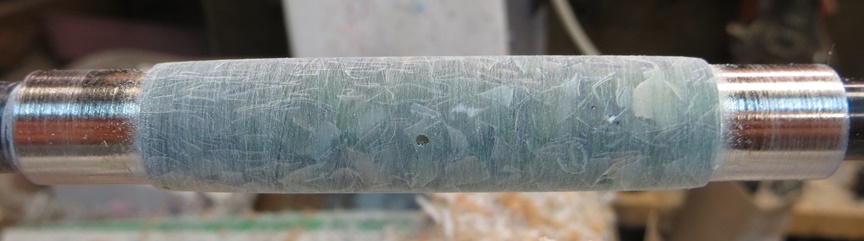

Hello, I'm a newbie still and trying to figure what I'm doing wrong here...
I have an acrylic blank I turned down and then went through all the micro mesh, but still showed scratches...so I tried sanding from 150-600 then again with the micro mesh...still didn't look good. So I did a light turn with my scraper to get blank back to after a fresh turn and tried micro mesh sequence again...even uglier!
What am I doing wrong?
Ever other arcrylic I have done..about 25 has turned out great, maybe a few small hardly noticeable type of scratches, but not bad....but this blank is an upgrade....paid $10 for, so it's my first expensive blank, but can't figure why I'm getting scratches.

I would try turning your lathe off and hand sanding lengthwise. 220 and 900-1200 should do it. Anything after that is just polishing it in my book. You can remove fine scratches and polish with other products on the market made for plastics. Another way to remove these scratches is to use a fine metal file while turning your blank by hand. On the other hand, some plastics stay somewhat soft and are hard to sand, or have soft pockets in them from not curing or being mixed well enough. Jim S
They look like deep scratches from the rougher grits.
There are many ways to skin a cat. You are probably going to get a lot of suggested techniques.
I sand down to 320, stop the lathe and hand sand lengthwise. I always have magnifying glasses on and make sure I get all the radial scratches out.
Then I switch to micromesh. Wet. For the first 5 or six grits, I stop the lathe and again hand sand lengthwise.
Micro mesh wet....
But second time when I tried to do another way it was dry then micro mesh wet
And I do sand lengthwise inbetween grits 150-320 when I do 150-600
Are the scratches going around the blank or are they lengthwise ? (Oh, I see they are going around the blank).
I think you should be doing your sanding with the lathe off, rotating the spindle by hand as you SAND LENGTHWISE.
Starting with 150 grit is probably a bit too coarse in my opinion. I would start at 220 grit and work up to 1000 or higher, even up to 2000 paper.
Wet sand for the grits 600 and above and wet sand with the micromesh.
Finish off with a plastic polish like Novus 3 and follow that with Novus 2. . (there are other polishes for plastic).
lots of whys and hows.
Are you using sandpaper for wood or for paint finishes like automotive finishing.
Cheap sandpaper can be problematic for consistency.
Plastic resin dust can ball up and melt together and stick to your sandpaper causing more scratches than it cures. I usually start at 320 and go up. sand with lathe on lightly then with lathe off and sand length wise around the blank. If I have scratches that the 32o doesnt remove I drop down to 220.
You could have a bad blank thats exceptionally soft or uncured fully, but more than likely you have bad piece of sandpaper some where. Those scratches are large enough that the finer micro mesh grades are only going to make polished scratches they are too big.
Wipe off the blank with a dry paper towel between MM pads to remove any residual grit that may have sluffed off the pads of be left over from the sandpaper. Before you try again clean off your MM pads with warm soapy water and use your fingertips to scrub them a little, nothing else. Then try again. If that does not fix it I am lost.
How much pressure do you put on the sand paper and micro mesh?
And slowest lathe speed is best always?
I don't use a lot of pressure when sanding. In fact I'm careful to make sure and use light pressure. I know that's subjective, but try using less pressure. And I sand at about 1200. What kind of blank is that. If it's alumilite, it will be harder to polish than PR. But I agree that the scratches that is shows are too deep for MM.

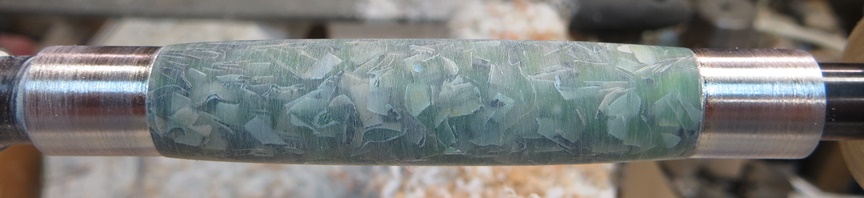

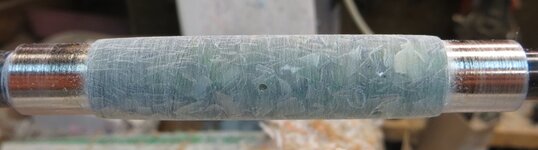

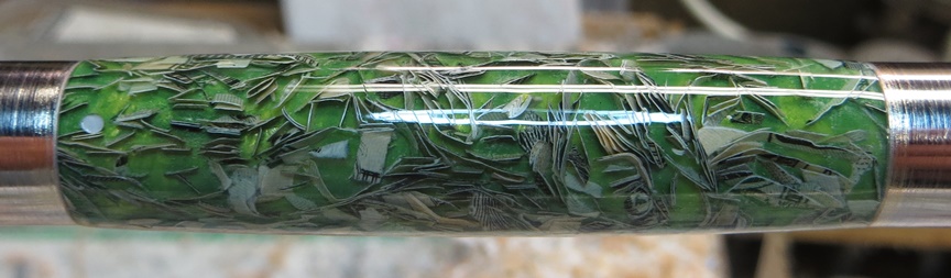

I've never ever had scratches like that, even when starting with 150 dry. I'm at a loss, but if I had to guess, I'd say you're building up too much friction and something on the sandpaper is melting the scratches into the blank. In the photos below, the first two are after sanding with 150 dry. The last are after the 9 grades of Micro Mesh wet, then Meguiar's PlastX plastic polish. The blank is inlace acrylester. And I sand at 2000 rpm.

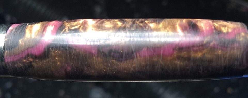

I had this exact same problem. I bought those little micromesh type pads from rockler that go all the way up to 12000 grit. what I did to fix the issue i used sand paper up to 600 grit then wet sanding with the little pads I would use each pad with the lathe on, I would then wipe the blank dry and remove the little dust, I would then rewet my pad and with the lathe off I hand turn the lathe while sanding length wise. once I get through the 12000 pad i have one of those HUT polish sticks. Now I am no expert farely new to pen turning actually but this worked really well for me. I hope this help.
