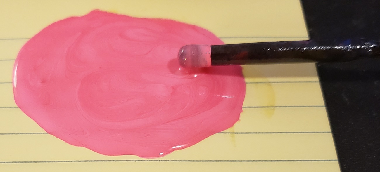

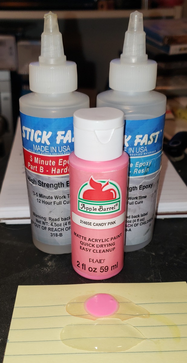

To avoid controversy I'm not saying this is the best, ok or mediocre way to do it. It's the way I do it and I have no issues with it casting. If I'm gluing acrylic blanks then I'm more in line with some of the others. First off the only paint I use is the water based acrylic sold at Michaels or Hobby Lobby. It's cheap and comes in more colors than you could ask for. With most of the things I cast I'm trying to change the tint of something or enhance the color. When it's dry it's cured. In can set up a tube in the morning and cast it the next day. Same paint for back painting blanks. The issue is letting the glue set. I use CA and Epoxy for wood but only epoxy for acrylics. I let the epoxy set overnight before turning.

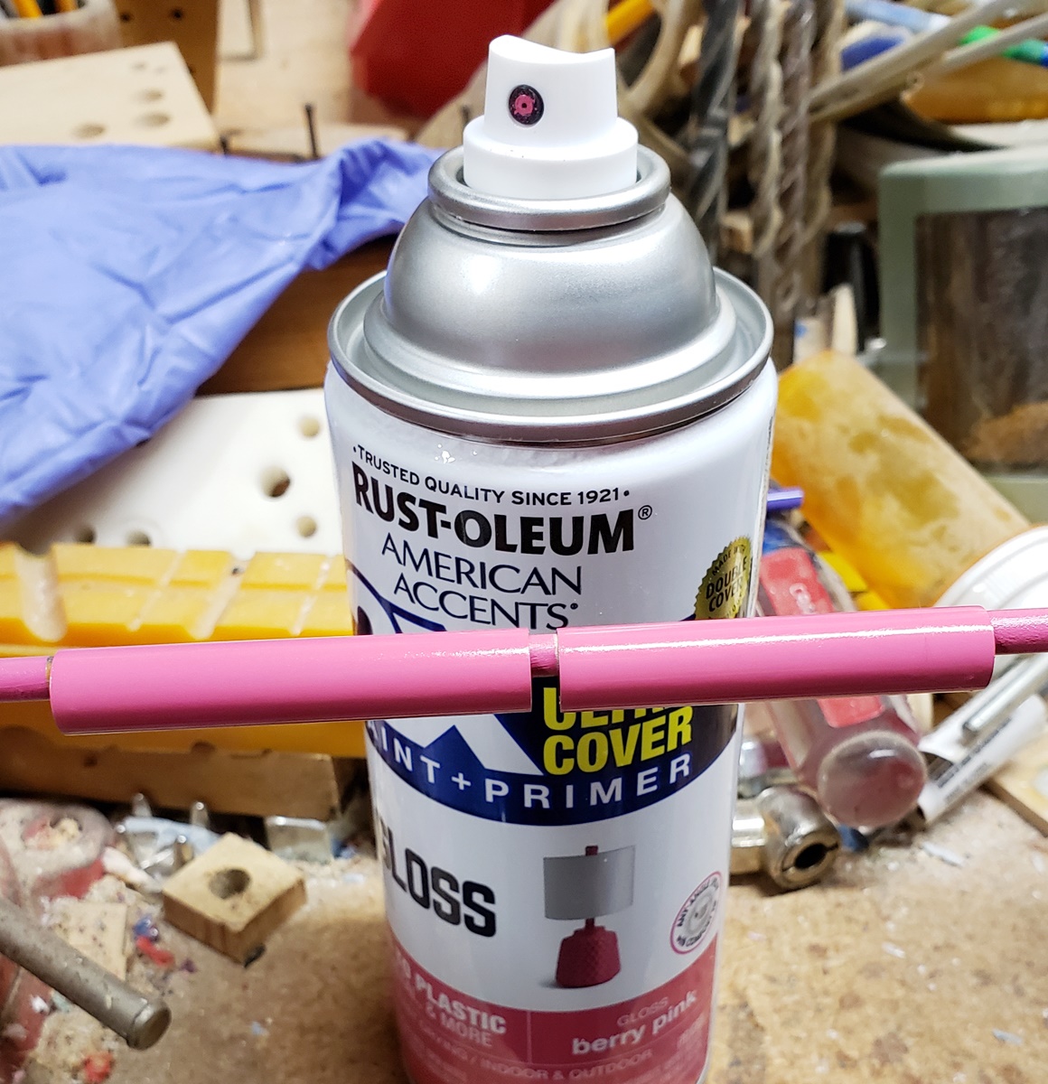

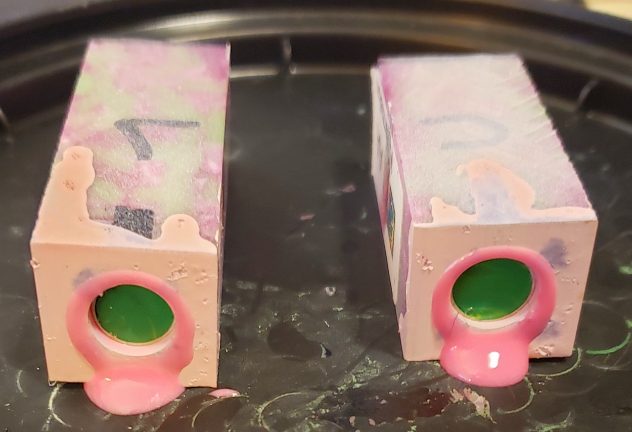

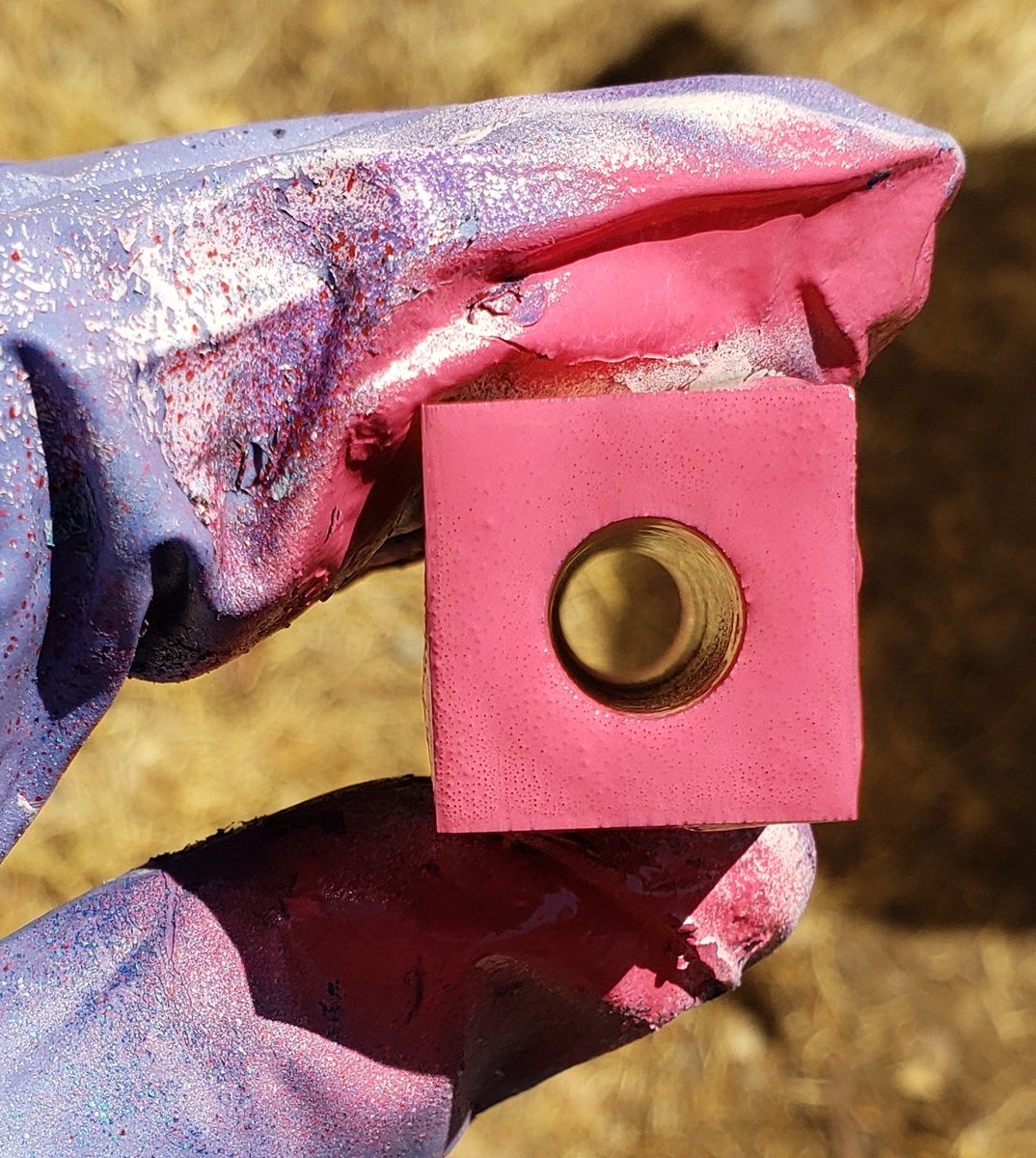

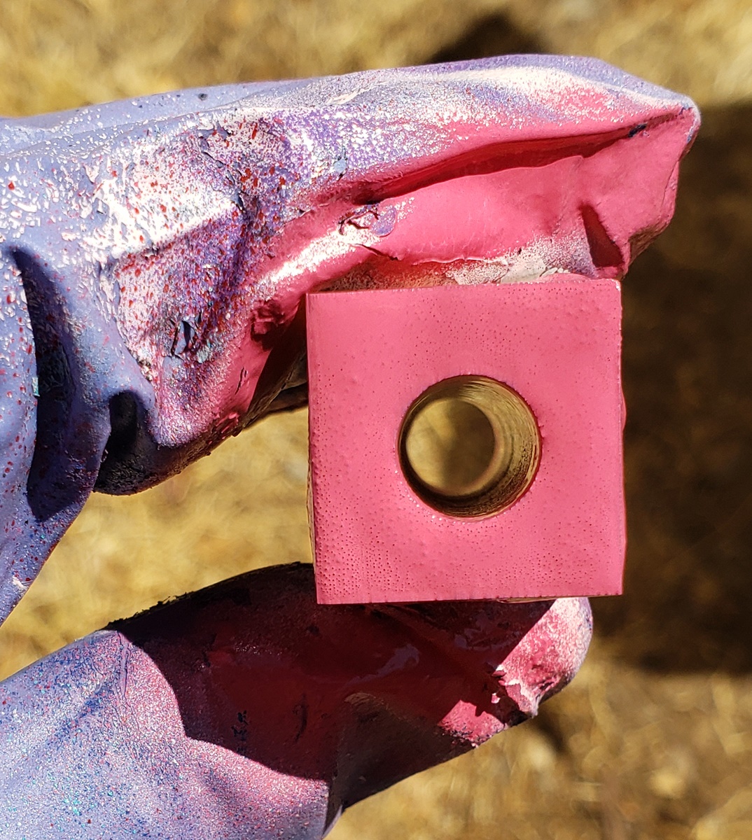

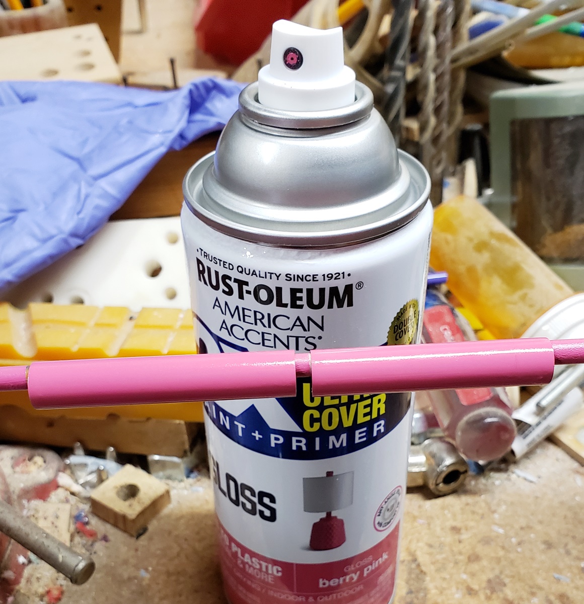

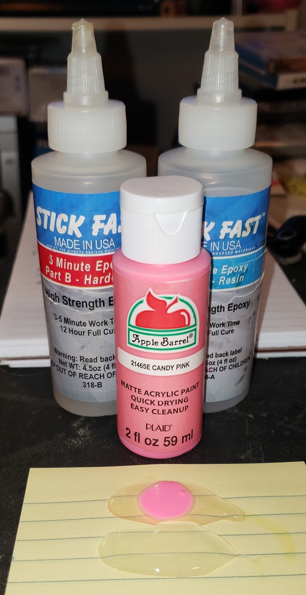

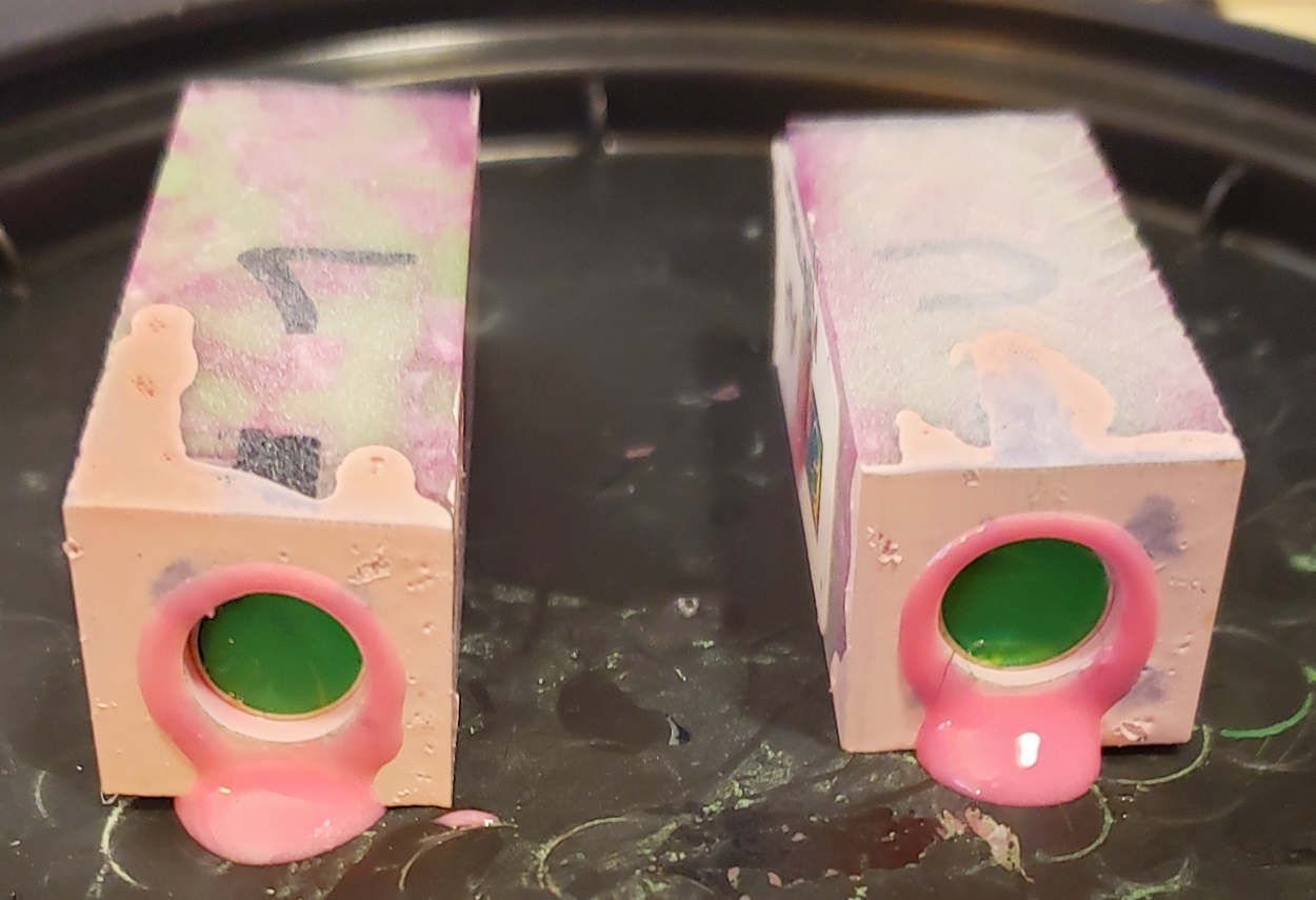

I use Rustoleum 2X spray paint for both the blanks and tubes. It usually takes a few hours to dry, depending on the weather. Overnight is generally safe. For coloring epoxy, which I always do if I'm painting the blanks and tubes, I use artists' acrylic paint. It mixes well with epoxy (all I use), but can make it take longer to set.
I prefer to paint the tube with testors spray paint, paint the inside of the tube with testors enamel and tint the glue. I've gone to using the gorilla clear, or jbweld 2 part clear epoxy. I tint with either alumilite dyes or mica powder. I vary the colors a bit, I think you can get a deeper 3-d look with a little variation in color.

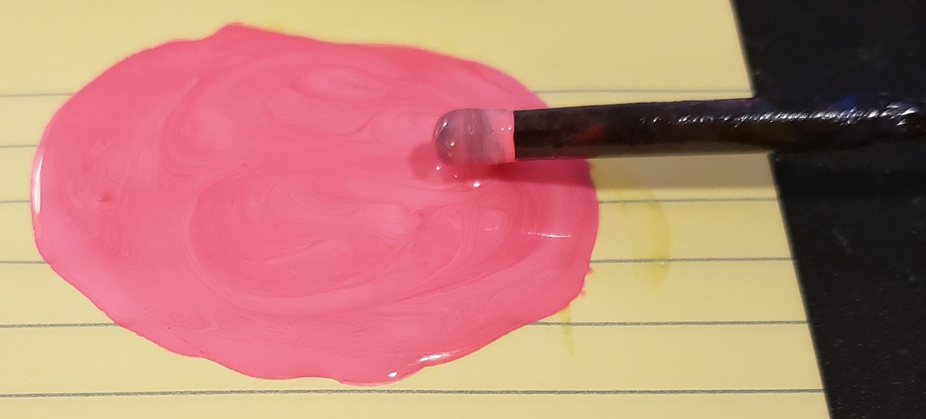

Since I am also a model railroader, I usually have a lot of paint in my railroad room. I typically use either Testor's Model Paint or PolyScale Water Base Model Train paint; apply with a Q-Tip, let dry, undisturbed 24 hours. Using a Q-Tip there is no messy clean-up of overspray or brushes.

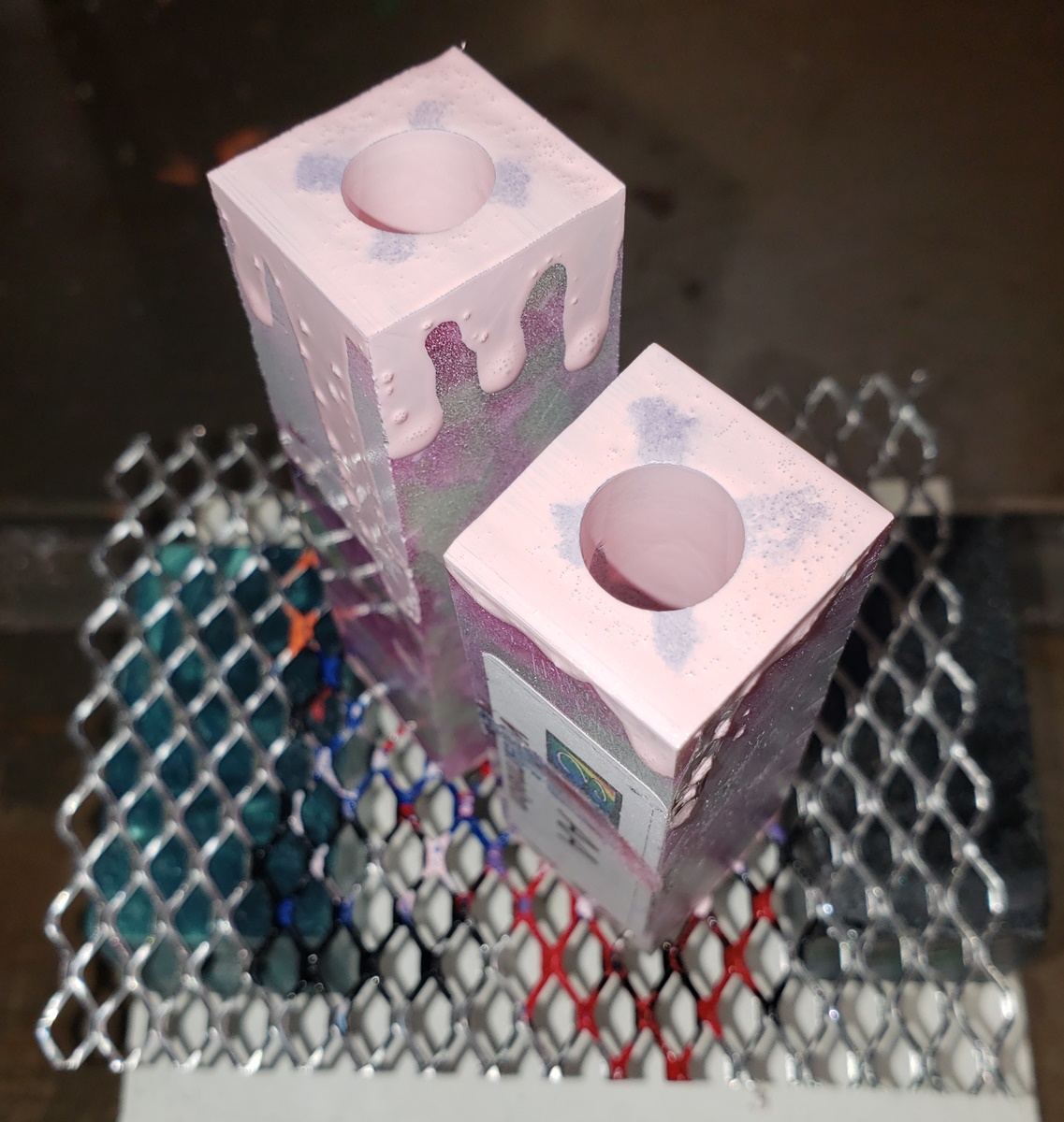

Another tip helps regardless of the paint you use. Immediately after painting, mount the blank in your lathe and spin at max RPM. It will smooth out the paint leaving a smooth consistent coating. Thick spots will many times get scraped by the tube. Remember the tube will be glued to the paint not the blank, so what you use for paint and letting it cure matters.

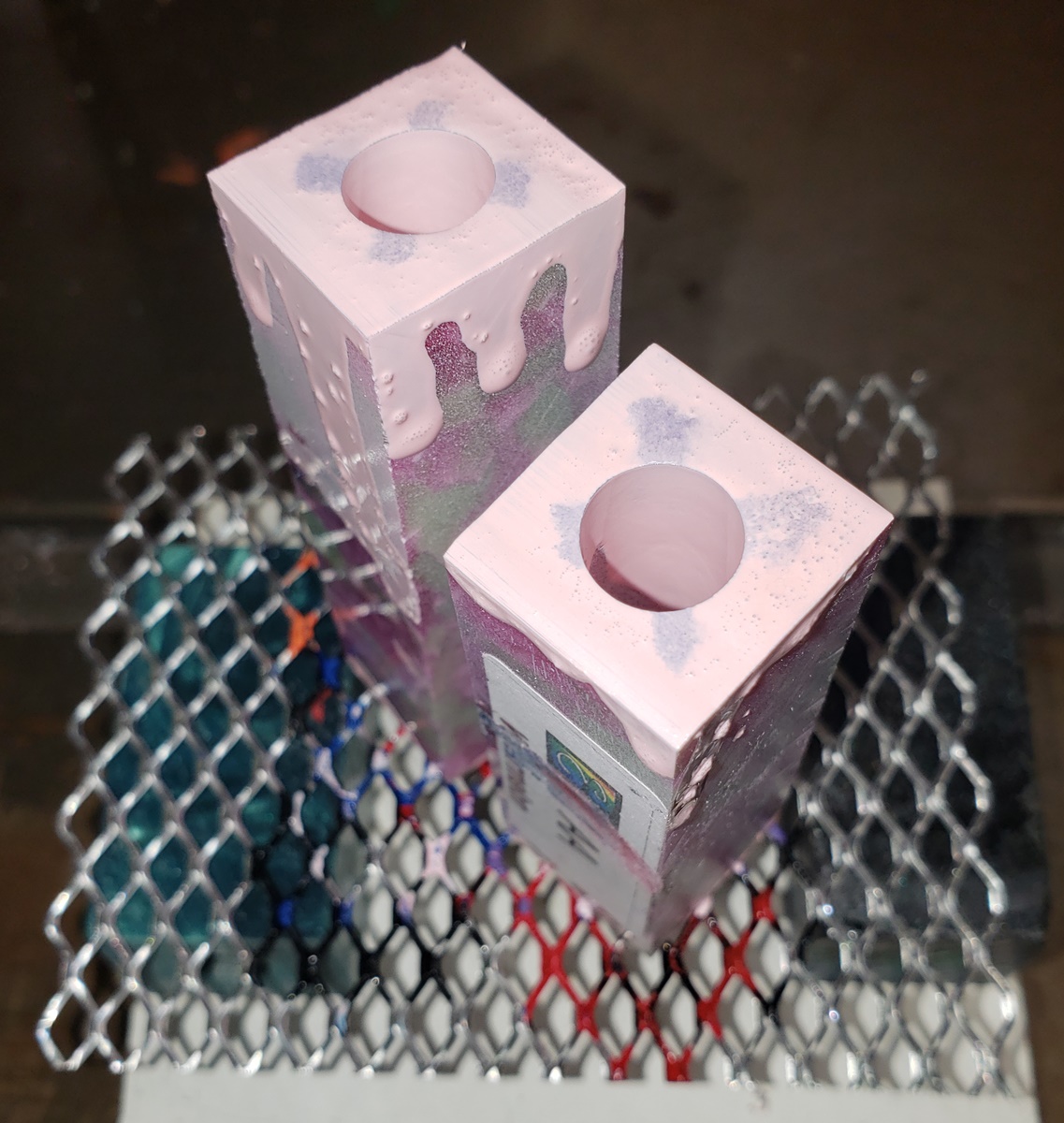

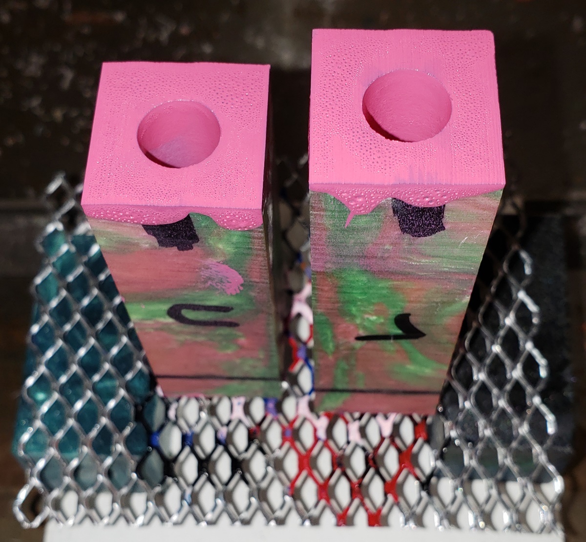

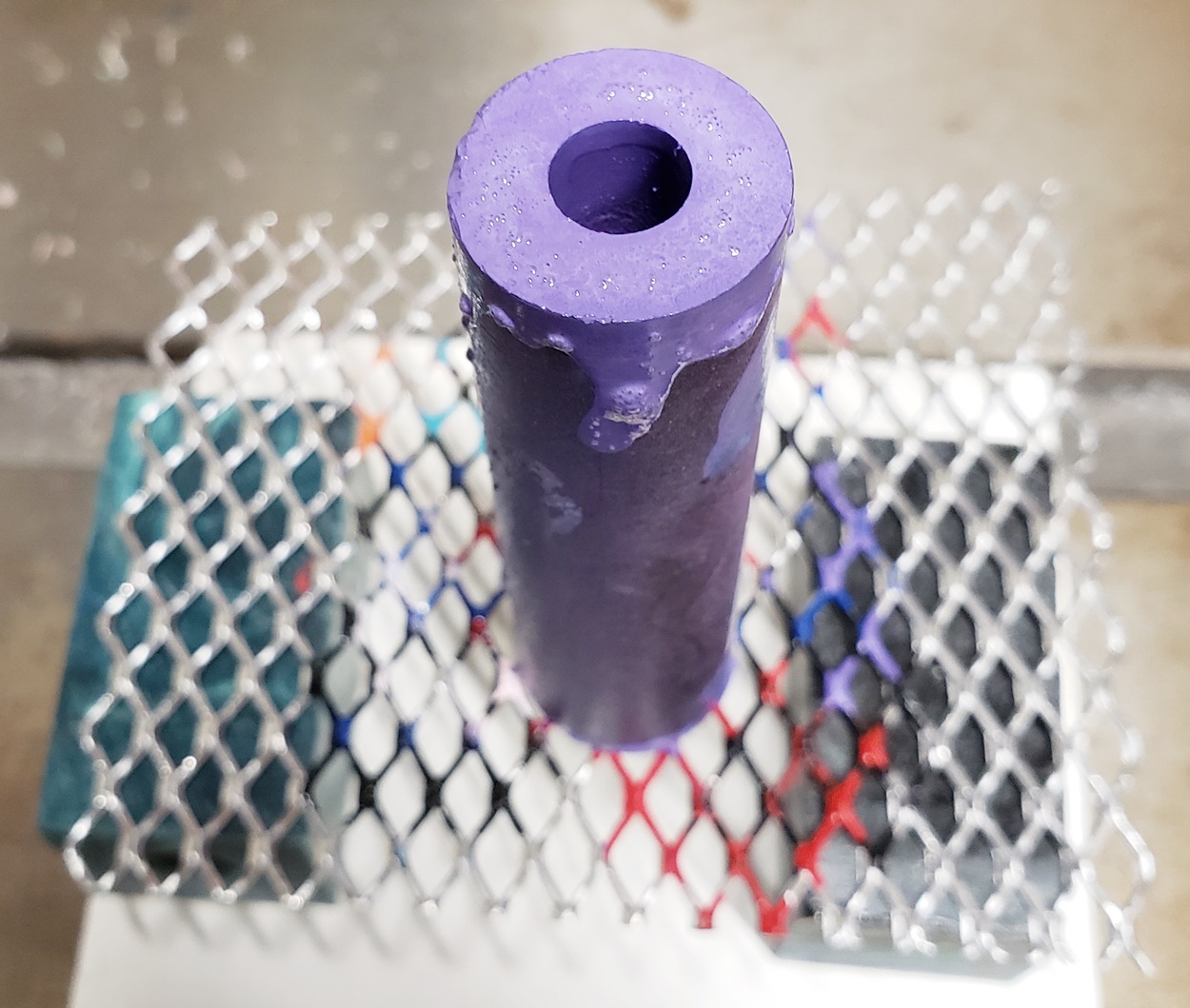

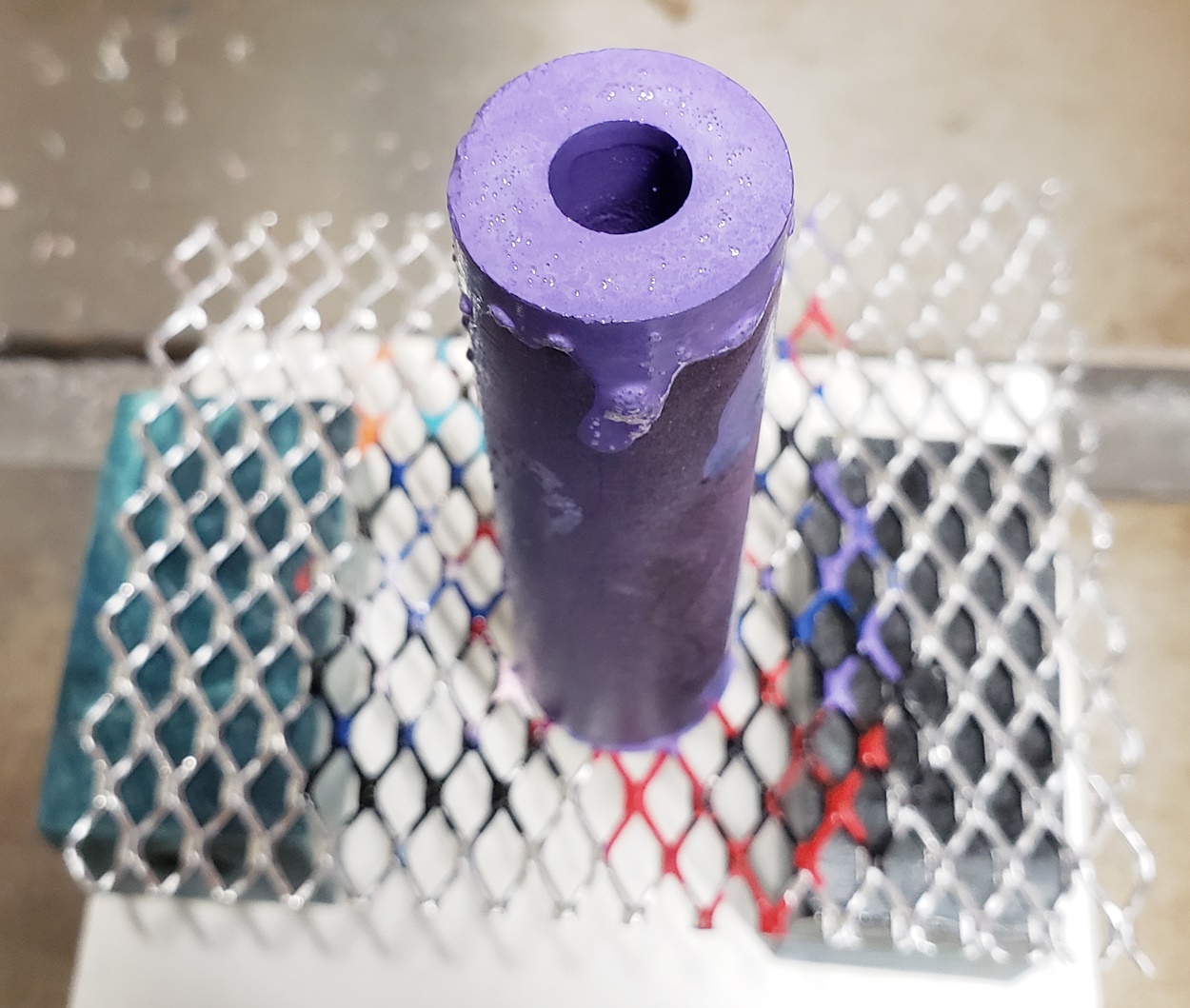

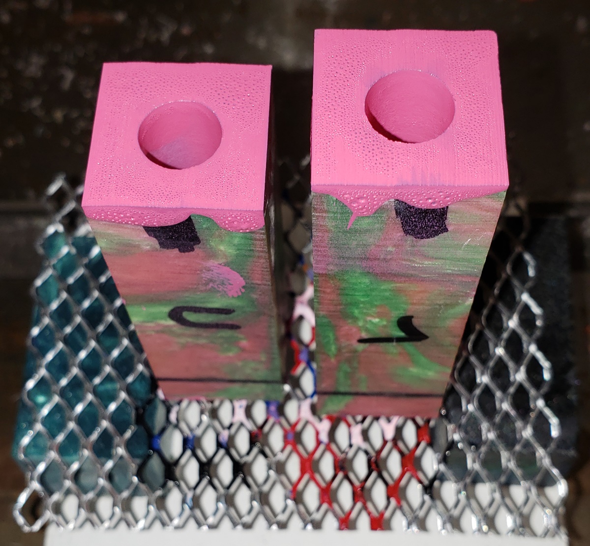

I stand the blanks on end immediately after spray painting them. This seems to let the paint smooth itself out. I stand them on a piece of aluminum mesh, so air can get in the bottom, too.
