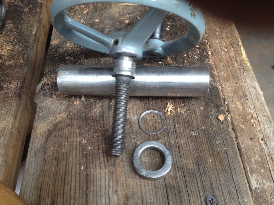

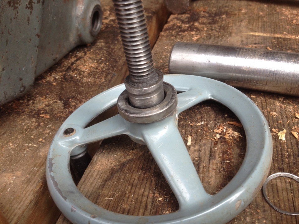

I have a Delta 46-541 wood lathe, and today I was drilling with the tailstock into some apricot wood when the drill would not advance instead the screw was coming out the back side. I took the tailstock apart and noticed there appears to be a groove in the screw that would hold the screw in place.
The pictures show all the pieces that came out. The ring in the first picture fits next to the handle on the screw and fits into the groove in picture 3.
I goggled parts for this lathe and the pictures are so small I could not figure out what held the ring in place. To replace the screw was $85 plus.
Sorry I don't know the correct terminology for the parts so this might be confussing.
Can anyone help me? Thank you William

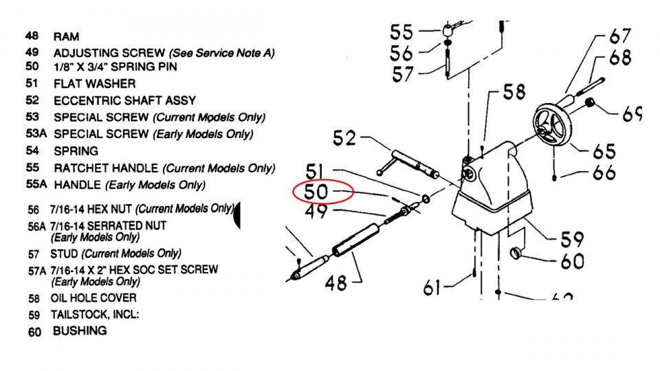

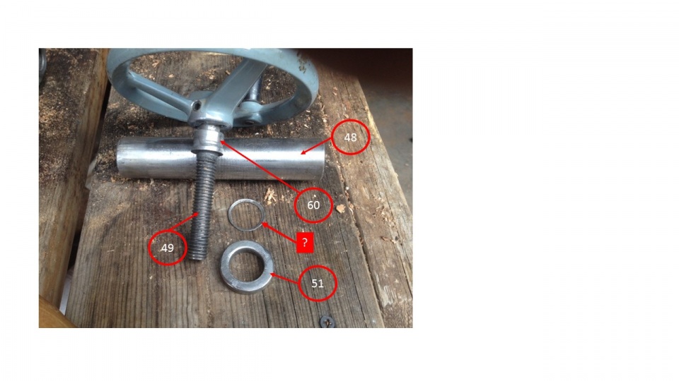

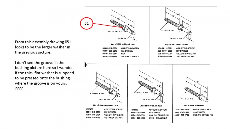

According to the exploded print and Parts List, there is no bearing in this tailstock.
I have attached some pictures from your picture and the assembly page from on line. I also annotated a few things.
I hope this helps.
Without being there and seeing the parts as you took them apart is difficult to piece back together since I dont see all the parts in your pictures that are described in the assembly drawing.

Looking at the diagrams that flat washer #51 is probably the ragged out sliver of a ring in the picture and is supposed to be pinned behind a roll pin which is not seen in the picture and has probably disintegrated. That would be what keeps the handle and lead screw in place in the tailstock frame. This is something you could probably fudge up from the junkbox if you can find the hole the roll pin was in and clean it out, find a suitable replacement pin and washer, and knock it back together.
